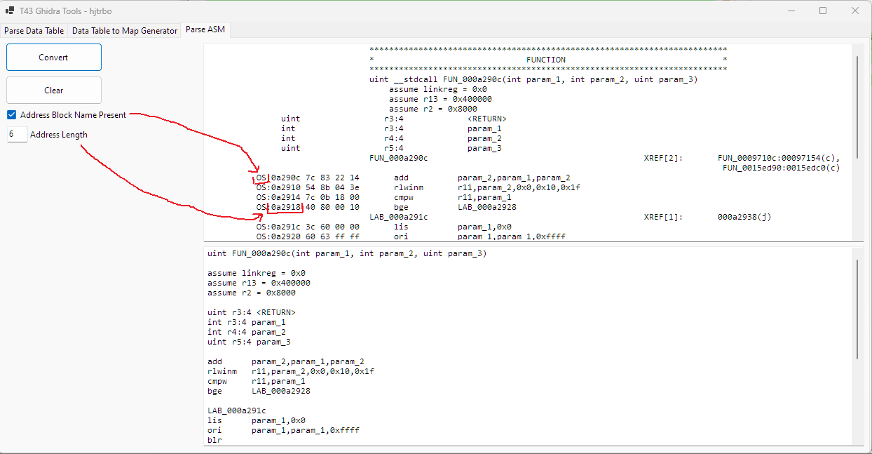

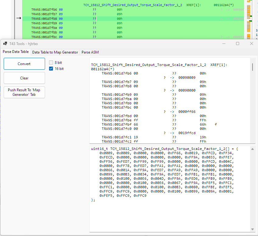

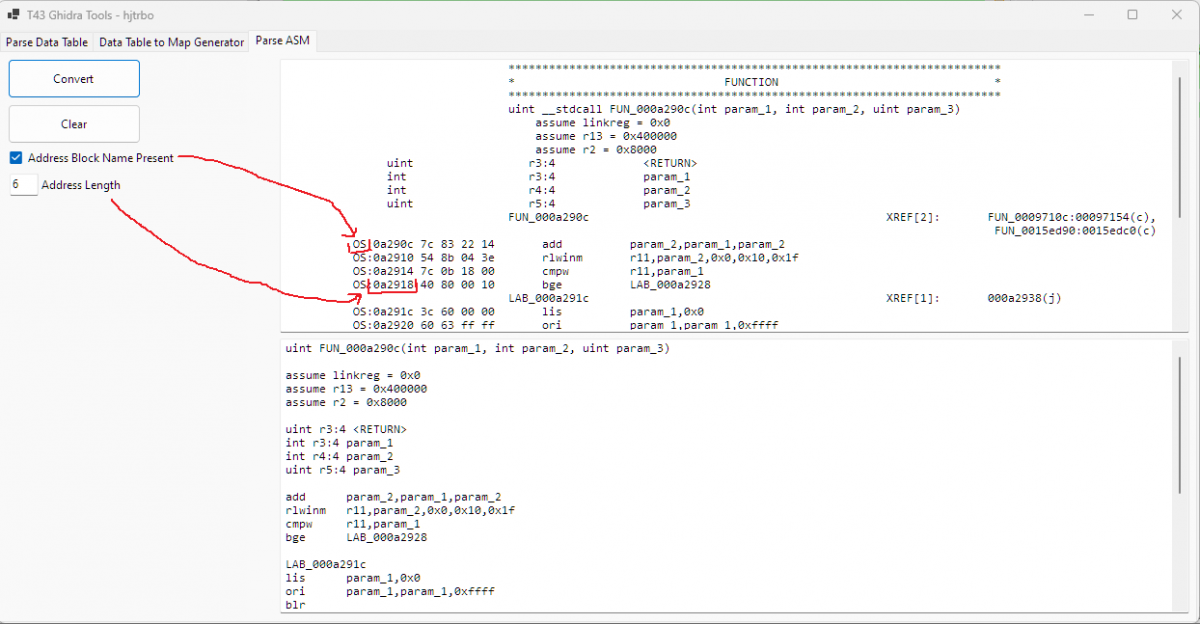

I built this handy little utility to help me. It speeds up analysis considerably. Pictures describe usage.
As is the case when one builds there own tools, the usual quirks and bugs apply. If anyone wants to improve on it, knock yourselves out. Send me back what you've done.
Parse data table out to array Convert hex array into a scaled table. 1D and 2D supported. Auto detect of table size by GM length bytes supported Parse out an assembly function to minimal text to simplify analysis
