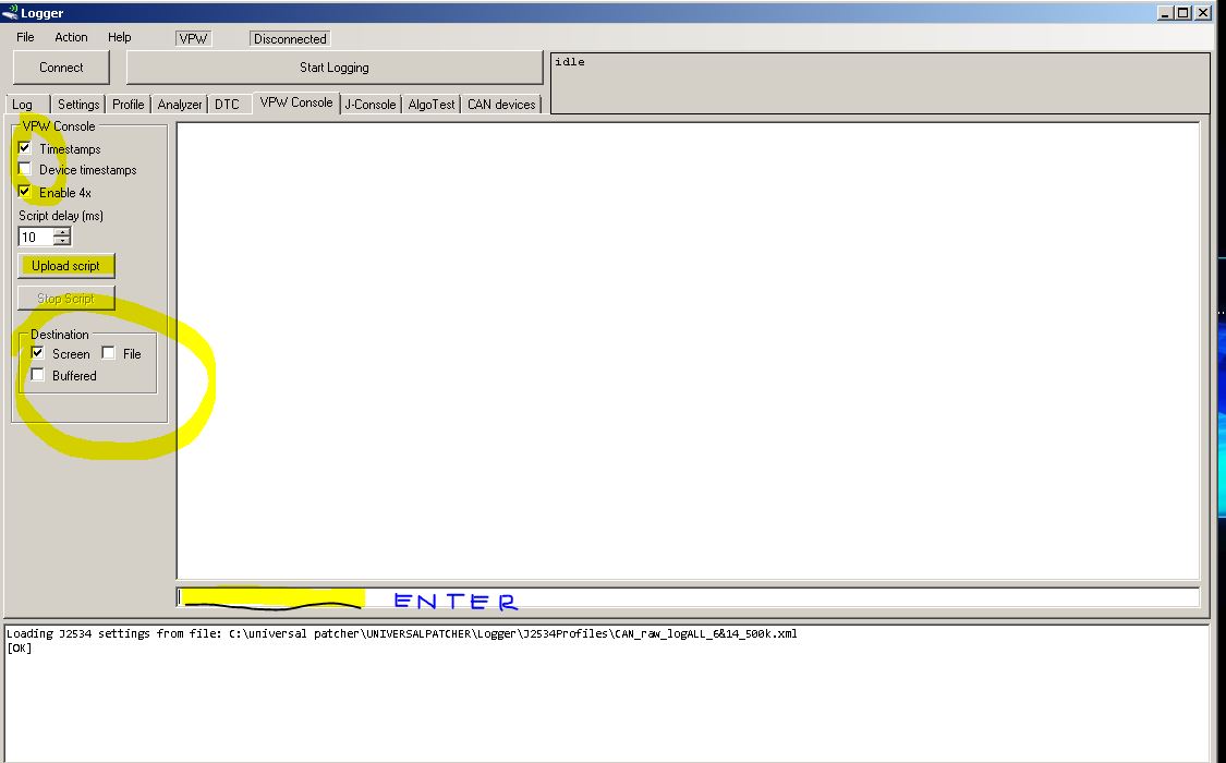

What software do I use to run that script? What’s it supposed to do? Isn’t 3c for segment numbers etc? Doesn’t dps essentially do this check on modules? Not much comes up with dps for the cluster
Re: 2004 to 2012 Colorado and 2006 -10 h3 cluster programming

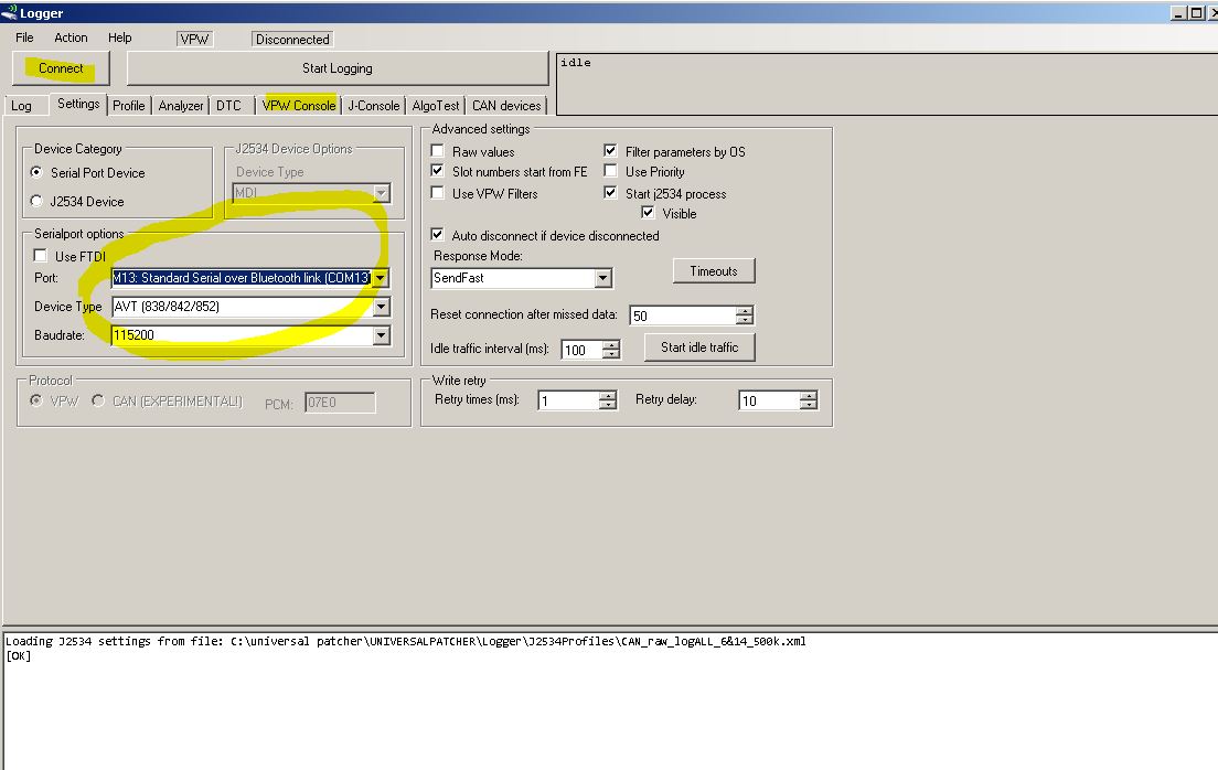

It will read all submodes of 2a mode out of module. There is much more than segment numbers.
- logger_script.JPG (74.65 KiB) Viewed 4791 times
- logger_connect.JPG (93.22 KiB) Viewed 4791 times
I can never get Universal patcher to work, most confusing thing ever... lol
I do not know were to load the script? Nothing seems to happen
Ok I uploaded the script in vpw console seems to be working but I don't see any response from the cluster.. were is that stored?
