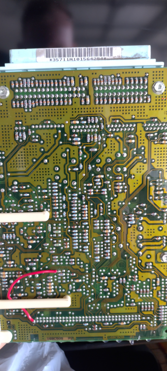

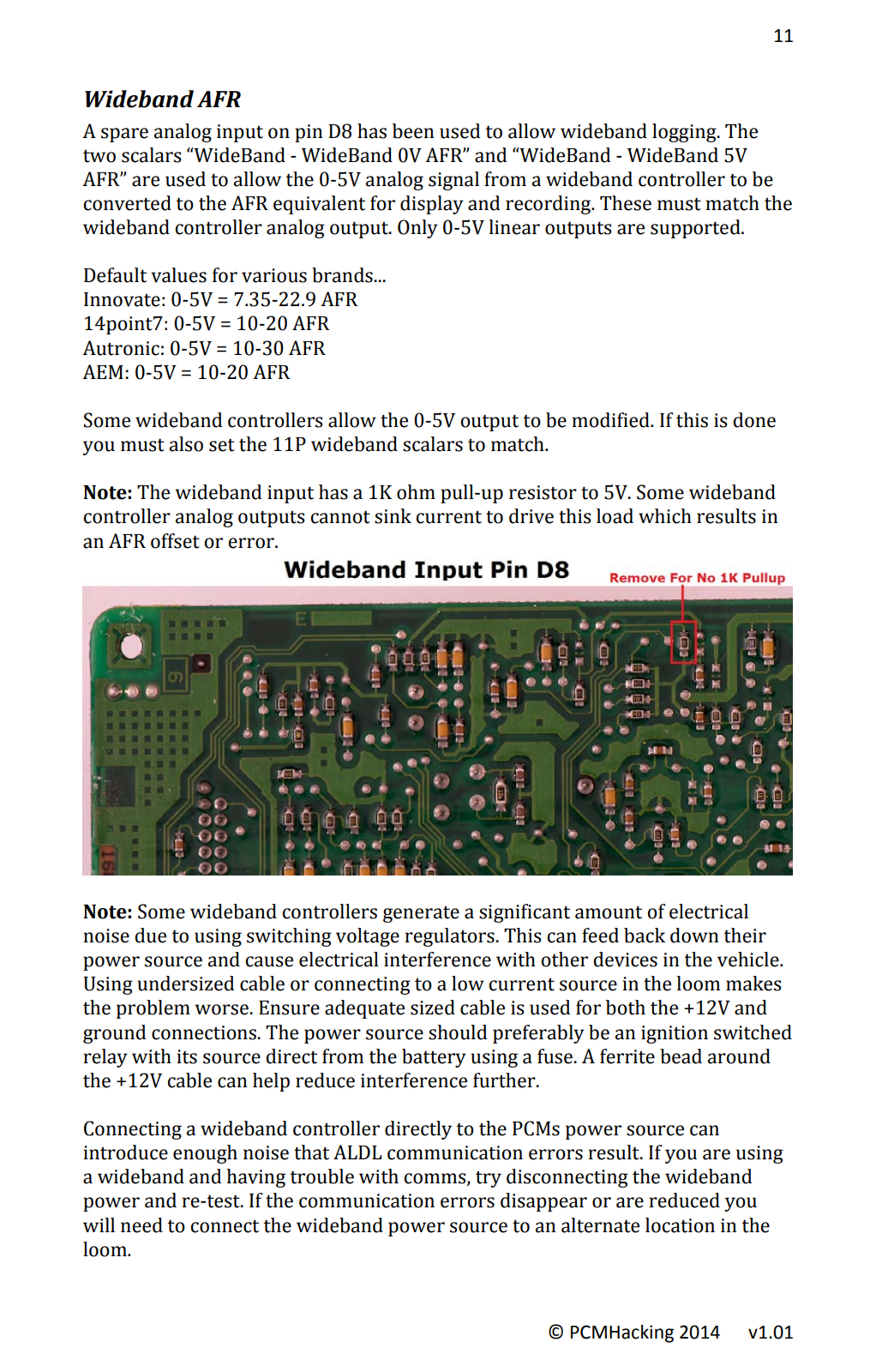

Just digging this one up again. I ended up buying the Spartan 3 wideband and getting a mate to weld another o2 bug in on Wednesday. Just in preparation i pulled my ECU apart and tried to locate the pull up resistor (if or when i need to launch it), but the board on the FAQ looks different to mine (424 auto). Just wondering if you remember Jaso74 which one you took out?
One from the thread
My 424 auto board
One from the thread
My 424 auto board

- Posts: 10111
Re: wideband- needs pull up resistor removed ?
That does not look right to me. From the OSE11P PDF (in the zip file with bin/xdf/adx) its this 1k resistor.
- Posts: 10111
I think that other picture - and I could be wrong - might be part or the whole modification to change the VSS input so that it can read a T5 manual? I am sure its not wideband and removing it might break auto VSS or something else.
Edit T5 change is here, so its not that. I cant figure out where the first picture came from. viewtopic.php?p=15740#p15740
RalphusGalkinsmelter
- Posts: 17
- Joined: Tue Mar 19, 2024 5:52 am
- cars: 1992 Ln106 running a 5L 304
2013 Amarok - Location: Brisbane
Im a flog mate, i was looking at one for 12P on this thread
viewtopic.php?f=27&t=356&p=47237#p47237
What a helmet
What a helmet
