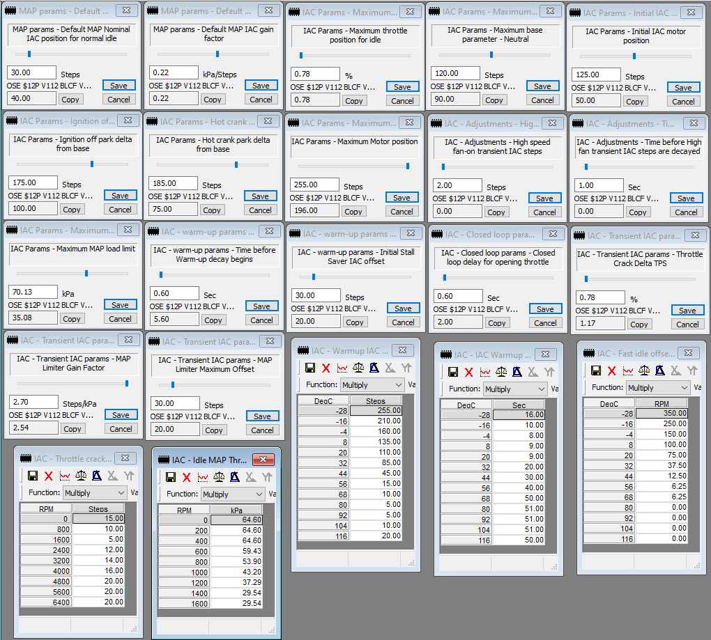

Given the number of steps you're seeing it seems unlikely that there is a physical issue, you just need to tune it not to open so far. As long as the pintle seats correctly and it has a fairly consistent/incremental rate of opening then the overall hole size doesn't matter (other than noise).
There are a lot of IAC settings that can help when using a bigger cam (the image is $12P but I imagine there are similar in $11P). In particular the maximum MAP load limit scalar and idle MAP threshold table can make a big difference as to which idle mode it uses - this engine idled at ~65-70kPa and the idle would run away with factory settings. There's a thread around here somewhere that explains how this works in some more detail.

Just for reference if anyone else has similar issues.
The Maximum MAP load limit and Idle Map Threshold tables seemed to fix it, it was set to around 40kpa and my engine was idling as I was playing with it at around 75kpa so no wonder it was struggling.
Seems a lot more stable now.
