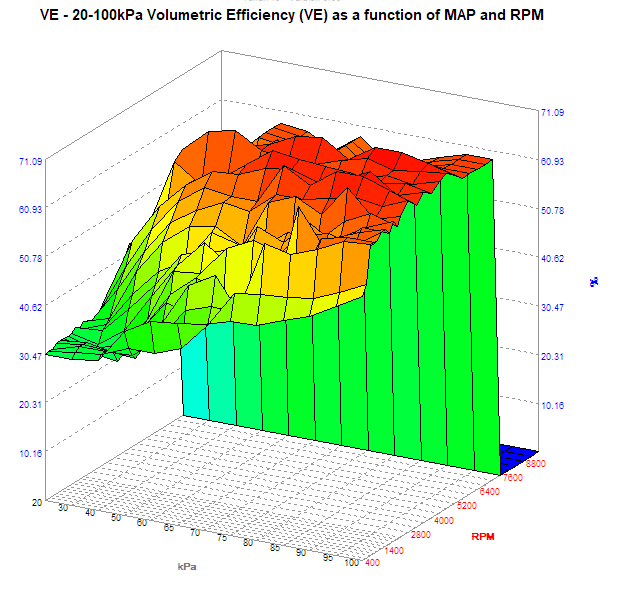

Yes the pros and cons of supercharger vs turbo can be indecisive subject ,but I'm leaning toward centrifugal supercharger for the constant torque ,better for towing the boat...but not looking forward to fuel bill. I've raced the GLX rangers and I get them off the mark up to 160kphr ,they start to reel me in after that ....which i dont like hitting 180 in the old girl😅...get white knuckles on the smoothest of roads. I'm running 33s with 4.3 diff gearing,,which is a bit loaded for a cammed truck ,I got 32s coming which will help.
Going back to your vr tune ,140kw at the wheels is very respectful power from such a small cam ,and the ve shows it flows well at all rpms too. Nice combo 👌
I had mine in the dyno ,started at 140kw first pull with blcd standard tune . Was knocking like hell ,so I subtracted 3 degrees overall,next pull 153kw. We got through the 90 cells then my fly wheelwheel bolts started to loosen off 😬... so had to pull the pin. I ended up drilling and taping the 8 5/16,to 3/8unf,..47ftlbs stopped it from happening again!.
So for a big cam ,I'm not pulling power like your motor ....will be back on the dyno later and play with the timing a bit more one day...or just wait till it's charged 🔥

That's my VR stock engine, only pacemakers, decent exhaust and Mace CAI. It's actually 146 hp or about 110kw. 0-100 in 7.6.
That is also the dyno and VE for it.
My VP with 140kw, about 190hp, 0-100 6.0 flat, is wavy as shit. and the VE is quite spiky as well, any decent overlap in the cam does this and it is normal. But I found I could never feel any of the waves when driving or flat out from idle to fuel cut. It's the power curve that is what makes the car go, torque alone is completely meaningless without it happening at an rpm, and as you see on any dyno plot, even with scale taken into account, torque fluctuation even large, only equal small ones in power, unless they are way up top, which isn't the case for most engines.
Good example of such is any diesel 4x4, mountains of torque, all at the low end. Puts big V8 engines to shame in the figures, yet slow as hell, because the power is low due to all the torque being so low in the rpm range. So waviness isn't a big deal for 95% of engine builders running on the street.
