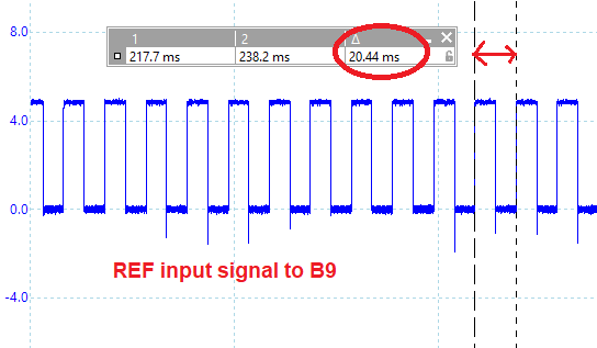

Ok finally got around to checking this out again. And Yes I do have a bench setup working.
There is an arduino buried underneath which is generating a 50hz 5v square wave of 50% duty cycle (confirmed with oscilloscope) - connected to REF input pin B9
Pin B10 (crank reference ground) is grounded.
That is the only input to PCM. There is no 18x input connected.
I have checked with my scope and confirmed:
- EST output on B3 is working
- Injector #1 pulse output on E4 is working
- Fuel pump relay control E10 is working
- Bypass control B4 initially works, but switches straight off (assuming PCM is going into limp mode and reverting to base timing, as nothing else is connected and DTCs will be logged).
So essentially I have an EST signal (even though not required with bypass disabled), fuel pump and injector operation = running engine.
VATS must be disabled in this PCM which I've had here for years. Its a DTCF calibration. I don't believe there are any other changes. I have attached the complete unmodified bin which I have just read with the flash tool if you want to check. This is a complete BIN with the registers left alone, so you should be able to flash it straight on a PCM if you wish to.

pman92 wrote: Wed Jun 26, 2024 8:06 am Ok finally got around to checking this out again. And Yes I do have a bench setup working.
I checked in Tunerpro, using the VX_V6_$BD_Enhanced_v0.9c ADX ( viewtopic.php?t=2518 )
And its showing a flickering 988 / 989 RPM
Thanks so much for confirming this, should be working the way I'm doing this but I'll look into this more now I know it certainly can be done!
Cheers
Edit: I have this all running on bench now, ecu in EST spark mode and seems to be happy and I'm getting EST output etc.
Pretty much just hooked up B10 to ground on an Arduino and B9 to a digital pin, wrote some code that allows me to input an RPM and it outputs a square wave 5v at the hz needed for that rpm, so thanks everyone for your input.
