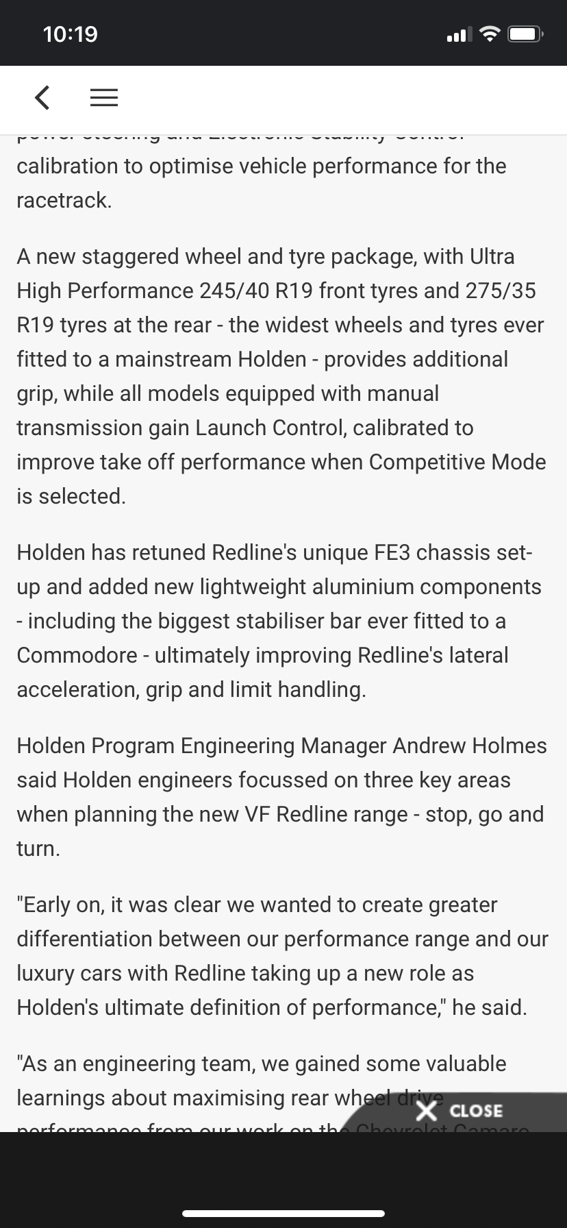

Interesting. I’ve only ever heard good things about bilstein. Didn’t ol brocky use bilsteins back in the early days testing the vb around aus? Pretty sure I remember him talking about that

Quick google. Says they used the largest sway bar of any commodore in the vf. But does mention they used aluminium suspension components probably for the reasons you outlined earlier. Bit interesting that they used larger sway bars though. Be interesting to see if there hollow or solid or what there made out of.
