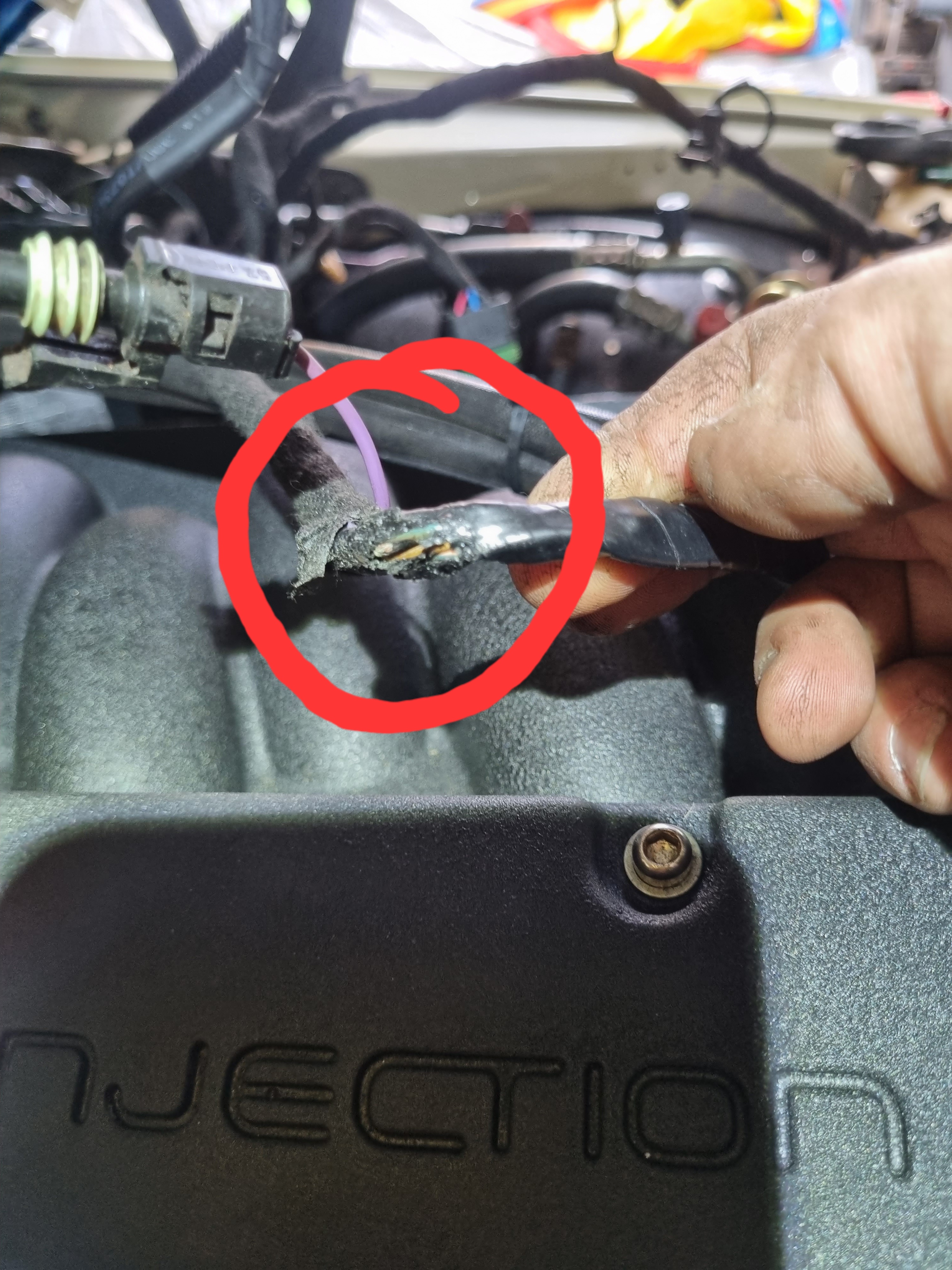

Thanks guys for all the good info. I ended up finding a small section of loom melted at the rear of the RH bank. Must have been sitting too close to the back of the head and caused a ground to one of the negative injector wires. Funny as I checked for continuity to ground on the circuit initially and then moved on. But I guess that's why they call it intermittent. Looks like i should have heatsheilded that one after all. Thanks again for all the input from members it is greatly appreciated.
