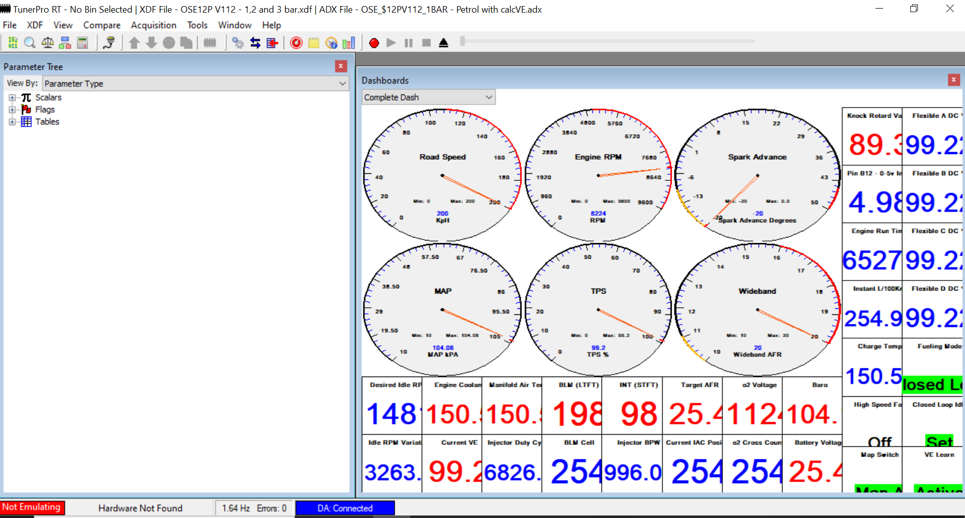

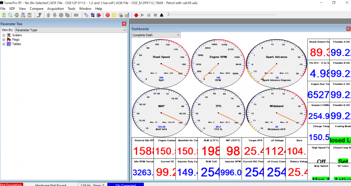

Ive uploaded 2 screen shots of the TP dash display with IGN on ENGINE OFF. im looking at the engine RPM and temps, engine is also cold, has not been started today at all.
previously ive connected with the engine running and the dash stays the same.
RPM sits at 180 but jumps to 8000 randomly.
temps are all hot
ive also put up a screen shot of the ADX im using.

Posts: 8988
Re: Help needed with Comms board & nvram
1.64 hz is very very slow. And you are seeing that without errors, so its probably not anything to do with echo. But the data looks very wrong, too. I am not sure what to suggest, I've not seen a failure that looks like that before. Normally you'd get nothing, or you'd get errors. Slow speed, bad data, but no errors and non-sense data is new to me.
Are you sure its 12p? If it was connecting to the wrong OS, like 11P maybe you could get such weirdness? What is the service number of the PCM? Or perhaps a buggy version of Tunerpro? Or some other software interfering on your laptop is the more likely options. Or I guess damaged hardware before it was sold to you is also possible but that seems unlikely as its not an outright failure. Final option is electrical interference in the car, or bad ALDL connection but I also think that is unlikely as the outcome for those faults would either present as no data or errors logged by tunerpro.

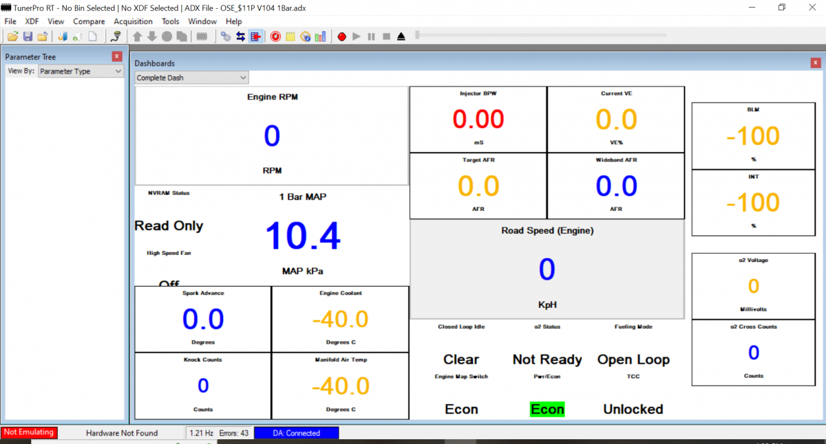

Just swapped over to a 11p ADX to see what would happen
tired both 1 bar ADX files, both had different results. will attach screen shots.
OSE_$11P V104 1Bar.adx This adx had low speed and alot of errors, dash seemed somewhat accurate but once car was started the dash did not change.
OSE_$11P V104 1Bar Message 11.adx this adx had high speed and 0 errors but dash is no accurate.

Posts: 8988
If the computer looks square from the side, its 12P, if it looks rectangle, then its 11P. But now you are getting errors at 11P and VN fits with the square 808 type for 12P. So I guess that's not it.

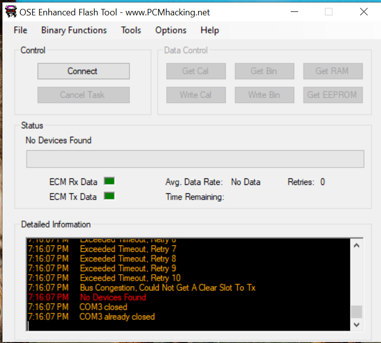

Can you the delco ose flashtool and read a bin? would be interesting to see if that works and if you can read it and post it we can look if its an older version or something, as well as you have whatever was on there as a backup. If the hardware is all good (certainly not sure about that at this stage, the only think that makes me think that could be the case is that you dont get errors with the 12P adx and you do with the 11P adx which gives me some confidence in the wiring and less confidence in the data on the NVRAM) so if someones trashed it somehow before selling it you might need to flash in a fresh copy of the latest to get working. But see if you can read it first without errors before trying that then if that works and once we know whats on it we can advise what to try next.

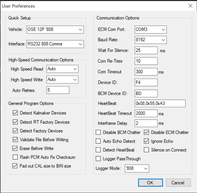

Cant seem to connect to the flashtool. ive changed the preference settings to a bunch of different options and still no luck.
