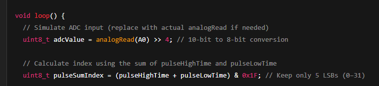

void loop() {
if (newSample) {
newSample = false;
// Rolling average: subtract old value, read new one, add it
total -= readings[bufIndex];
int newVal = analogRead(A0);
readings[bufIndex] = newVal;
total += newVal;
bufIndex = (bufIndex + 1) % 24;
int avg12bit = total / 24;
int avg8bit = avg12bit >> 4;
// Serial.println(avg8bit);
