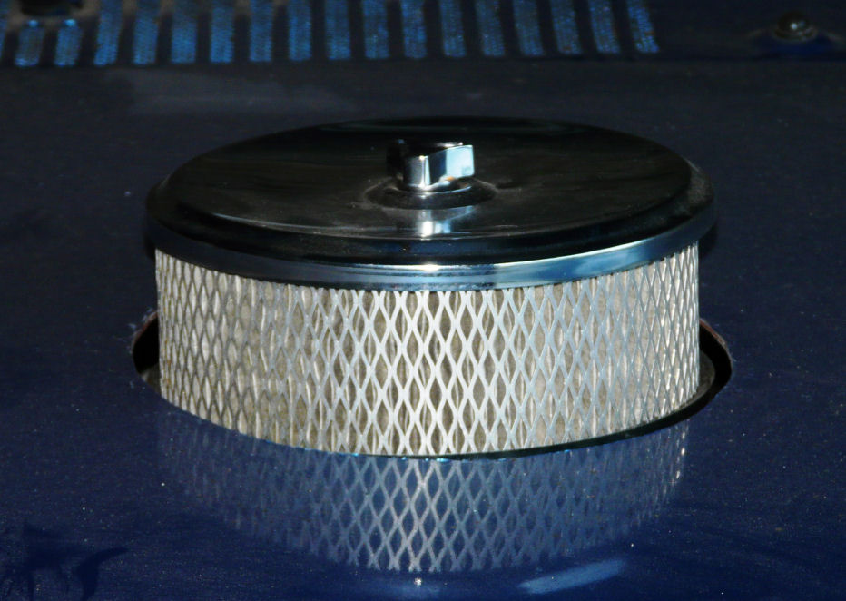

also got my carby spacer
it pretty much worked out perfect, the metal base of the filter is pretty much perfect with the bonnet so that has achieved my objective!! cold air induction the way it should be

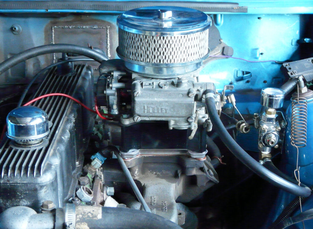

WHAT IS THAT ABOMINATION! It looks like a "CARBURETOR". If you get rid of it that would be a good start!
Just joking. LOL. You should at least get plenty of cold air.

hehehe i know i know
don't worry, delcoing it is in the back of my mind ... maybe later on down the track ... i want to atleast give it a whirl with that carby cause at the end of the day efi is not going to make that much difference to my fun factor on the strip

haha all those carby adapters crack me up every time i see them spacer looks nice though.
Re: My Delcoed Rides
look bugger off and leave my dodgy setup alone hahahah

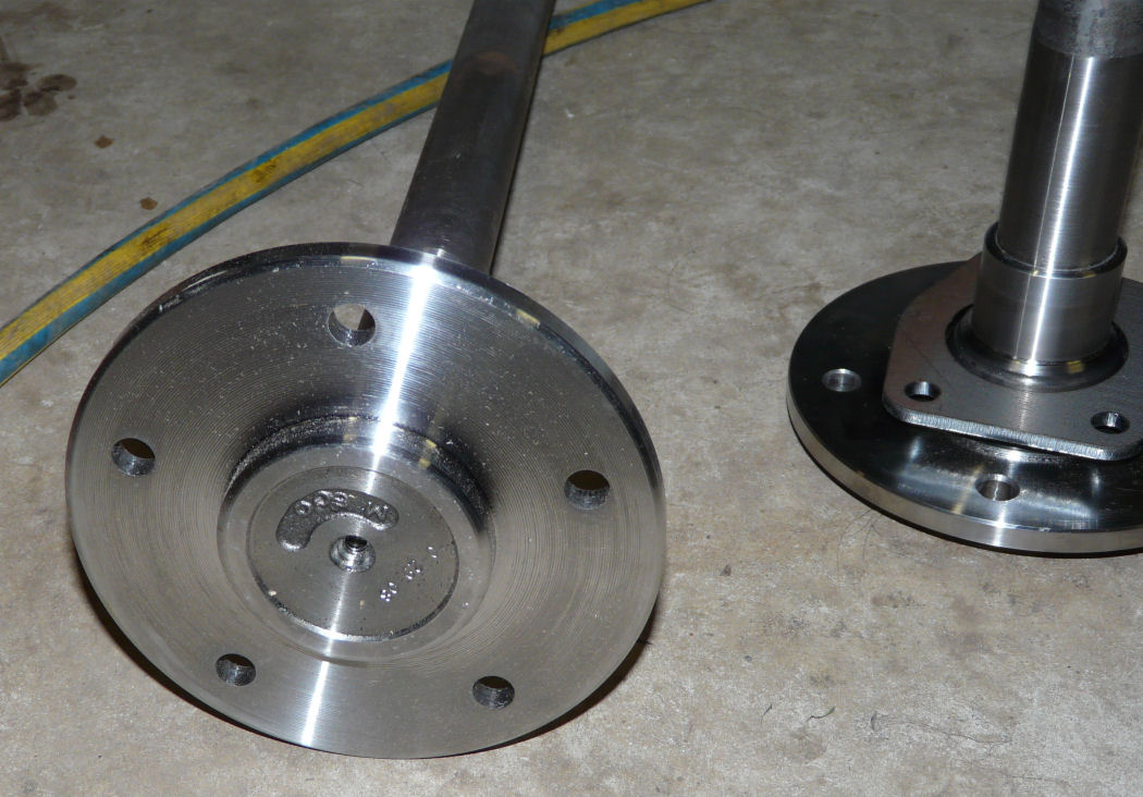

i also thought i would show you all what im going from in the gemini and going to
the axle on the left is standard 23 spline that was in the gemini and on the right is the 31 spline beast!!
as you can see theres a fairluy substantial difference in diameter
