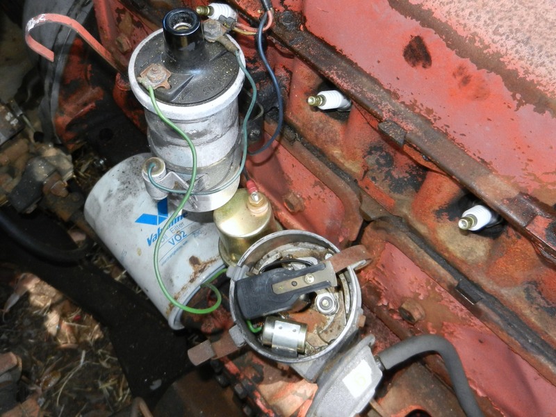

So I'm about to swap over my locked distributor but not sure how to make sure it's lined up properly. Should I just place it using the same orientation as the one coming out or is there more to it?

there may be a better way? but i'd mark the position of the balancer, the rotor, and the orientation of the distributor before you pull it out so you have a reference to where everything was when you started and then swap the replacement in with the same alignment. And when you first get the delco on it put it in diag mode and use a timing light to check its running 10 degrees. If its not you might need to lift the distributor out far enough to move it 1 cog tooth over if its not dead on. Make a note to do this first when you can fire up the ecu.

if your referring to a locked electronic dizzy for use with camira ignition module etc, then yes it does matter where it is located.
the best method is to get the motor on TDC #1 firing before you remove the dizzy - now if your balancer happens to be in the right spot and the mark actually lines up with TDC then you can rotate the motor so the mark is on 10 degrees advanced.
then when the new dizzy goes in you need to have the mark on the base in line with the rotor button. this should then get you pretty darn close to the 10 degrees base timing.... once running then you can put it in diag mode and use a timing light to fine tune to 10 deg.
if your balancer is in the wrong spot which is quite common, you can use a modified spark plug etc to work out the actual mark and then re-mark the balancer to get the dizzy right.
alternatively, i THINK i can see the mark on the old dizzy base just near the middle of the vacuum advance module, rotate the motor so that the rotor button is pointing directly at that, then when you put the other dizzy in make sure the rotor lines up with the same mark and you should be pretty well in the same location as the timing you had before, which again should be close enough for a start.
