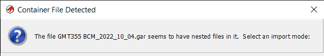

Gatecrasher wrote:New project > import file.
I'm sorry I feel dumb, but this is what I get? also asked if it is a single file or not? I say single then set arm 7 big endian 32 bit. This looks strange
