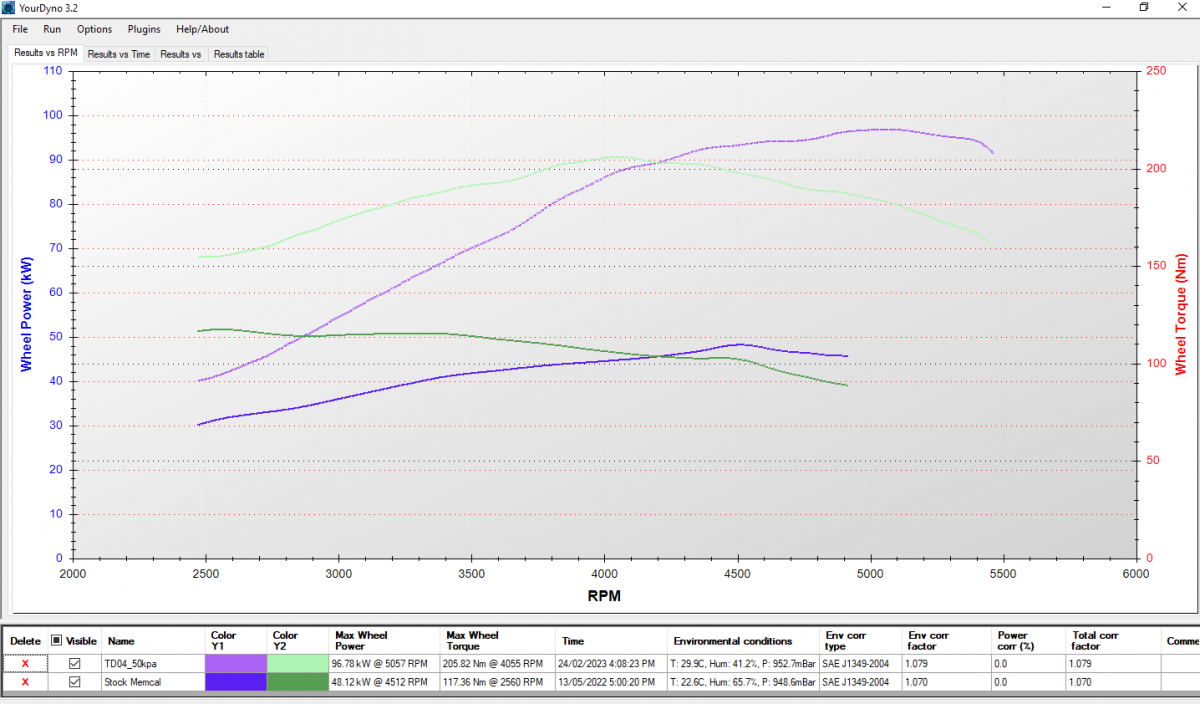

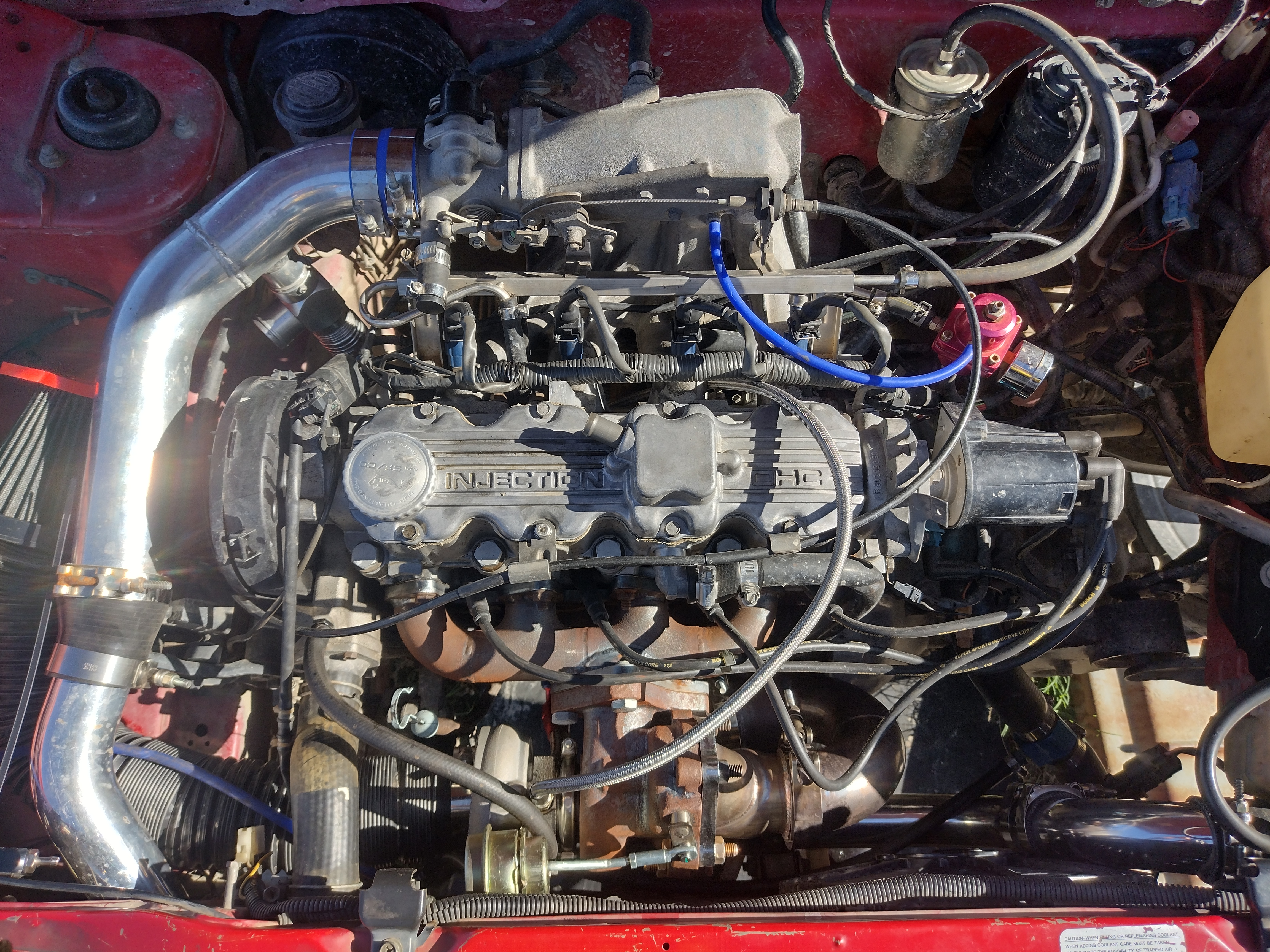

The current build is now using a TD04l-13t subaru turbo. I finished it yesterday and ran it up on the dyno. It's making a safe 97kw atw at 0.5bar of boost. Full boost by 3100RPM, 4psi at 2100rpm. Peak power at 5000rpm
I figure if I raise boost to keep torque level, it should raise power to around 110kw at 5k with theoretically no more stress on the rods than I'm seeing now at peak torque.

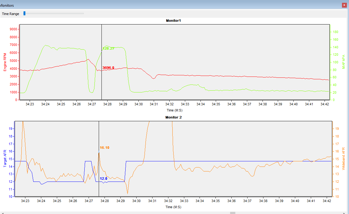

Just coming on boost the AFR went to 16.2 and that's all it took.
Digging a little deeper, I overlaid the VE plot on the graph and it dipped from 90's down to low 40's. But why?

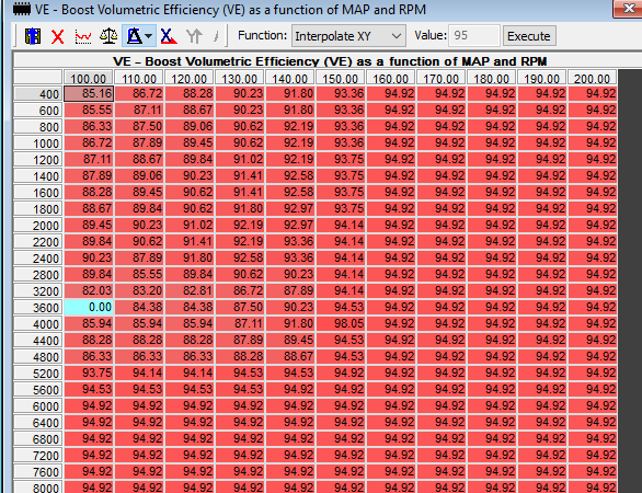

I had a look at the table the VE was being pulled from and there it is...
The CalcVE table I pulled the values from only 1km earlier were populated so all I can guess is I put a 'v' in there when I clicked on the 3600 cell and pressed Ctrl-V to paste the updated VE numbers in. When I hit update it replaced it with a zero. I would think 100 would be safer than zero in such an error case? An easy mistake and one that's cost me at least a head gasket, maybe even a head resurface...

Is that 63kw /130nm charlescrown? Not bad for a 1.6, I assume at the flywheel? I was at 97kw / 203nm at the wheels.

I've had the same issue with 0'd out cells. I found what seems to be a bug with copy and paste of any cells. What seems to happen is if you paste over a cell and leave it selected, then click save to the table, it closes it as it saves iirc. Then when you reopen the table, the pasted section is cleared out, usually 0 or nothing. So to work around this issue, I always click on another cell after pasting, this sort of "tabs" the cell/s and then save the table and it's fine. I always re-open and double check after I lost a heap of VE data that way after spending ages building a histogram in the CalcVE.

I'll definitely be keeping a closer eye on the tables after I save...
