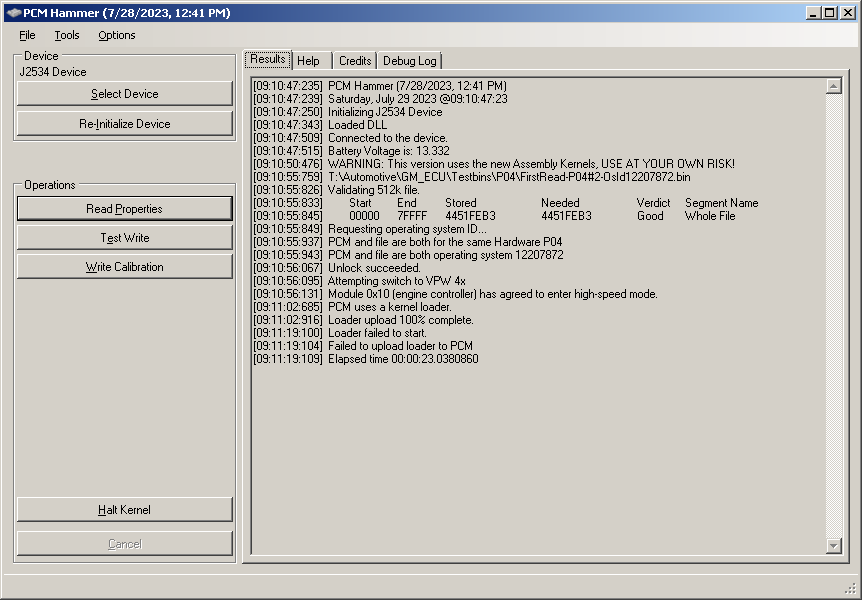

[09:33:09:334] PCM Hammer (29/07/2023, 8:49 PM)
[09:33:09:337] Saturday, July 29 2023 @09:33:09:33
[09:33:09:473] AVT 852 Reset OK
[09:33:09:476] AVT Firmware 1.5
[09:33:11:767] WARNING: This version uses the new Assembly Kernels, USE AT YOUR OWN RISK!
[09:33:16:455] C:\Users\a\Documents\P04 - antus 4444.bin
[09:33:16:473] Validating 512k file.
[09:33:16:482] Start End Stored Needed Verdict Segment Name
[09:33:16:491] 00000 7FFFF 2A1DB4A1 2A1DB4A1 Good Whole File
[09:33:16:495] Requesting operating system ID...
[09:33:16:579] PCM and file are both for the same Hardware P04
[09:33:16:584] PCM and file are both operating system 12589762
[09:33:16:589] WARNING: P04 Support is still in development.
[09:33:18:497] Unlock succeeded.
[09:33:18:558] Attempting switch to VPW 4x
[09:33:18:584] Module 0x10 (engine controller) has agreed to enter high-speed mode.
[09:33:21:717] PCM uses a kernel loader.
[09:33:21:981] Loader upload 100% complete.
[09:33:21:995] Loader Version: 69000104
[09:33:22:000] Loader uploaded to PCM succesfully.
[09:33:22:215] Kernel upload 21% complete.
[09:33:22:396] Kernel upload 47% complete.
[09:33:22:580] Kernel upload 73% complete.
[09:33:22:770] Kernel upload 100% complete.
[09:33:23:891] Kernel Version: 82400204
[09:33:23:896] Kernel uploaded to PCM succesfully.
[09:33:23:971] PCM and image file are both operating system 12589762
[09:33:24:033] Flash chip: Intel 28F400B, 512kb
[09:33:24:038] Calculating CRCs from file.
[09:33:24:046] Requesting CRCs from PCM.
[09:33:24:051] Range File CRC PCM CRC Verdict Purpose
[09:33:24:056] 060000-07FFFF not needed not needed n/a OperatingSystem
[09:33:24:063] 040000-05FFFF not needed not needed n/a OperatingSystem
[09:33:24:069] 020000-03FFFF not needed not needed n/a OperatingSystem
[09:33:24:076] 008000-01FFFF not needed not needed n/a Calibration
[09:33:24:339] 006000-007FFF E8244787 E8244787 Same Parameter
[09:33:24:610] 004000-005FFF C431BB2E 85B5BB36 Different Parameter
[09:33:24:622] 000000-003FFF not needed not needed n/a Boot
[09:33:24:633] Processing range 004000-005FFF
[09:33:24:643] Erasing.
[09:33:25:614] Writing...
[09:33:30:802] Calculating CRCs from file.
[09:33:30:814] Requesting CRCs from PCM.
[09:33:30:822] Range File CRC PCM CRC Verdict Purpose
[09:33:30:831] 060000-07FFFF not needed not needed n/a OperatingSystem
[09:33:30:841] 040000-05FFFF not needed not needed n/a OperatingSystem
[09:33:30:850] 020000-03FFFF not needed not needed n/a OperatingSystem
[09:33:30:861] 008000-01FFFF not needed not needed n/a Calibration
[09:33:31:135] 006000-007FFF E8244787 E8244787 Same Parameter
[09:33:31:421] 004000-005FFF C431BB2E C431BB2E Same Parameter
[09:33:31:433] 000000-003FFF not needed not needed n/a Boot
[09:33:31:500] All relevant ranges are identical.
[09:33:31:512] All write-request messages succeeded on the first try. You have an excellent connection to the PCM.
[09:33:31:526] Please help by sharing your results in the PCM Hammer thread at pcmhacking.net.
[09:33:31:539] Flash successful!
[09:33:31:617] Clearing trouble codes.
[09:33:32:724] Elapsed time 00:00:14.2222334
