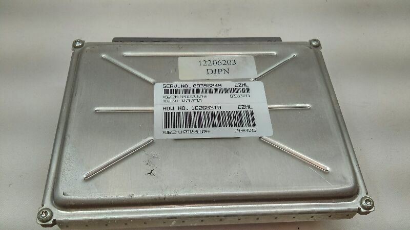

Ive been looking at HDW 16268310.. Is that also a P08, or something else? If so, anyone know what? Its 00-02 Chevrolet Cavalier among others.

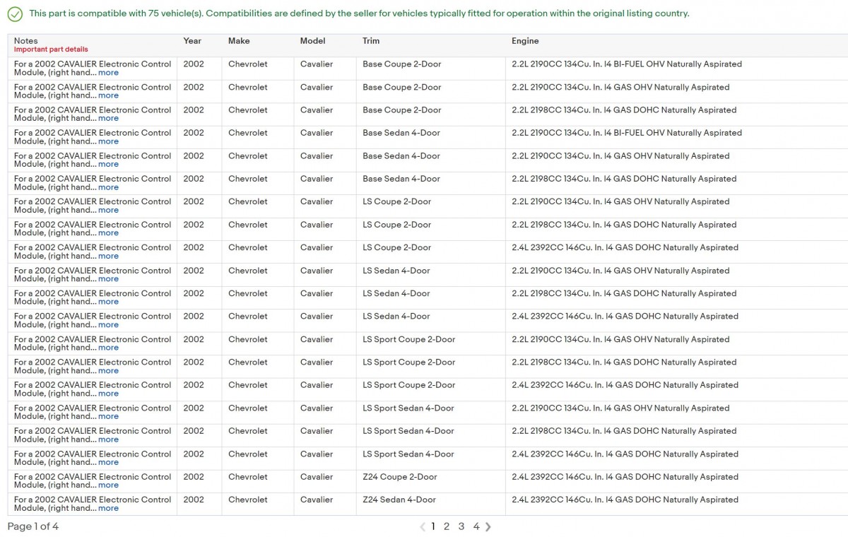

Antus,
That number shows it fits a 2000 Pontiac Sunfire 2.2L, my info shows it could be a P08 or P11, then consider what Mudduck514 states above, it is a P08, if it looks like a P01.
My info shows the 1997-2003 Chevy S10 Pickup and GMC Sonoma with the 2.2L (L43/LN2) also uses the P08.

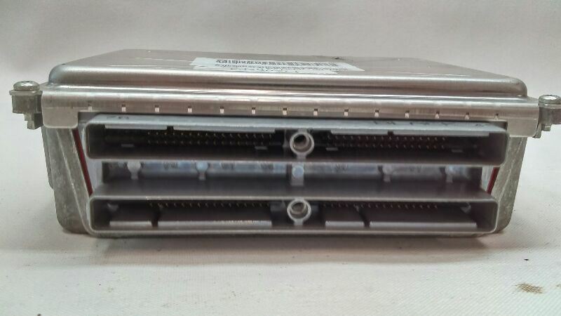

Let's try this again - MAYBE it will post the picture!
Mike
Posts: 10111
Re: PCM Hammer P04 Support Project
Ok, so hdw 16268310 looks like it is the P08. So I have one on the way to see if we can add it. And it looks like it ran from 2000 through to 2002.

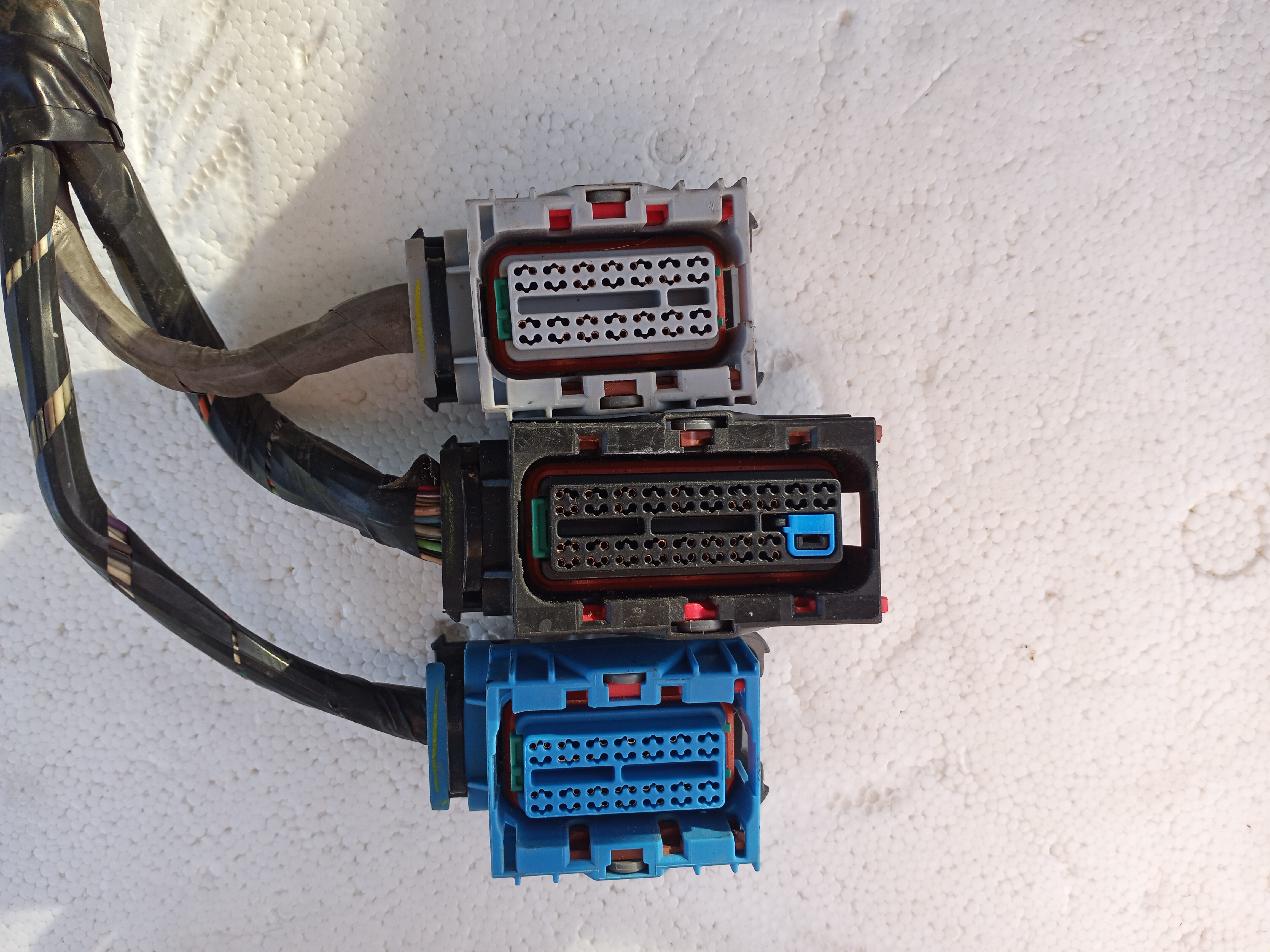

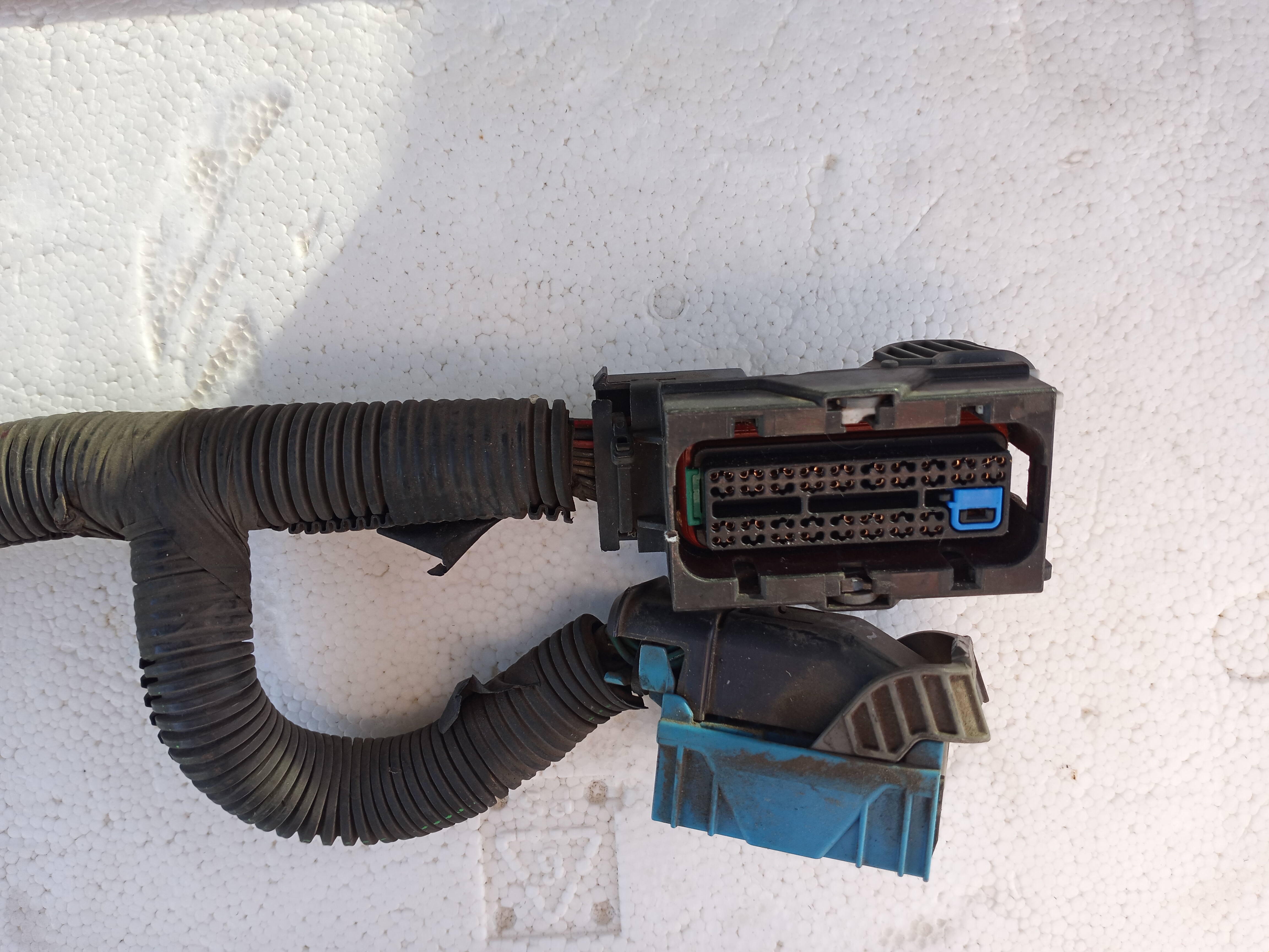

Connector for P05 and P11 PCMs
P05
P11
Posts: 2332
Post by Gampy »
To clarify, is it 3 Connectors for P11, 2 for the P05 ??
-Enjoy
MudDuck514
Posts: 402
Joined: Tue Jul 04, 2017 10:30 pm
LD9 2.4l I4, 4T40E
2005 Chevrolet Venture
LA1 3400 V6, 4T65E
Location: North TX, USA
Post by MudDuck514 »
Gampy,
Just the opposite:
The P05 has 3,
The P11 has 2.
Mike
