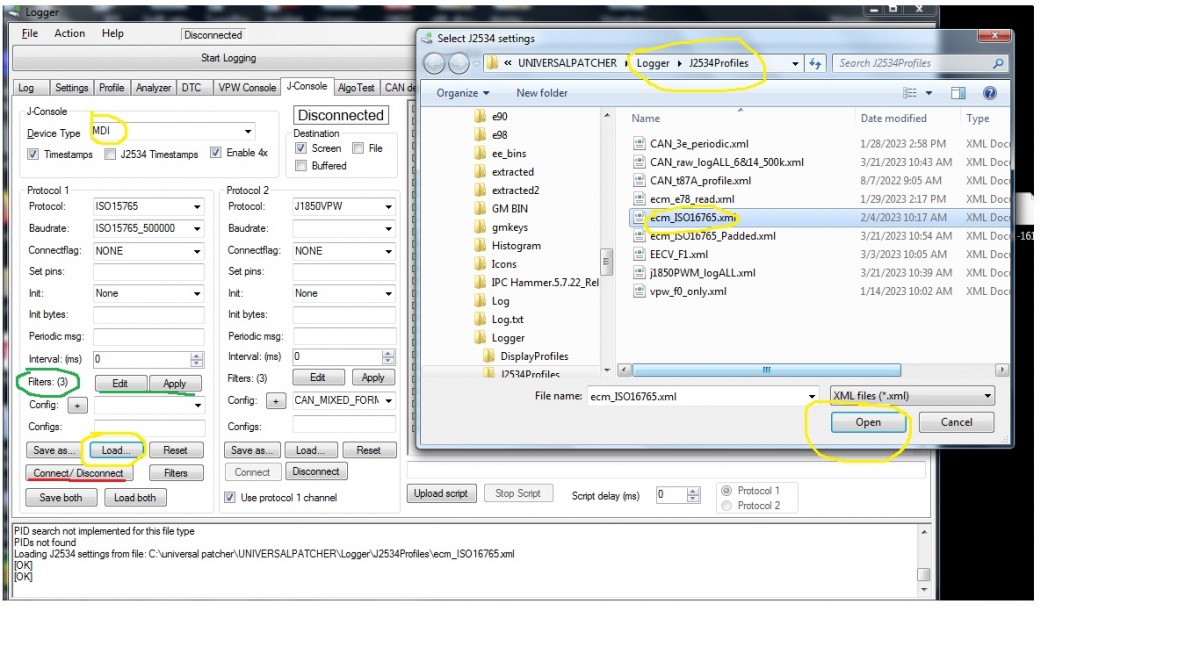

kur4o
- Posts: 1154
Re: Gm bcm and cluster can bus messages through eml327 scrip
I can`t stand that elm torture, It looks like elm is really slow on can and can`t format longer messages, I did some testing with an obdlink device with it extended ST command set, but also got some error FC error. So i also gave up on it.
Here are some presets configuration for connecting j-device with universal patcher.
first is in raw can it will open connection and set filters for communication with all modules on bus, but filter idle data.
second is to connect to bcm in iso15765 protocol and send and recieve data.
Use the load button per the screenshot to load the configurations, select device and click connect.
