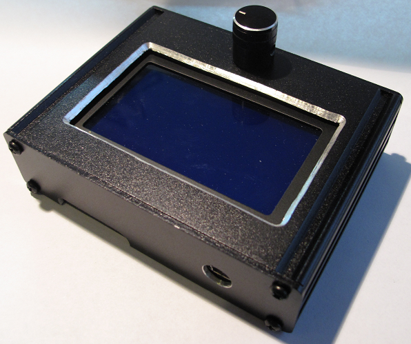

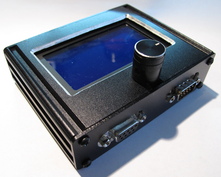

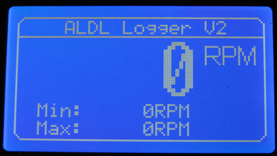

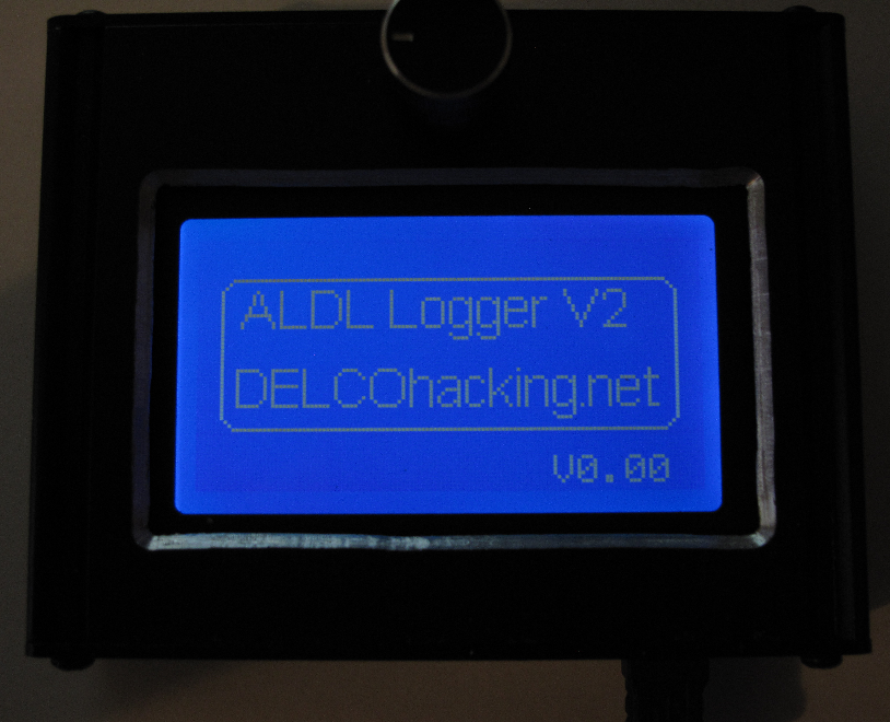

VL400 wrote:This is possibly the longest project in history, but have totally redesigned the logger to be much easier to assemble and hopefully get a few more made. The original took far too long to build up and had many fiddly parts. Also changed a few things, it still logs to to an SD card in XDL format and uses ADX files for config but the main changes are..
* Aluminium Case
* Graphic LCD
* Rotary encoder (press to select)
* Buzzer
* 4 x Analog Inputs
* 2 x Digital Inputs
