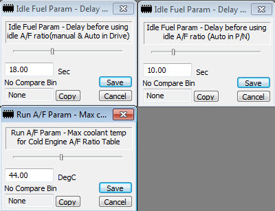

Posts: 10436
vlad01 wrote:As for this time out, is it adjustable and whats it called? Would be nice to stop it as it makes the engine stumblely at idle.
ok so max coolant temp for cold engine table is the one to dictate when it switches from the cold afr tables to the main afr tables .... you could maybe even increase this if its needing to be richer for longer.
the delay tables there are the ones you want to change times to make that 20 seconds smaller .....
you'd notice it if you have the motor up to temp even, you are driving along and come to a stop, 18 seconds after you stop the target AFR will jump from main to idle table figures.
like I said I normally change this to 5 seconds for most worked motors I've tuned, I have found if its at 14.7 for too long at idle it can start to hunt, but I've never had an issue with 5 seconds ....
its probably another emissions or save fuel type of setting .... but also stock motors will run a lot leaner at idle happily ....
for reference the above tables are from $12P BLCD.
Posts: 3364
cars: VR Commodore V8
Post by Dylan »
I just re read VL400 post. Thats the delay I was talking about for idle fuel afr.
But as said I always have that delay very short as well. Must line up with the closed loop idle flag. As I always took that as speed control and idle afr table. Obviously 2 different delays happening.
Set them to 2 seconds and should be good. Closed throttle then u der 5kmh then wait 2 seconds and you're in idle mode.
