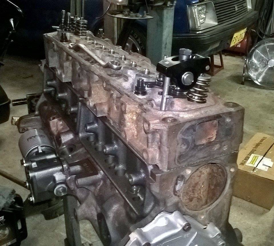

so knowing I needed springs, I got the head setup with outer springs so I could check pushrod lengths and order pushrods and springs at the same time!
the roller rockers look right at home up the top there
