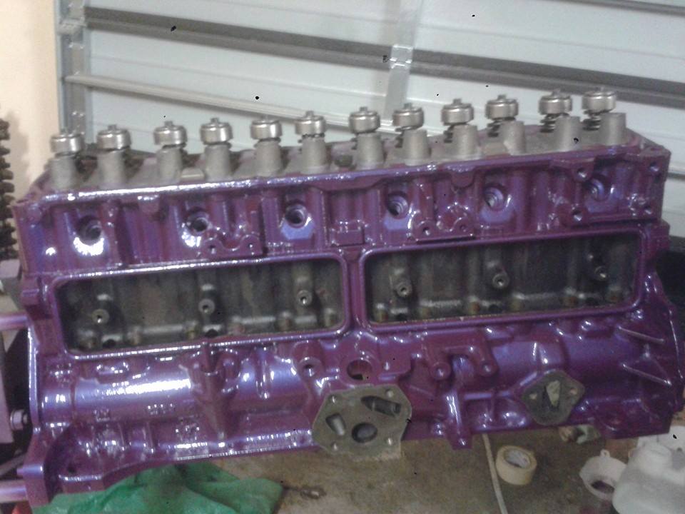

3.3 is all machined and painted ready for assembly new cam bearings the works oh the 2K goodness
Re: DELCOS NEW RIDE
paint looks pretty nice! and good to see theres no rotators on the exhaust valves!

its much like camilian paint purple changing to blue as you move around pretty trippy looking.should look the part all assembled

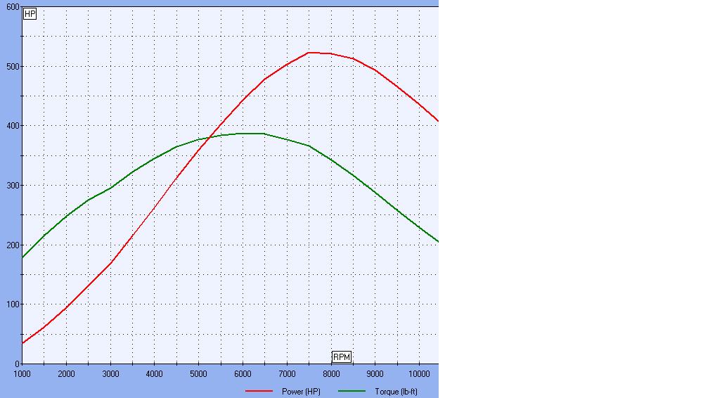

cam for the 202 arrived last week shes big 240/240 at 0.050 0.477 0.483 valve lift 111 LSA 108 114 centres nice early intake opening to stop the long runners reaching the speed of sound cant wait to hear this sucker

couldnt not sim the cam holy mother of god im scared LOL
Re: DELCOS NEW RIDE
7500 rpm in a 202... you makin peak torque higher than they even rev to stock haha... hope its got a good bottom end!
Re: DELCOS NEW RIDE
hahahah yeah shes gonna want to rev to get moving! I assume its not planned to be a daily driver lol!
