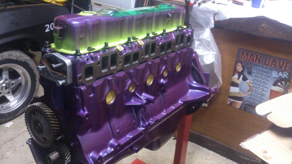

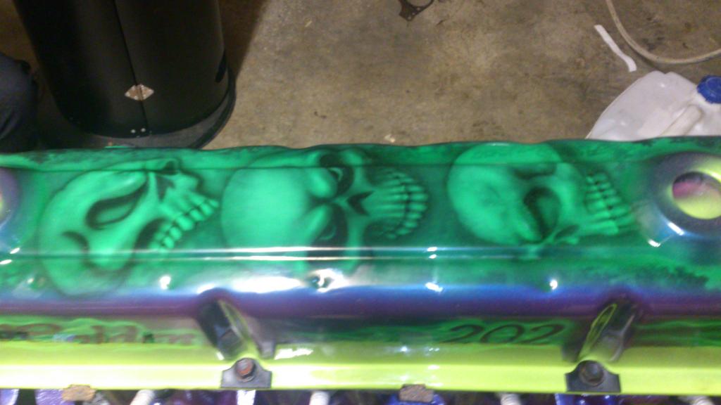

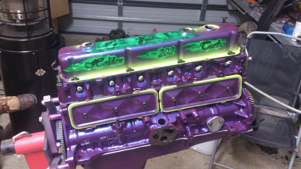

geez that's the flashest tappet cover paint job I've ever seen!
bugger about the leaking flange! nothing worse than having to pull it half apart after just getting it together.
