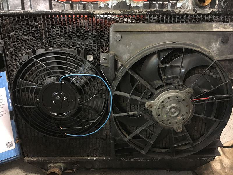

Yes correct re the intercooler. I have another 10 inch fan which will be a 'puller' and should be here by the end of the week.

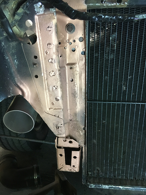

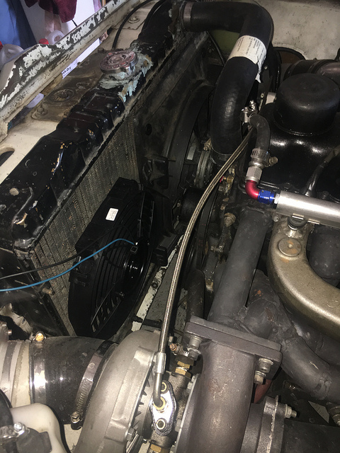

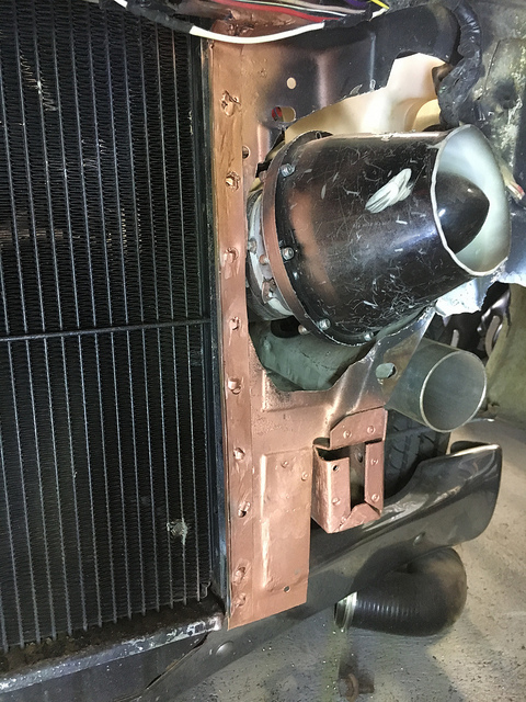

Bit of an update on the weekends work. Encouraging signs from the shed test, it was about 30 degrees today and when the thermo's fired up the temp gauge dropped very quickly but nothing like a test on the road. Its going to be hot here this week coming up and they are predicting 43 degrees on one day so I will take it out for a test at the high 30's first then might tempt fate on the 43 degree day.

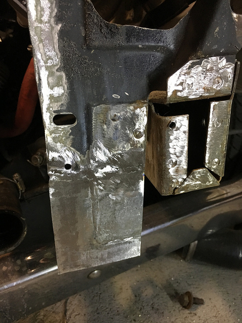

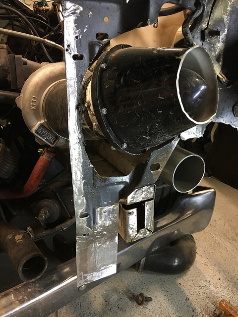

Made this replacement piece for the passengers side radiator support panel.
The panel started to get a bit flappy as so much of it had been removed for the cold air intake so I made up an additional panel, put a bend in it like the factory edge I had cut out and drilled holes to plug weld it on.
This is the drivers side
Full airflow now.
10 inch fan to supplement the Ford thermos fan.
