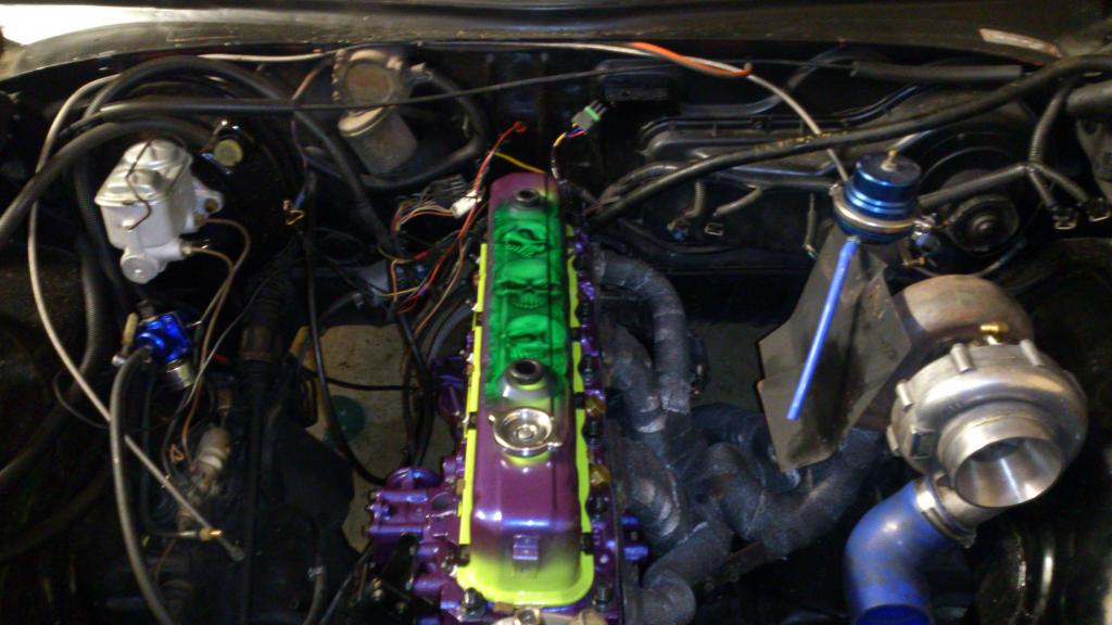

Re: DELCOS NEW RIDE
202 in the hole few little bits to go

Re: DELCOS NEW RIDE
its aliiivvvvvvve ahahahaha sounds sick as hell LOL and even with the drop in comp and the cam its just as responsive as it was if not better and it seems to have more torque when letting out the clutch :D havnt driven it but all run in ready for some tuning to get it to idle its a tad richer than it used to be LOL

Re: DELCOS NEW RIDE
:punk: Nice work
Pretty sure holden202T is still busy watching and listening to the videos :lol:
Re: DELCOS NEW RIDE
hahaha yeah started to watch one and then a customer came in, then 1.5 hrs later im back :)
yeah definitely sounds rich at idle!
keen to see some on road testing vids ;)
