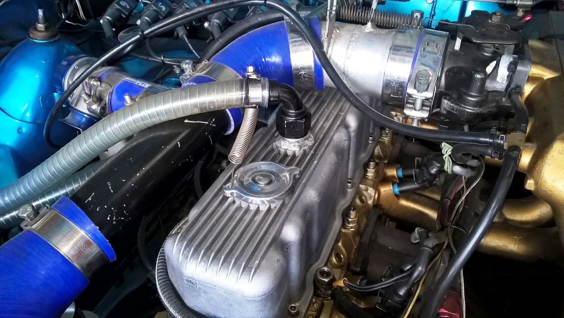

other than chasing my fuel capacity i did have an issue with loosing my oil filler cap after the first run!
i asked at the start line if anyone had seen it but there was nothing at the time so we ran into town to see if we could find a parts shop with one, to no avail, then my brother rang me saying that it was announced over the PA and they got it back.
so we straightened it out as someone must have run over it (maybe even me) and then upgraded it before re-installing.
