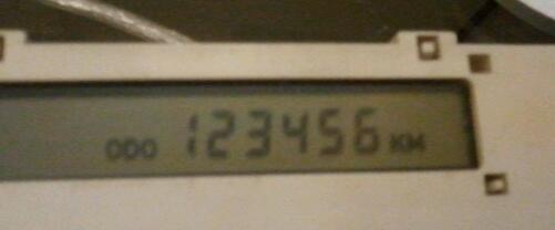

when i get home ill reflash one of the chips, ill go and drive it to the next km and then get another read and see if we can figure something more out then possibly.
- Posts: 4853
ok got it working now.
448982KM
not sure what the first line is yet but the number lines, each segements need to add upto FF, so DD+22=FF then you need to recalc the checksum at the start then it will work.
448982KM
C0B5 E113 FF00 DF20
F20D DD22 6E91 BE41
F20D DD22 6E91 BE41
F20D DD22 6E91 BE41
Reason: wrong km
Reason: wrong km

- Posts: 4853
Thanks VL, no cigar yet though, These worked for simplicity ill just copy the line, the header i used was
C0B5 E113 FF00 DF20
C0B5 E113 FF00 DF20
448,982
F20D DD22 6E91 BE41
348,982
FC03 D32C 6E91 BE41
248,982
F40B DB24 6E91 BE41
Though a Random pick think i have it right, didn't work
1523km
6C93 FF00 57A8 3BC4
- Posts: 4853
tried a few others which worked, using same working
8,982KM
82km
10km
1km
now back to these
Some checksum related thing to do with the first line?
8,982KM
82km
10km
1km
now back to these
1530 no work
A45B FF00 57A8 F30C
1529 no work
3CC3 FF00 57A8 6B94
1528 work
BC43 FF00 57A8 EB14
1527 no work
4CB3 FF00 57A8 1BE4
1526 no work
CC33 FF00 57A8 9B64
1525 no work
0CF3 FF00 57A8 5BA4
1524 no work
8C73 FF00 57A8 5B24
1523 no work
6C93 FF00 57A8 3BC4
1522 work
EC13 FF00 57A8 BB44
1521 no work
2CD3 FF00 57A8 7B84
1520 works
AC53 FF00 57A8 FB04

- Posts: 4853
haha yeh not to many people would have looked at that one in there car.
