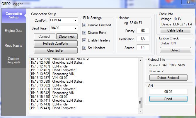

Yeah will have to try it out on the i30 when the cable rocks up.
I tinkered with some other software, and it didnt see the response unless I added the carriage return.. so now Im really stumped!. Unless that software reads byte by byte until it finds carriage return,newline or >.
Ill try adding a few different read methods.
Read 1 will be the normal read we have now, relying on the carriage return to pick up the message.
Read 2 will rely on there being a newline present..(have to keep linefeed enabled for this)
Read 3 will rely on the elm idle status. As soon as it receives that.. it must have completed the message.
Read4, will simply loop through and continue trying to read byte by byte until cancelled.
Annnd, cant think of any other ways the device may output so will update with the above for the engine section.. and see how we go from there.

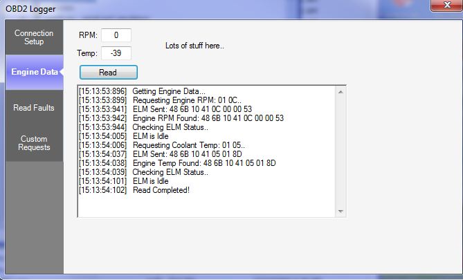

You guys are sending me head into a spin. I need to spend a lot more time trying to understand ECU data etc but I am slowly learning. I was just wondering why some ELM units link at a much lower speed than mine? Also with quiet a few OBD2 protocols will this end up generic or specific? Does it matter in the programming? I assume it does. I know the output pins are different but is the data the same?
Must be bloody cold in Woodburn -39?

Charlescrown wrote:Hey Delcowizzid hows the car after the wheel catastrophe?
haha yeah thats coz my ls1 pcm is sitting on my bench and its only got power, earth, and obd2 hooked up to it! as for the strange differences between the elms, I woudl hazard a guess its the differences between chinese clones and the real deal, and the small differences and bugfixes between the various versions.
as for being generic or vehicle specific, for OBD2, each peice of sensor data from the pcm is called a "PID" and there are 2 types of PID's SAE PID's which are required for any car to meed the obd2 specification, and there are manufacturer specific PID's. the 2 groups of manufacturer specific PID's that I know of are "GM Enhanced" and Ford somethingerather. so all the SAE obd stuff should work on any car
