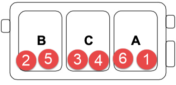

So it looks like we're triggering at 60 degrees different in our implementations, but then you are wiring the coilpacks one coilpack out, which is offsetting the firing order by 1 cyl and making up for it, and its batch injection so it runs fine.
But in the 4 cyl you only have 2 coils so you cant get the same offset by moving the order you place the coils with that trigger (trigger is the same for 4cyl and 6cyl), so that mine works with 60/70 (and that the reference is configured to 60/70) I think that proves that its not supposed to be 10 degrees, even if it was working on your 6cyl like that.
Thats probably also why the motec one says BCA, they've done the same thing in their documentation. If would be ABC if they used the right reference angle.

I can tell you for sure 0 degrees is wrong. Please dont document that in a howto. Otherwise, good stuff. As you can see it should be 60 but you can get away with 10 and offset the coils by one if you are on a 6 cylinder but it cant be done for 4 cylinder even though it is the same trigger. So this is what you have done on your 6, then you are 10 degrees out on top of that. So when you are starting it you'll get a weak start because you have no advance and you should be getting 10 from the module before the ecu gets sync, and when you have it idling, and put it in to diag mode for 10 degrees delivery, you'll get 0 deg. Though that's give or take because of accuracy in everything.

Are you saying that this picture of the jackaroo coil pack with its firing order 123456 and its BCA coil pattern is wrong?....After reading previous post I think that's what you saying.

Yeah i am saying the Motec document is out by 60 degrees and 1 coil. And they cancel each other out and since we are not running sequential injection it's only academic because the result works. But its still wrong. I think it should be 60 degrees reference as the factory does it in their tunes and coil order ABC.

For a 6 Cylinder with firing order 153624 this should be how you connect the coils to leads, then the only thing left will be the crank trigger being in the right spot!

Yeah mate this is the config that i have had it running. But Antus tells me that coil pattern and and sensor position is wrong. I don’t know but you guys have had a lot more experience than me. (AS ABOVE)Holden202T wrote: ↑Wed Jun 12, 2024 12:00 pm For a 6 Cylinder with firing order 153624 this should be how you connect the coils to leads, then the only thing left will be the crank trigger being in the right spot!
I would like to get it setup the right way. The isuzu picture of the coil order (page 10 last post) is what you have said.is correct and that matches the isuzu manual but that picture is all i could find. I have not been able to find a workshop manual that shows sensor setup ect.....

That looks correct to me.Holden202T wrote: ↑Wed Jun 12, 2024 12:00 pm For a 6 Cylinder with firing order 153624 this should be how you connect the coils to leads, then the only thing left will be the crank trigger being in the right spot!
Each coil should be on 2 opposite cylinders, so when it fires the spark in the waste cylinder that isn't at the top of the compression stroke, is at the top of the exhaust stroke.
EG cylinder 1 should be on the same coil as cylinder 6.
If you offset the cylinders by 1, wouldn't that put the waste spark on a cylinder elsewhere in the cycle?

Not 1, one coilpack. But definitely set the reference angle to 60 not 0 in the tune, then see how you go.
