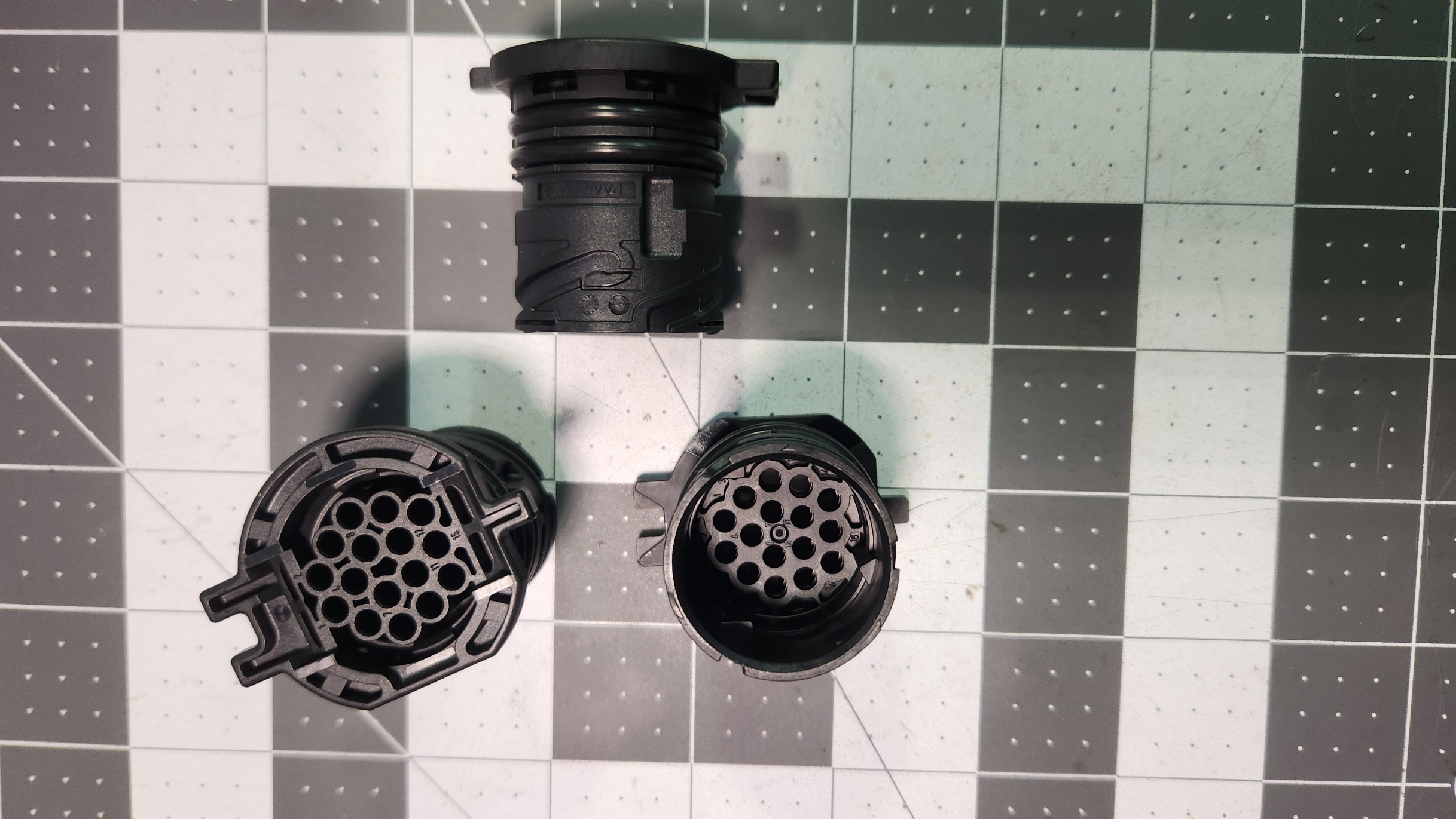

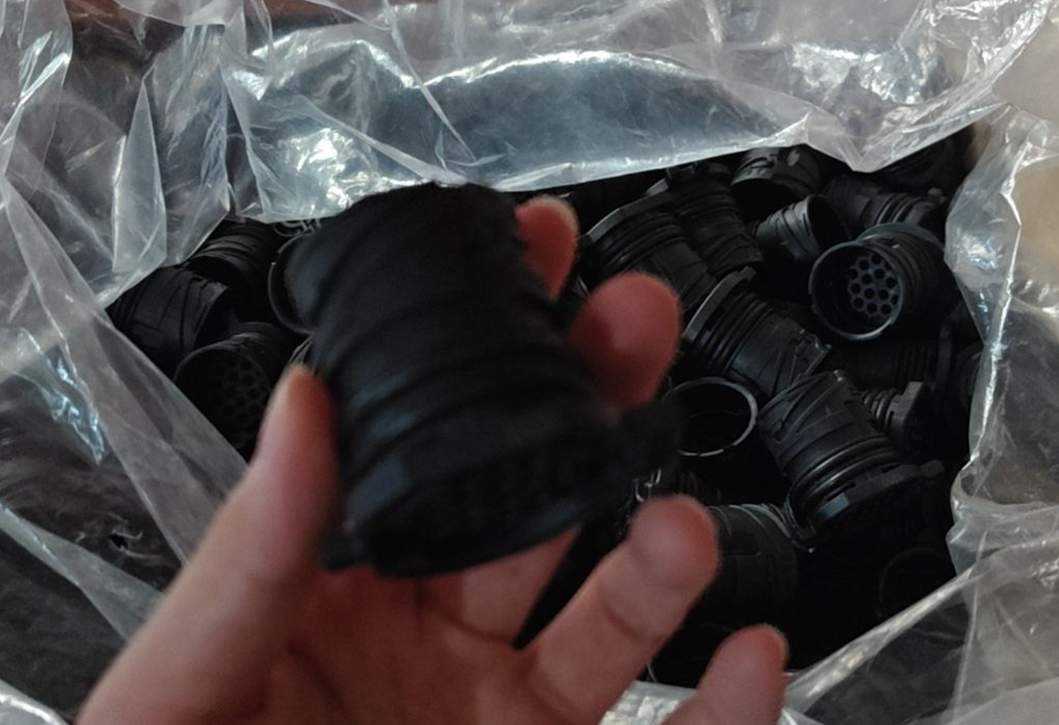

Nailed down a source with some of these properly coded, wire terminal type 6L80 TCM matching connectors. But with a minimum buy of 100 pieces. Or I wait 60 days for the manufacture to run another batch.
How much gear head demand is there is for these in the real world at $15ea. I need a dozen or so. Beyond that, the rest be fleeBay bound.

i think initially the demand would be low.
i certainly can't imagine there would be too many aussies doing it... i might need to be the trend setter on the 10l conversion first before others catch on. lol

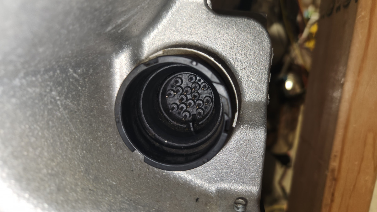

Yeah I'm with ya being a low demand item. Reason I'm looking for another outlet.. LOL. Personally, I'd wack that thing outa the harness in about three seconds and go to a Molex 16 pin to bridge the harness gap. But at least four people have ask me so far if I can supply a plug-N-play adapter for 6L swaps. To which I've answered, "Sure thing, you're not using that 6L valve body any longer correct ? "
Heck I've never even looked at a 6L pinout yet, but I sure know 8 of those 16 wires don't need to go past the firewall on any external TCM swap..

These became available again in U.S. So I purchased a few to verify the fit. Waiting on some terminals to arrive from Asia, as those are Not available over here in small quantities.

I tested one of those Kostal TCM side connectors without terminals against the 6L80 harness. While the outside dimensions are the same, the keyway and pin placement is way off.. Was a good try I guess...
Pretty dang glad I waited and didn't buy those 100 pieces from Alibaba, or I'd be making plastic mulch this weekend. But since I have a couple in hand, will drop one off to the guys doing my A50 connectors, and see if they can correct that pin placement issue affordably.
