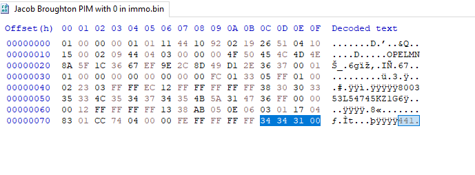

Heres the .bin of a factory PIM, straight from GM they have set the numeric value "0" as hex value $00 which comes up as the ascii character " . "
So to use this ecu on another car, you need to keep the PIM and ECU together as the "pair" and link the cars BCM to them instead as you cant physically reset ECU.
I have come across this 6 times on the 134 ecus i have reset and reused
Perhaps The1 maybe able to add the ability to write the ECU pin number in a hex value or an option to attempt to unlock ecu by hex value instead of numerically?

Yep resetting a PIM still retains the pin code it has, it just allows the use of the relink command to send it's security code off to the ecu. Then when rerunning the Relink it just uses the pin code in the PIM to send to the ECU.
Tazzi had the same issue and he tried making it work but couldn't reset the ecu, the issue is that the memory is actually blank, there is no value there, the character there your looking at is nothing, the . just represents nothing, ASCII . is 2E hex , the only thing you could try is reset the PIM, change the PIM's pin code just the last digit then run the relink and see if it fixes up the missing digit? But because it's status is linked it prob wont. Id suspect the writing process in the factory missed the last bit.
Im going to try but not expecting the PIM to support read or write by memory address over CAN.

Have come across that also, they can be reset, the code for that one is 0441hsv08 wrote:Heres the .bin of a factory PIM, straight from GM they have set the numeric value "0" as hex value $00 which comes up as the ascii character " . "

thats interesting then if it is that number, so it treats the last digit as the first digit and blank as a 0

Oh really? Never thought of swapping that blank to the front Instead.jxx wrote:Have come across that also, they can be reset, the code for that one is 0441hsv08 wrote:Heres the .bin of a factory PIM, straight from GM they have set the numeric value "0" as hex value $00 which comes up as the ascii character " . "

Will try and reinduce that same pin to an ecu and go about swapping that blank for a zero but at the front.

Thought it was like a BCM number when you pull that with some scantools, they spit out a 5 digit instead of 6, so tried this one with 0707 and it reset.
And yeah, interesting how it moves the 00 to the front and essentially is a 3 digit code.Re: VZ V6 E55 ECU Brute Force Reset Tool & PIM Relink
Wicked, It may well be just as you say. Will try and write one or two today like above and see what i come up withjxx wrote:Thought it was like a BCM number when you pull that with some scantools, they spit out a 5 digit instead of 6, so tried this one with 0707 and it reset.
