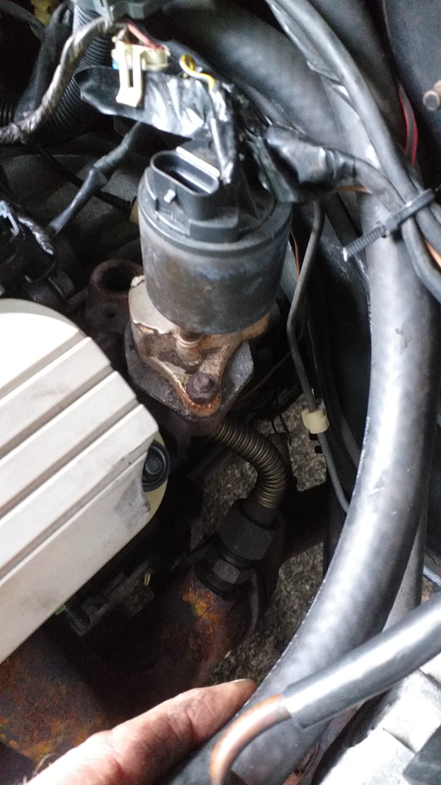

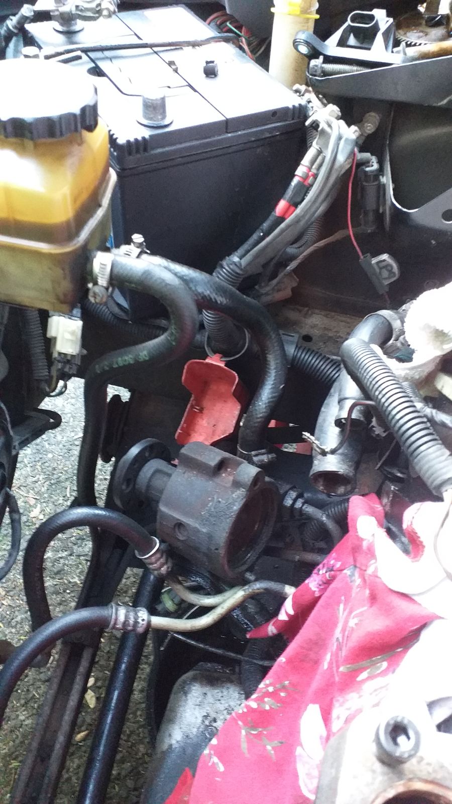

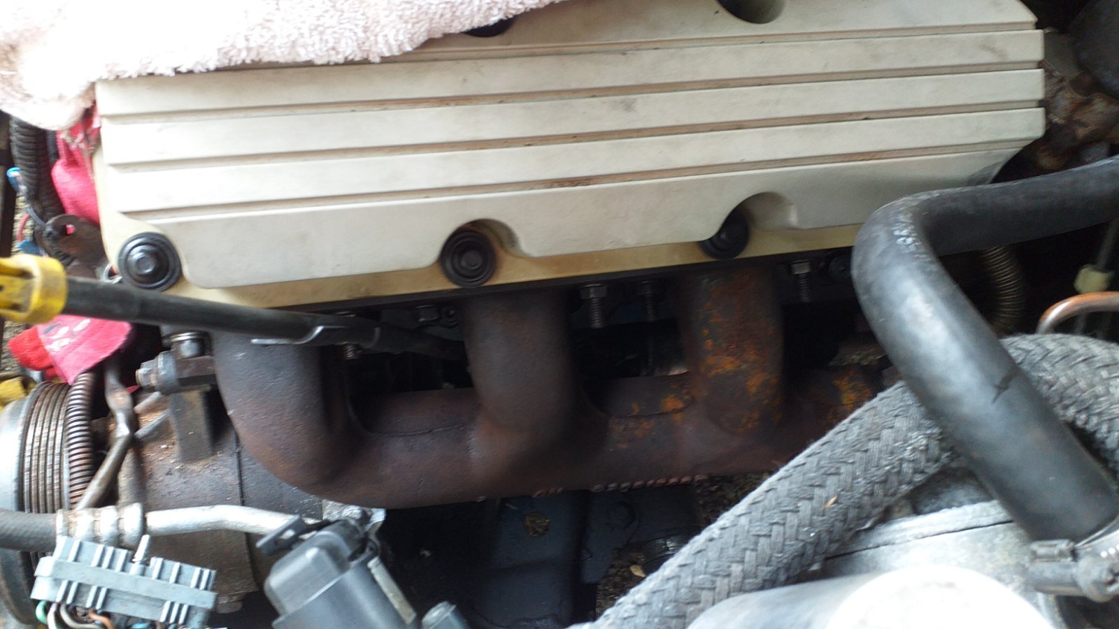

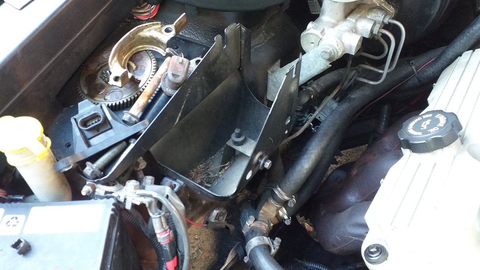

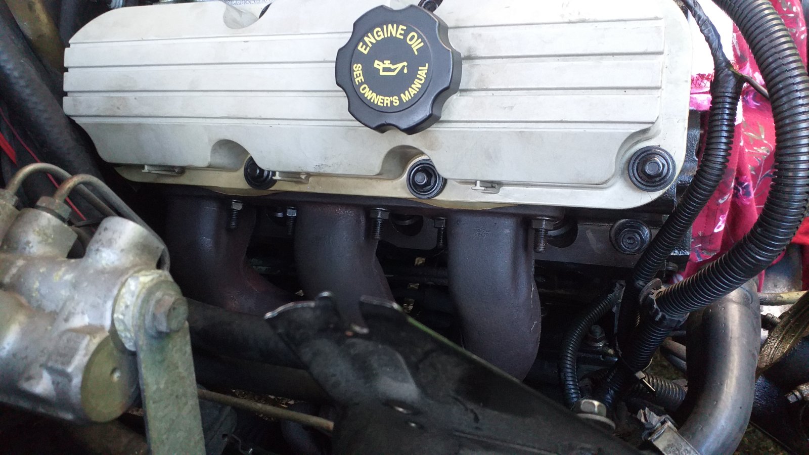

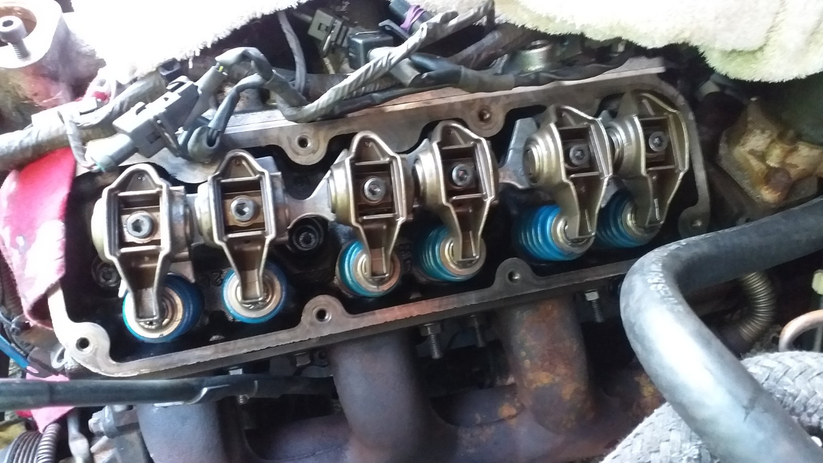

Got an update this morning on my cam magnet, apparently it has arrived in NZ and is out for delivery so it was time to make some progress before it arrives. Got the exhaust system fully buttoned up. I think the Captains side manifold may be touching one of the ARP head studs. It looks like it's fully home and flush against the head. If it seals all good other wise it may need to come out so I can clearance the exhaust manifold a touch. I also swapped in a cap screw in the very front exhaust manifold bolt hole, the one that tends to fail. Whilst I was there I swapped out all the old rocker bolts and fitted new cap screws. Fitted up the EGR valve on the back of the head and cleaned and re-fitted the earth for the wiring loom that is on the back of the same head. Long term I think the EGR needs to find a new home. Just need to get that big nut off.... Plan for tomorrow (weather allowing) is to remove the PS pump and clean it all up. I also need to replace the serpentine idler pulley bearing as it's rough and clean up the mount for it. That may possibly be a job for Sunday night at work. Also, I have this useless ABS bracket taking up space. That might need to disappear at some stage as well. Shame it's spot welded in place. But it's now after 5 pm and no delivery
