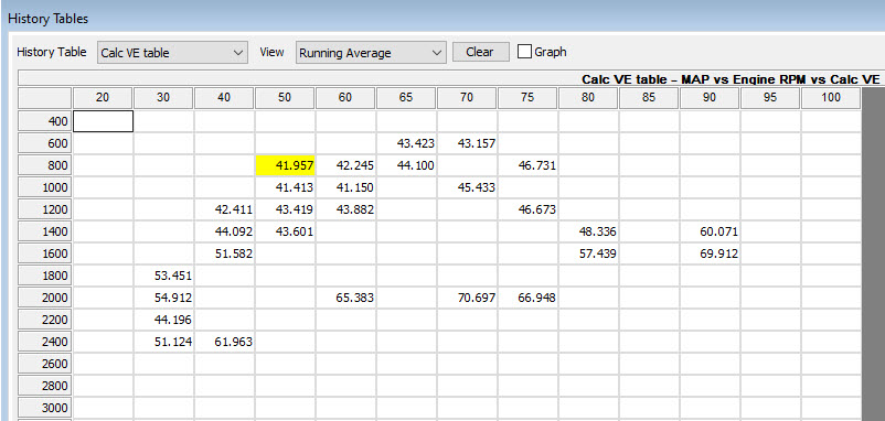

heres the current issue, started the car in the shed today as i have been busy, waited for it to warm up and gave it a few revs. Noticed that it was running incredibly rich (10-11:1) so im now trying to diagnose why. I have attached a log of it idleing with a few peps of the throttle.
Rich Idle Log.xdl

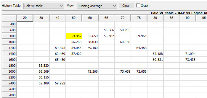

Posts: 10436
Re: Help needed! converting 202 to delco
the computer will only command closed loop fueling when certain conditions are met, and one of those is having the narrow band o2 sensor installed.
so from that log you posted, this is what i can summize.
This is what the current numbers are in the VE table.
This is what the calculated new VE's should be from using the wideband reading and the target AFR settings.
clearly from that its a good ~20% too rich.
use the tuning guides if you need info on how to tune (see the links in my signature)
basically you need to start driving around and logging with the laptop to get the data which will then allow you to tweak the tune, obviously the idle areas you can probably do in the shed at home etc, but much outside that areas you need to be moving, or loading the engine up more to hit those cells.
