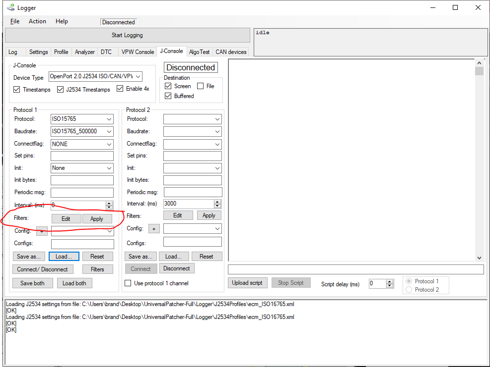

Ok, so I'm not sure what I'm doing with Universal Patcher.
I downloaded latest from github (0.22.6.0) and I'm not seeing the same when following those steps.
The filters is not populated when loading that xml profile. I'm not sure if they are supposed to be or not.

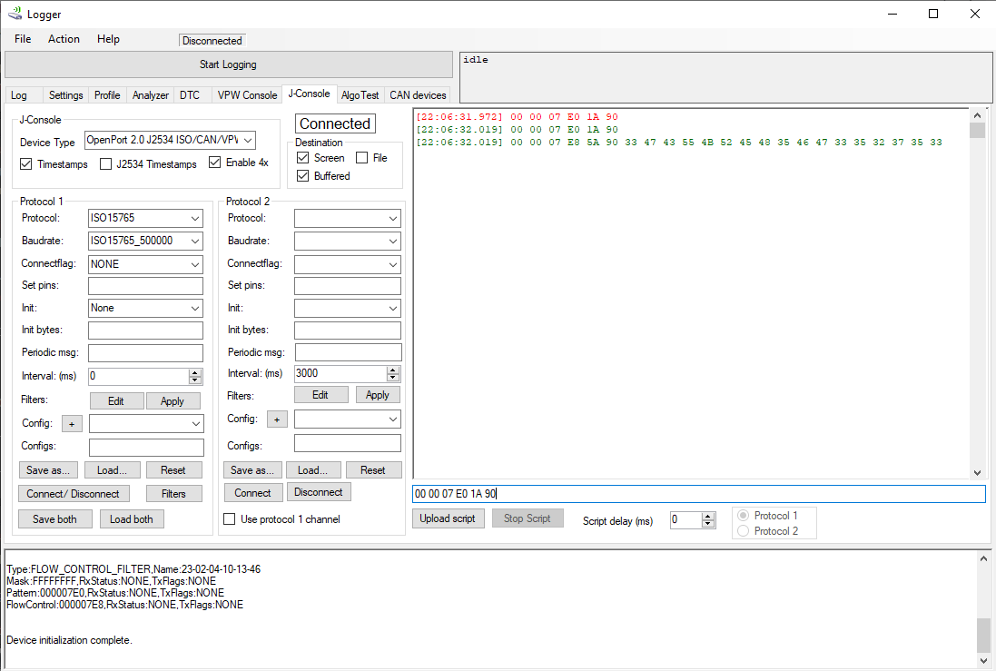

It appears to be working (although I'm still getting the duplicate transmit messages).
This is so much nicer than sending raw CAN messages :)

Try this.. to the right of the config and plus sign is a drop down menu. click the drop down and select LOOP_BACK and then click the plus sign to the left.
In the config box you should see LOOP_BACK = 1.. Change the 1 to a zero so it says LOOP_BACK = 0..
now go ahead and connect and see if that got rid of the duplicate messages..

You can add LOOP_BACK = 0 at configs dialog as ironduke stated.
Looking at the timestamps, it looks like an issue with the openport, like it sends back the request and reply at the same time.
We will need some debug log to filter it, the flags that are added to the duplicate message.
It could be a simple config too, that is supported by openport.

I tried LOOP_BACK = 0 and didn't see a difference. It might be in the openport then, which makes sense about the timestamps being the same.
Also, is there a way to see all the traffic on the Bus even when configured for ISO15765? I might be setting up the filtering wrong, but I've tried a bunch of different ways.
