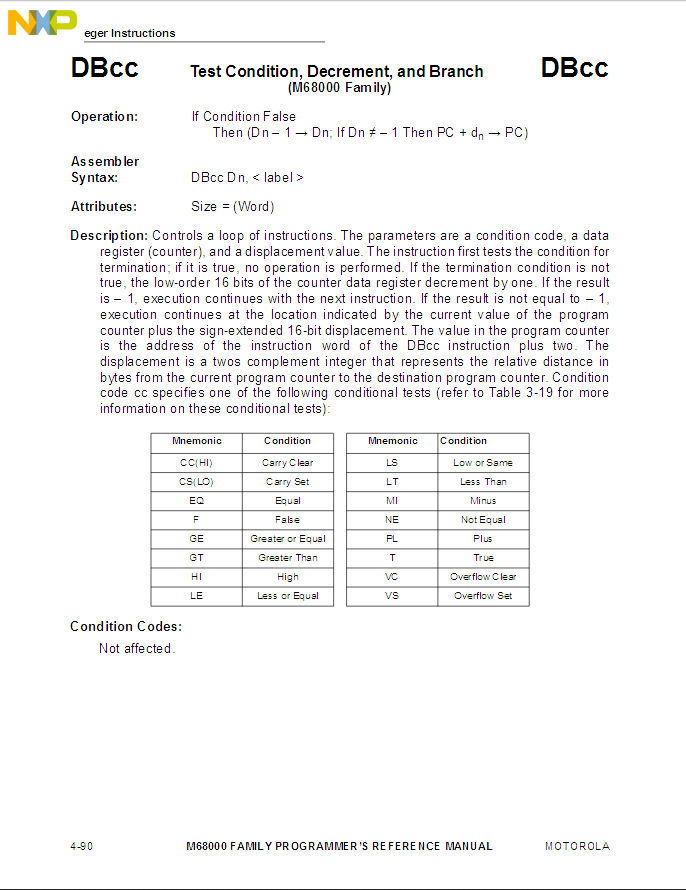

yeah you are right about that one. But 3 of the loop counters did have that fault where the counter is loaded with a 16 bit move.w and then the dbf or dbequ uses the whole 32 bits. Even if the high bits a clear because of other functions that's risky as the function should be self contained to make it easier to develop further without creating unintended consequences later. We both know how hard 68k can be to debug the obscure breakages. We'll get there yet... All targets are working with the full kernel now, but like you described it 'its on a knife edge'. The DLC code is still not as stable as we want. Now I have to break it again and I my goal is to get to the bottom of that so that we don't need any padding or alignment for the data segment as I am convinced alignment is the symptom not the cause, and then see if we are of that knife edge. I know this because I have seen it transmit kernel version where it starts on and odd and an even. I think it's to do with timing, we are driving it too fast and alignment must slow the pcm down by a single clock tick or something to shift the data 8 bits to load it when its on an odd, or something. I doubt we'll ever truly know what's going on at that level, the goal is just to get it stable.
- Posts: 2332
Re: PCMHammer P04
HA HA HA That's funny, there are only two, they are DBcc instructions (dbeq and dbne to be exact) and RTFM! -Enjoyantus wrote:But 3 of the loop counters did have that fault where the counter is loaded with a 16 bit move.w and then the dbf or dbequ uses the whole 32 bits. Even if the high bits a clear because of other functions that's risky as the function should be self contained to make it easier to develop further without creating unintended consequences later.
- Posts: 10111
Re: PCMHammer P04
Well you learn something every day. I always thought it was universal that instructions without the size qualifier was 32bit. But that does explain why IntelEraseSector has:
eg using subq.l and bne.s rather than dbf which did make me wonder why it was different, but I decide to trust it and move on figuring it worked and I didn't need to touch it at this stage. Now I see, dbf wouldnt have been able to handle the 24/32 bit counter.
move.l #0x320000, %d2 | Erase Loop Timeout index
<sniP>
subq.l #1, %d2 | Decrement index
bne.s IntelEraseSectorNotReady | Fail Status Check Test again
