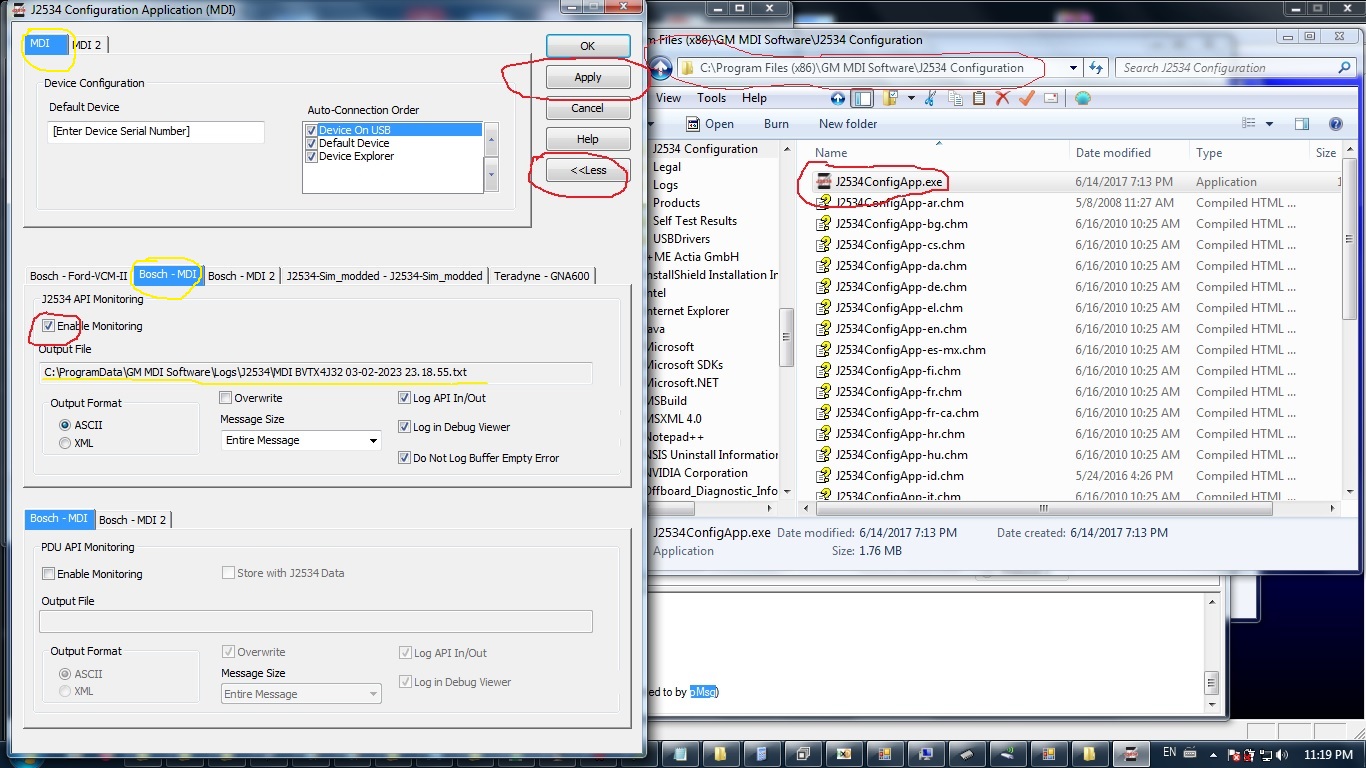

Here are some presets configuration for connecting j-device with universal patcher.
first is in raw can it will open connection and set filters for communication with all modules on bus, but filter idle data.
second is to connect to bcm in iso15765 protocol and send and recieve data.
Use the load button per the screenshot to load the configurations, select device and click connect.

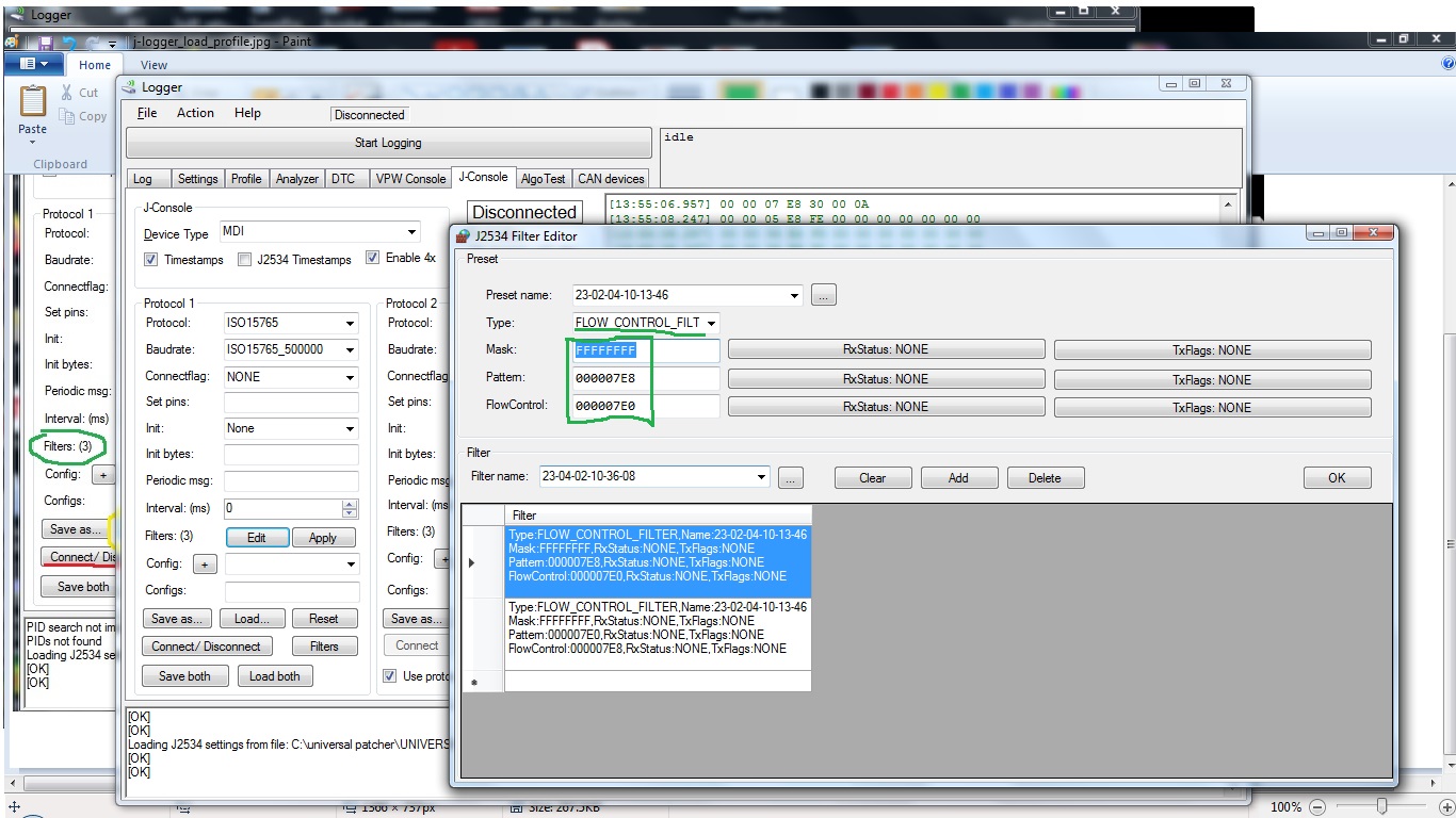

Looks like mongoose is POS and don`t support what mdi does, Anyway you can try removing one of the filters
Go to filters: and click edit button, Than select the box with this filter
Mask:FFFFFFFF,RxStatus:NONE,TxFlags:NONE
Pattern:00000241,RxStatus:NONE,TxFlags:NONE
FlowControl:00000641,RxStatus:NONE,TxFlags:NONE
click Clear button , than OK.
Than when pop window closes click Apply next to EDIT button
save config and try again.
If still errors delete the other flow control filter, leaving the other.

Here is the test config if you want to test it.
Some screensshot.
In case you want to log PRogram->j.dll communication and how filters are set
Use the second program from screenshot, than open the log file and and can find how a j2534 program sets the filters
for example

Than you can set the same filter in universal patcher with that arguments.

04colyZQ8 wrote:
kur4o wrote:Looks like mongoose is POS and don`t support what mdi does, Anyway you can try removing one of the filters
I cleared both filters and now it says this ..
Loading J2534 settings from file: C:\Users\jake_\Downloads\New folder (11)\UniversalPatcher-master\Logger\J2534Profiles\ecm_ISO16765.xml
[OK]
Loading J2534 settings from file: C:\Users\jake_\Downloads\New folder (11)\UniversalPatcher-master\Logger\J2534Profiles\bcm_ISO16765.xml
[OK]
[OK]
J2534 client initializing...
Initializing J2534 Device
J2534 client: Device initialization fail.
Connected to the device, ID: 1
Error, j2534Client line 534: Object reference not set to an instance of an object.
Protocol2 have connection from client
With iso15675 protocol you need to set at least 1 flow control filter. No filters= device initialization failed.
Test the file I attached earlier.
With CAN_gm_query.xml config you can send and recieve data from all modules connected on bus using raw CAN formatting.
