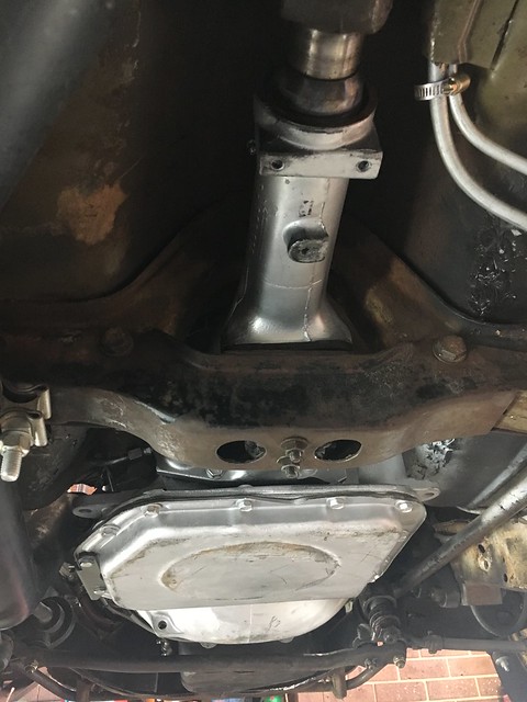

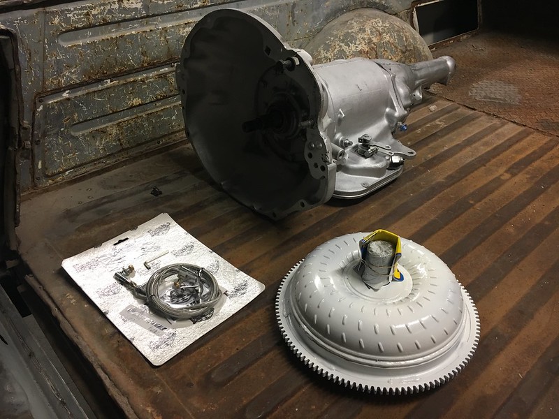

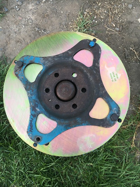

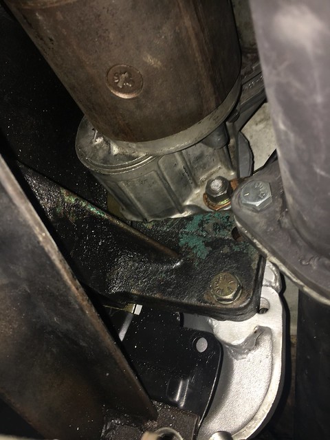

Hi all, finally got a decent trans for the ute. 904 Torqueflite with stage 2 shift kit and 9" converter. This has been modified and a BW35 starter motor donor section welded in. Its difficult finding any parts for the hemi 6 torqueflite combination so I ended up having to buy a 6 bolt small block flexplate to suit a 727 and had it machined down to the 904 size. It also needed an extra hole drilled because the small block 6 hole flexplate 's have one offset bolt. Luckily I had a small block starter motor lying around as the ring gear needed the larger starter motor gear. Hopefully it should be driving by next weekend.
