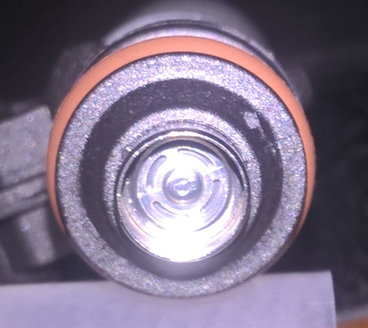

yeah he does good work, i think these injectors tested his rig nicely
Re: My Delcoed Rides
Thats fantastic, sooooo much fuel! But also like you say low PWs actually look better than the dekas.
yeah, heard alot of good stuff about them, so was keen to get a pic while The1 had them
nothing like a port hole into the engines internals! im interested to see if any part throttle driving improves at all, not that it was ever too bad or anything.

Can you run them straight of the delco with out an injector driver? Sorry for all the questionsHolden202T wrote:you can find them here http://vpw.com.au/Category/Index/5748
i didn't really want 220lb's but i needed over 110lb (going off current fuel supply) so they were the next step
Jayme tells me a mate has tuned them on a streeter with E85 and they are good on low pulse widths so they should be ok for me, and probably only need 60-70% capacity at 45psi (plus boost rising pressure)

yeah its a high impedance injector, so itll run straight up on a delco.
only need drivers for low impedance injectors.

Do they have diffuser plates or are they a straight ball and pintle?

yeh they have a plate, it's not hole type but 4 slots around the outside, so like a garden hose but helps it diffuse it out a bit so you do get a spray pattern unlike the dekas straight shot.
got a pic inside the end, its not the best, but its un-believably hard to get a good photo in there!
