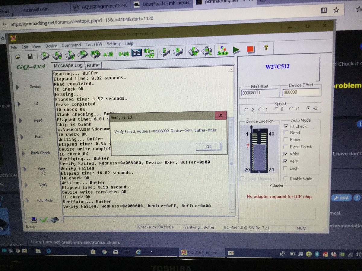

Hi all, I must be have the offset wrong. I have a 512k eprom and entered what I thought was an 8000 offset but got a verify failed message. Any ideas? Thanks
Also is it correct that an Eprom can be erased in GQ USB program and that it doesn’t need a UV eraser. If not that may be my problem as the first bin I burnt worked but I didn’t have the offset entered. Cheers

I think its becasue you have set both a file and device offset of 8000 which basically will run the code off the end of the eeprom address range.
When you select the device leave everything default, upon opening the BIN file from your PC it is there on that window that you set an offset of 8000. It should work fine from there.

Thanks for the reply I only entered the file offset this time. Strange I still get an error but now the address is 0x008001. If I can’t get this working I will try stacking.

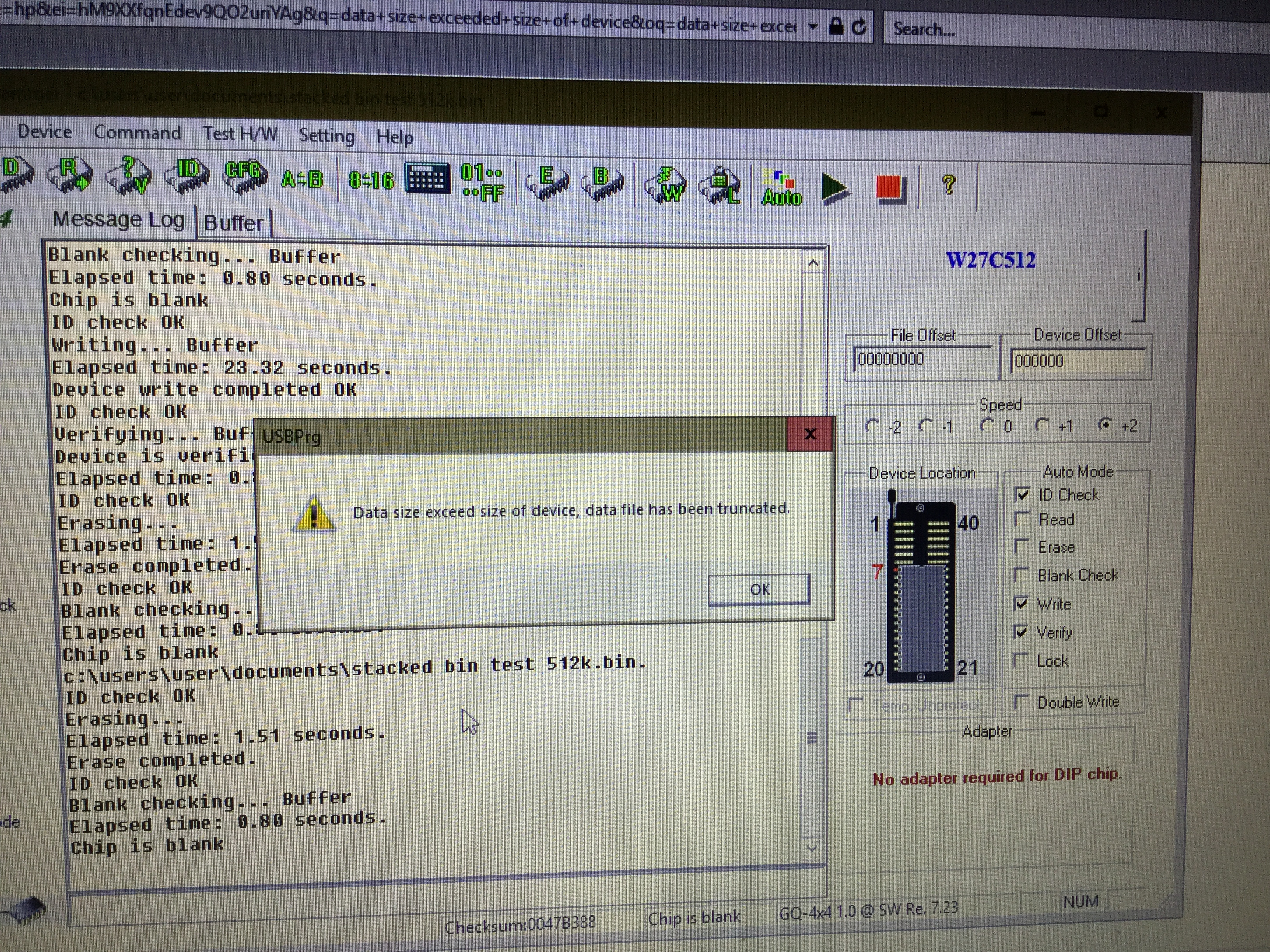

I stacked the bin in TunerPro and the file size shows as 512k but get this error when writing the file.

Windows need a to show 64k to fit a 512k memcal

Thanks but now I am really confused. So I should only stack the bin twice in TunerPro?

Looks like a VR auto memcals being a 512kb?
12P stack once so windows says it's a 64k file.
11P write straight up.
Google difference between bits and bytes and see what you can make of it

The software will be able to erase an EEprom only
An Eprom will need the UV eraser still
