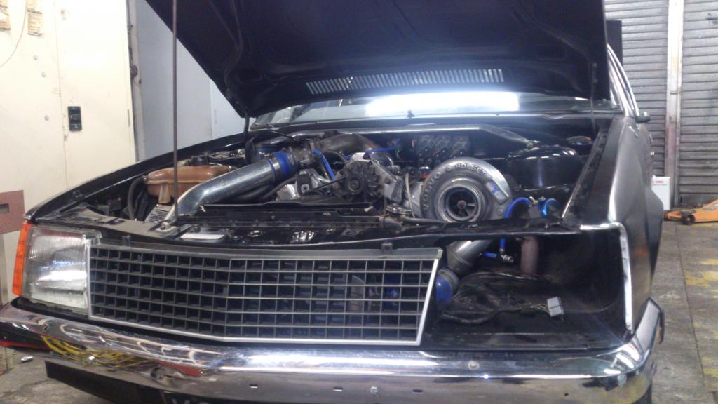

Re: DELCOS NEW RIDE
one 90 degree silicon joiner away from boost test of the new big bad boy
Re: DELCOS NEW RIDE
bigger turbo ?
- Posts: 5709
Re: DELCOS NEW RIDE
Yep hx52 holset it's in the 700-1000 crank hp range in holset
Dazza92VP
- Posts: 608
- Joined: Sat Jun 05, 2010 11:59 pm
- cars: 92 VP V8 Wagon
- Location: Perth
Re: DELCOS NEW RIDE
What did you steal that off a fh16 globetrotter its big enough
