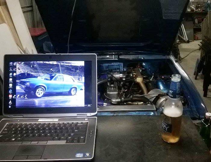

Final preparations for the dyno tomorrow morning

the only reference in that photo is if you ever want to buy me a beer that's the one to get
it is Friday arvo so it really would not be complete without a beer, plus its the best thing for washing methanol fumes down

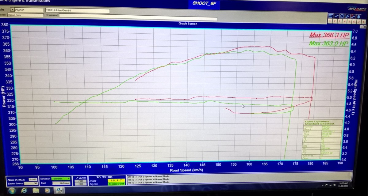

Good morning at the dyno
converter is a bit tighter than before now and the new injectors are on 64% DC
started off with the tune really fat and it was missing a bit, so backed it off a heap than reeled off the 363hp run, then took another 5% out and that's the 366hp run.
the fuels not perfect but its pretty close now and I'm happy that I can take it to Gunnedah next weekend and know its not going to get torched!
the interesting thing is going from the two AFR's its really not making that much more HP running it leaner, so I'm happy to leave it on the rich side!

That's got to be one of the toughest 202's out there ! How much work to get it to 400 ? Go and have a beer, you deserve it

not sure about that, theres plenty of more powerful ones, but its the toughest I've ever had hehe
400 ... well I forgot before I went to the dyno to screw my wastegate screw in, so I ended up running 3-4psi less boost than I usually do on the dyno, and still made ~20hp more, so I know theres more in it, weather that's 10 or 40 hp I don't know.... but I don't want to lean on it too much more for the moment, get it into the FX and make it all work then worry about turning the wick up
