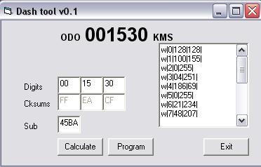

The1 wrote:programmer looks good festy, have you worked out why some numbers will display and others wont with the same checksum calc? I havn't had any luck
All going rather well actually ;)

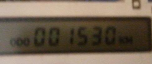

I got a bunch more done to the software on my train ride home, to the point where it's useable and generating complete (and valid) bins and dongle instructions.
I just need to add comm port and send the output there instead of printing it, but at even as it is now I can type in a odo number and program it in under 30 seconds, no more calculations and translations finally!
As a test, I picked a couple of the numbers you couldn't get going - 1529 and 1530 were two I think...
