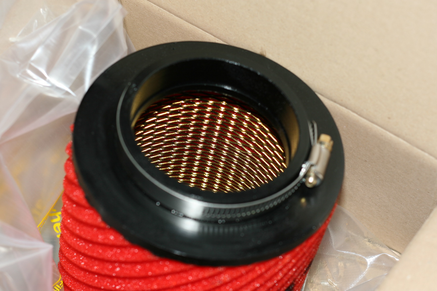

Received the new Uniflow filter and have installed it, the filter foam is about 1 inch thick, the foam is completely soaked with oil out of the box :) and the oil they use is very very sticky.
Very solid construction and quality, the filter foam is actually sealed on the ends into the rubber, so there are no gaps or holes.
Here's a photo inside, has steel mesh.
Fits nicely into the pod box and still room for the washer bottle.

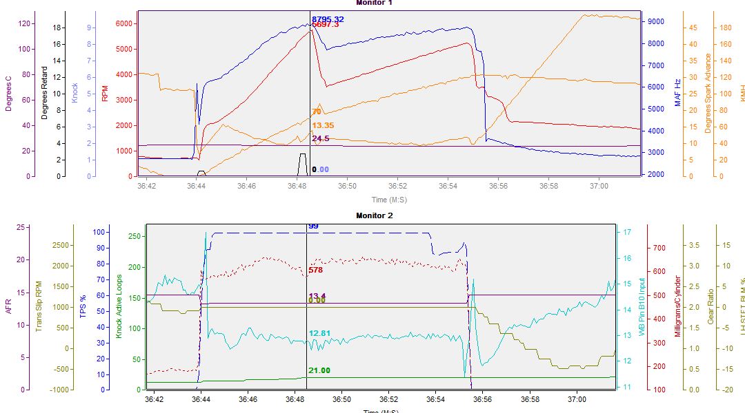

Now here's my old performance graph MAF 8800hz CYLAIR 578, though i have seen 8900hz on a sub 10c intake.

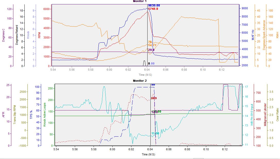

Now here's the uniflow and with hotter temps 29c and richer mixture as i hadn't set it back to before when i was trying to fix fueling on stock filter, but clear difference in flow MAF 9039hz CYLAIR 609 and also Cylair at 4400rpm has gone from 667 to 687
So not exactly what i was expecting, would have thought the cotton would flow more than foam, hopefully kill two birds with one filter, better flow and filtration!
Defiantly better than stock restricting to 8400hz.
