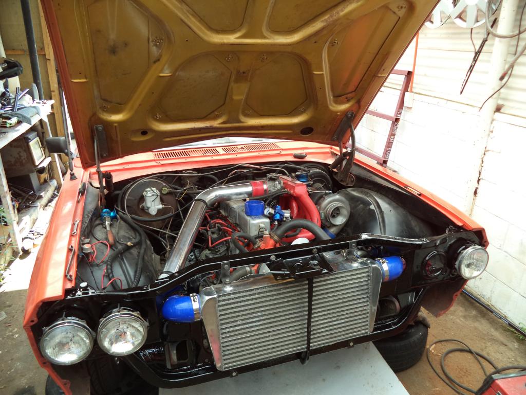

im running a 202 with flat tops and big turbo.spools near instant but we have a tow style cam all down low grunt falls over around 4500rpm .it blows head gaskets too easy from the massive amount of air/grunt at low rpm.off boost its far gruntier than a 202 n/a LOL

i built this for a mate but its far from reliable yet LOL sorting teething issues and the 2nd blown gasket but it goes hard on low boost but flat tops and the tow cam shoving air in at low revs is just making stupidly high combustion pressures and the gaskets just wont hold it in.

In all honesty I'd hate my setup on a daily driver, it boosts way too late but has the mid to top end I need for a race car!
That said I'm sure a simple street cam change and suitably sized exhaust housing would make a killer street combo!
I've been wanting to try a eBay gt 35 with .63 ?? Exhaust to see how much sooner that spools than my .82 exhaust ... Just need the spare cash to try one one day

i have a 0.63 that would probably fit straight on yours worst case need 1mm taken off in a lathe and it will fit.im looking for a 1.06 housing

That setup ^ is what we're probably going to be doing. Un-modified VK EFI inlet with a made up ex manifold (maybe we'll try and make one from a set of VK EFI extractors and some hard work! What sort of static comp is that thing running? and what sort of head gasket? (hopefully i'll be ok with the copper gasket, ARP studs and slight de-comp)

I've been running 9:1 comp with 15-20 psi and methanol on my 202 with minimal issues with acl race series head gasket, but that could change with petrol!
I think your horsepower figures are achievable
