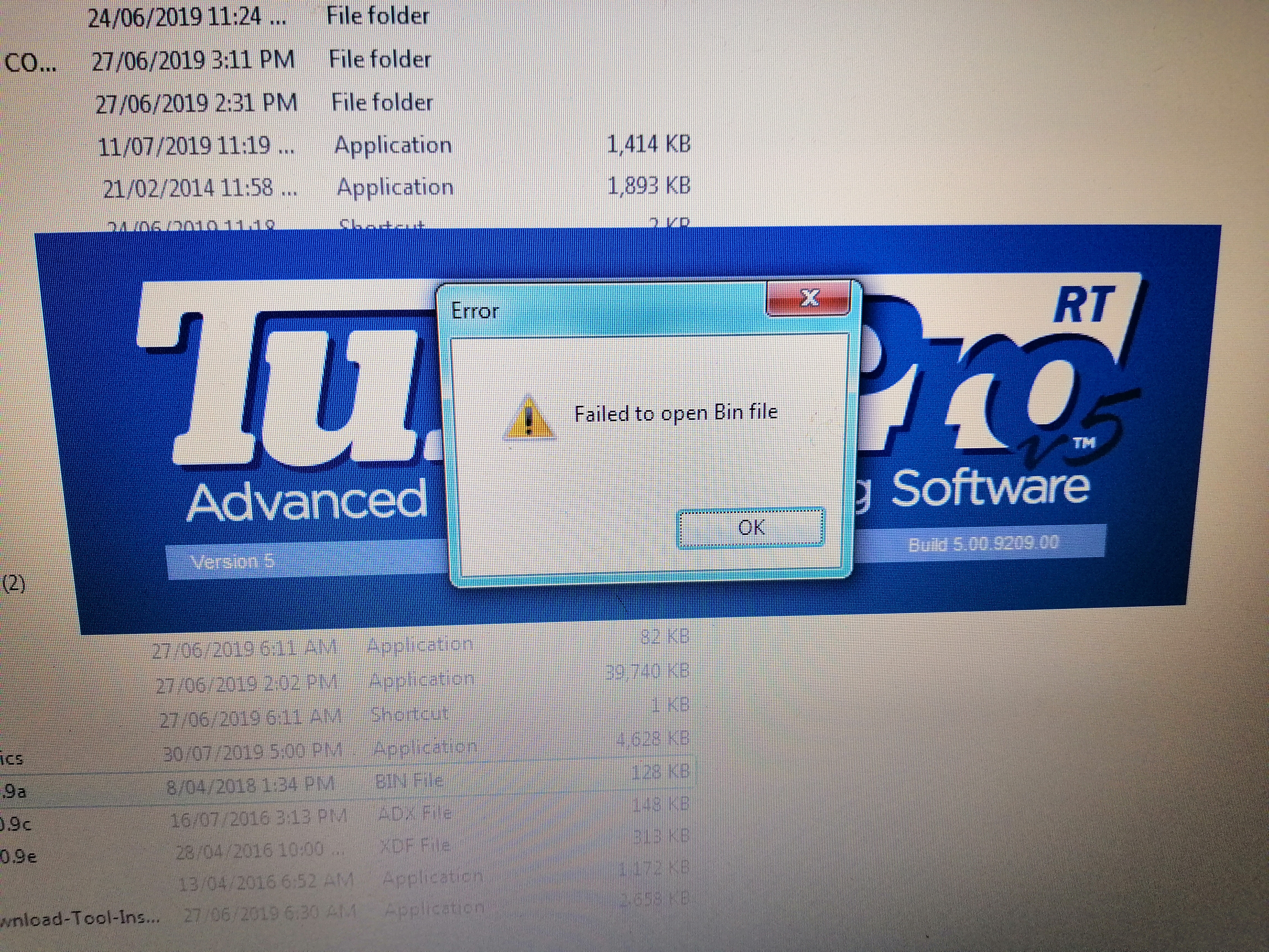

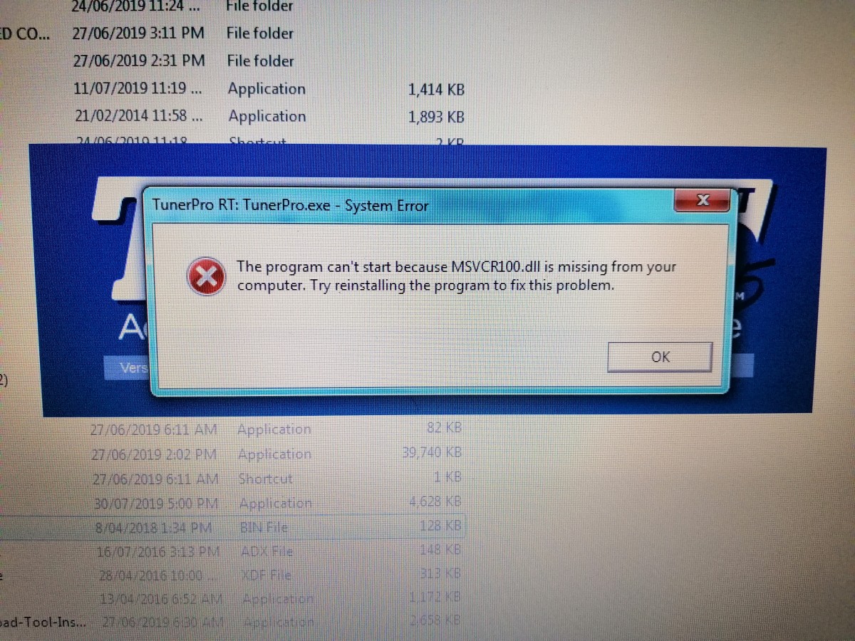

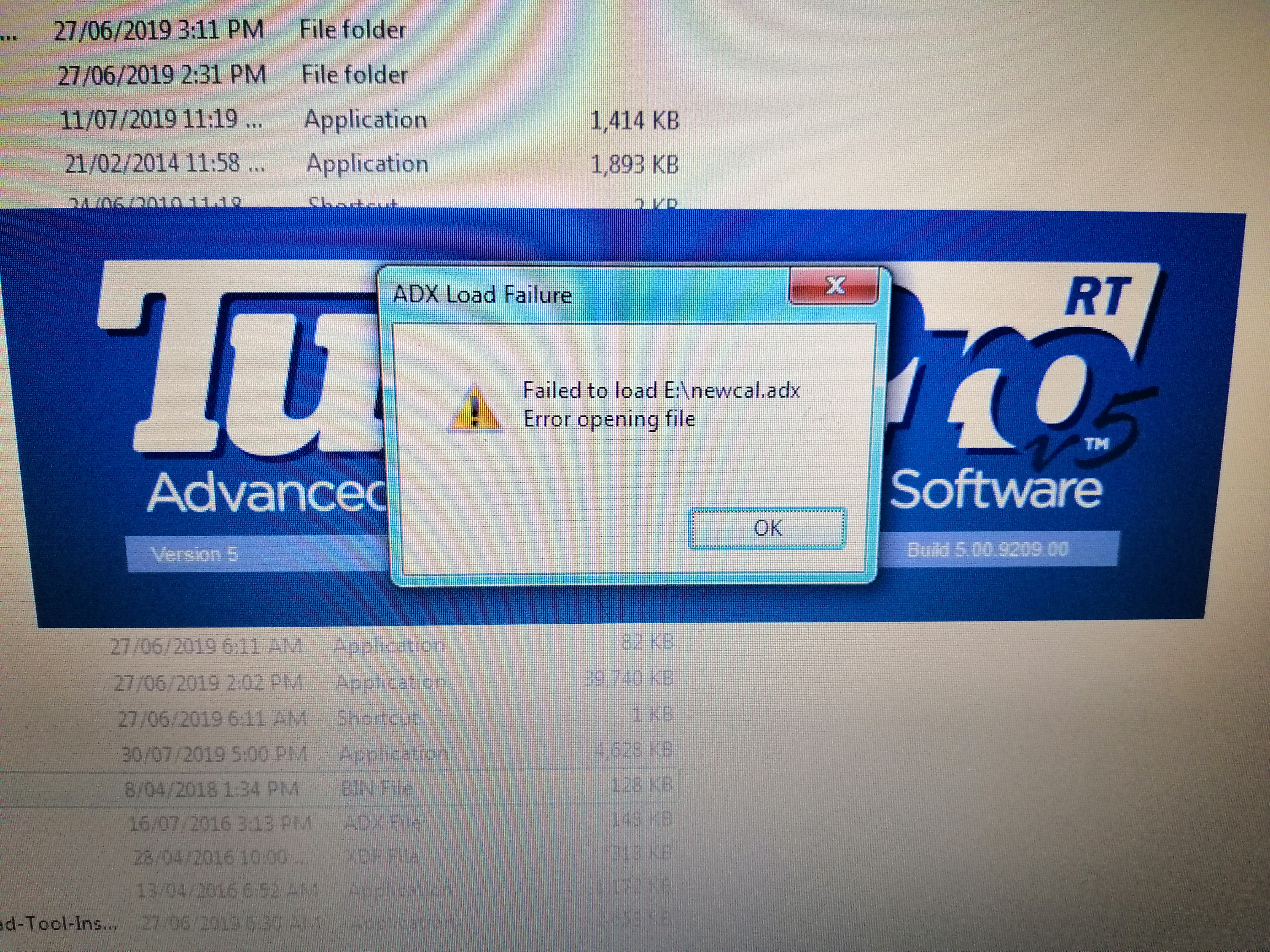

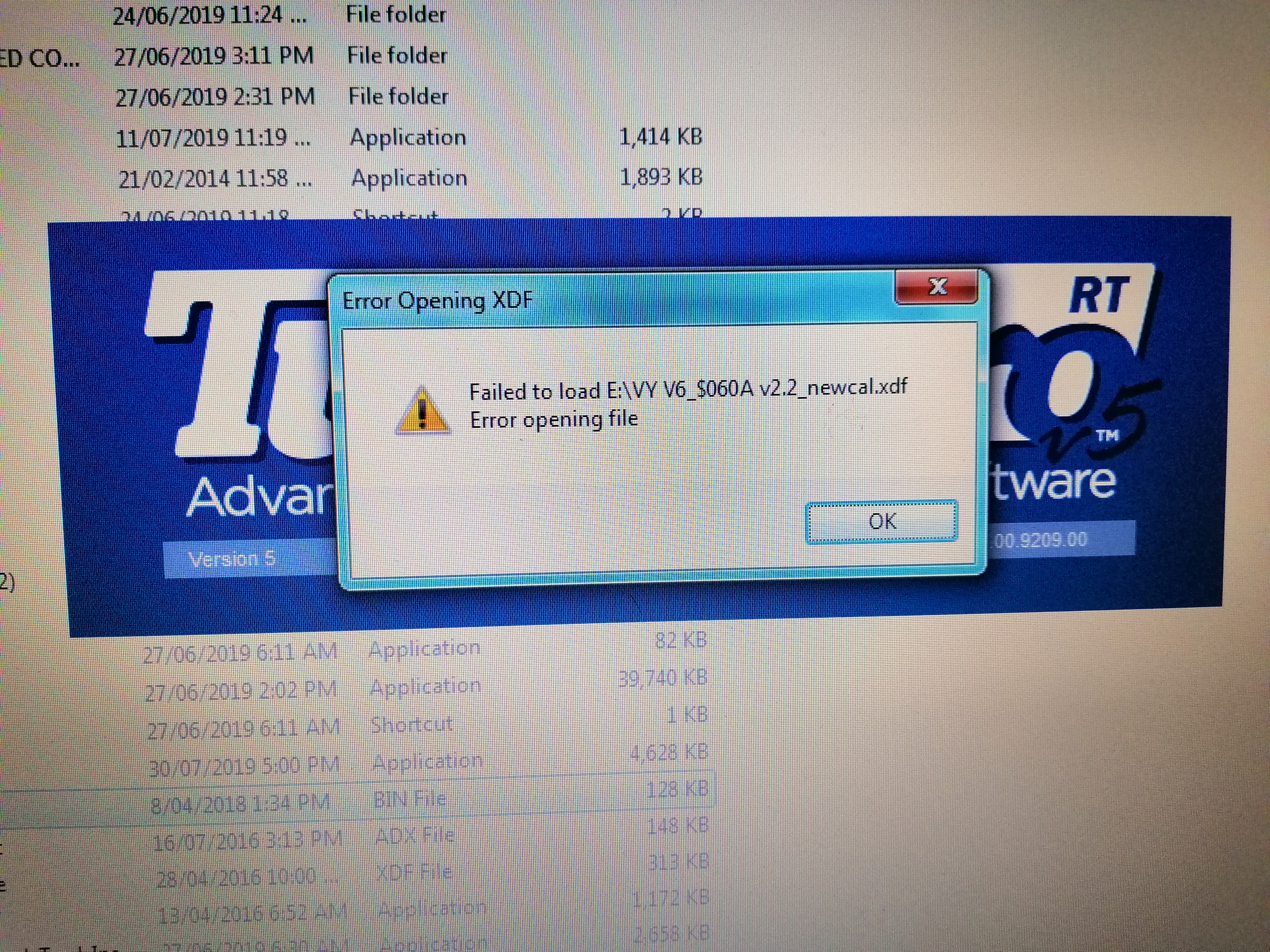

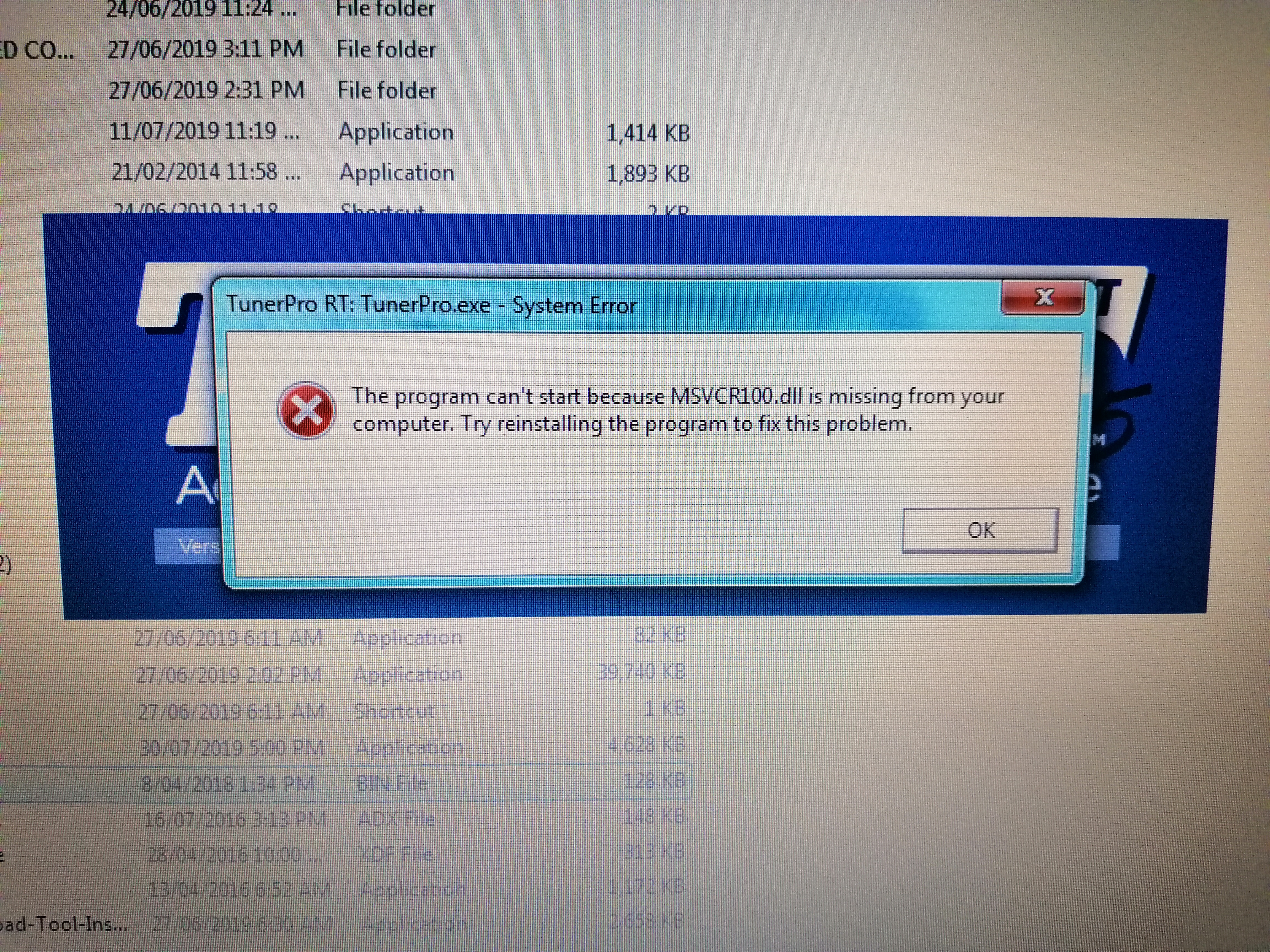

I also get these error messages when trying to open Tunerpro, Does anyone know what's wrong with it or is it my laptop lol
Posts: 5709
Re: PCM questions regarding L67 Swap into VY
Your bin xdf and adx that you last had open have either moved or been renamed or were on a USB stick that's been removed so tunerpro couldn't automatically open the last files. As for the other error you will be missing Microsoft Visual C++ 2010 Redistributable Package antus shared a link here it's needed for the tuning plug in

Thanks for that, I found the new link and updated the post. Now I have to pick a country, I linked en-au but its the same file. Other way to find it is just to google vc2010 redist
To get rid of the files that are missing error, load a bin, xdf and adx from your pc that will stay there, then exit tunerpro. Next time it'll open those instead of throw the errors. Thats an annoying TP quirk that has been there for a long time. It'd be nice if it was fixed. I flagged it with the author must have been 5 years ago, but I guess it slipped through the cracks.

All good got the download from Microsoft and is all good now
