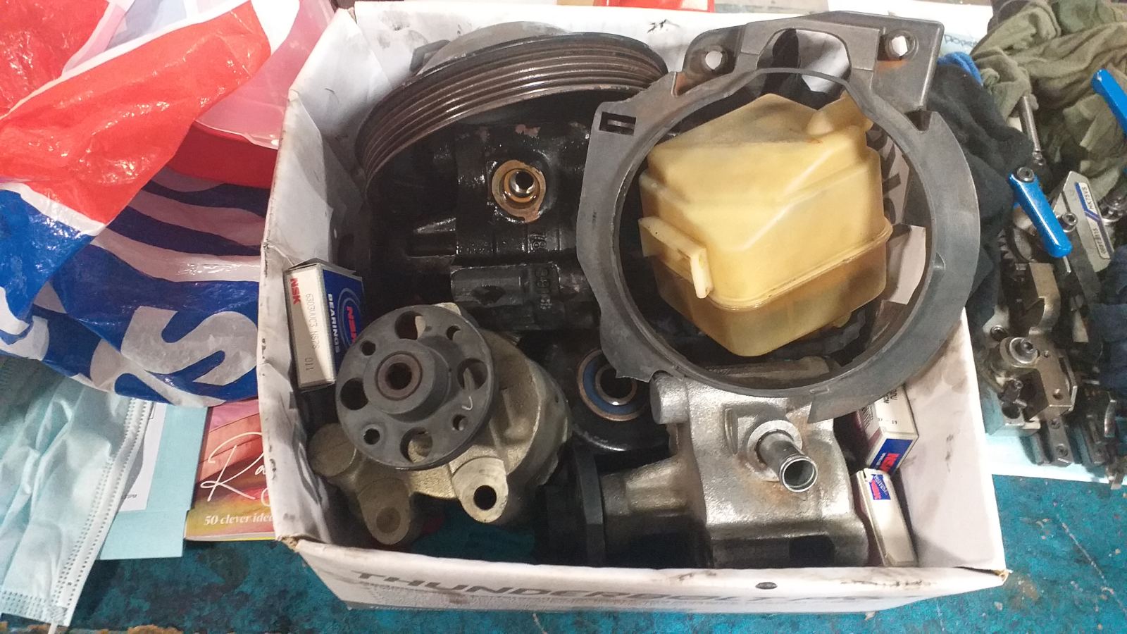

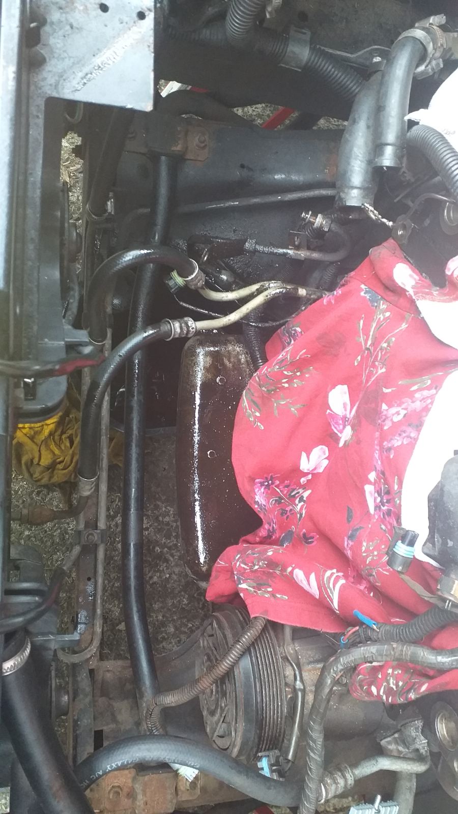

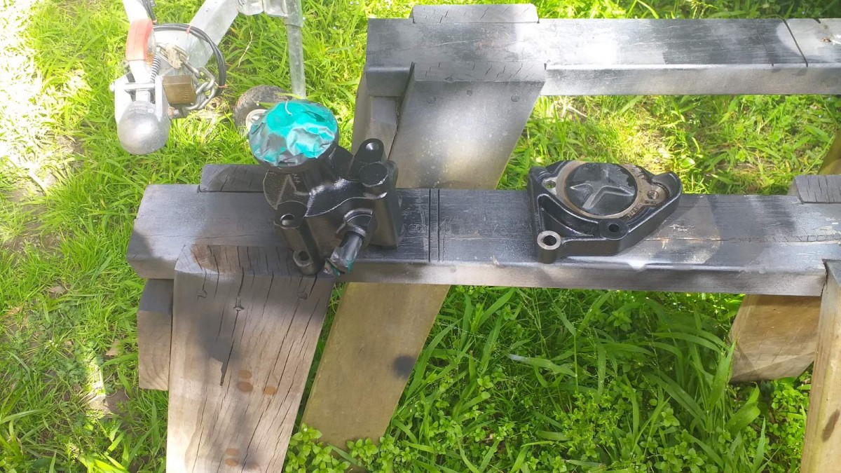

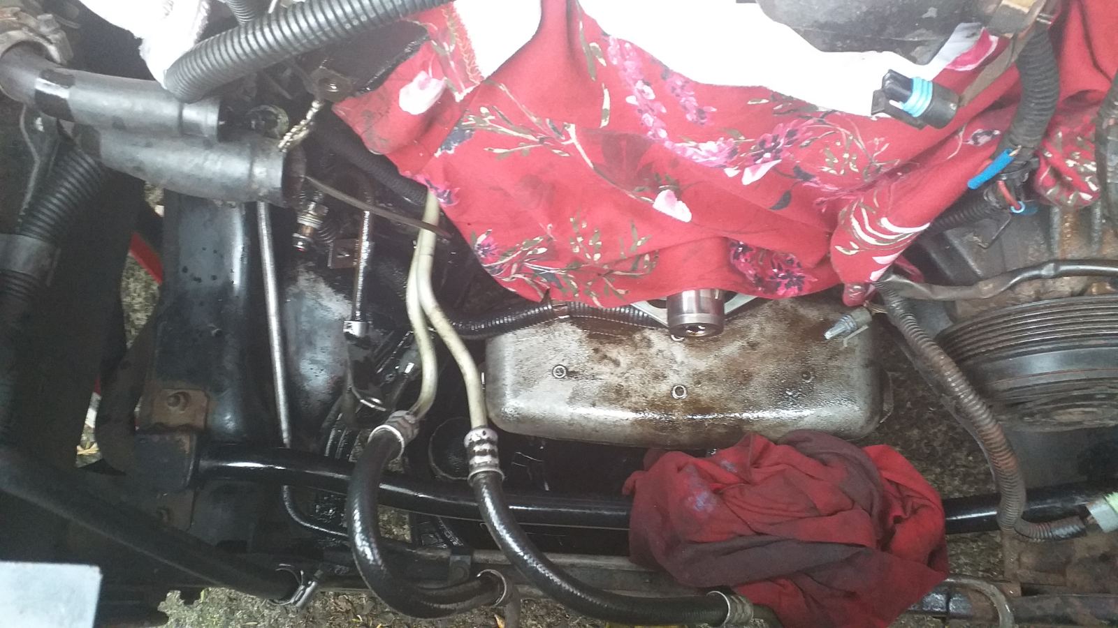

Never mind, got the PS pump out and a few other bits and bobs to take to work Sunday night for a bath. At least it's fairly obvious where the PS fluid was leaking.
0-02-07-68b5f192757992e6c61632576cbd39bb94fa2dece78e19adc2b47e88bd33f991_fb977e334bc5bbfb.jpg

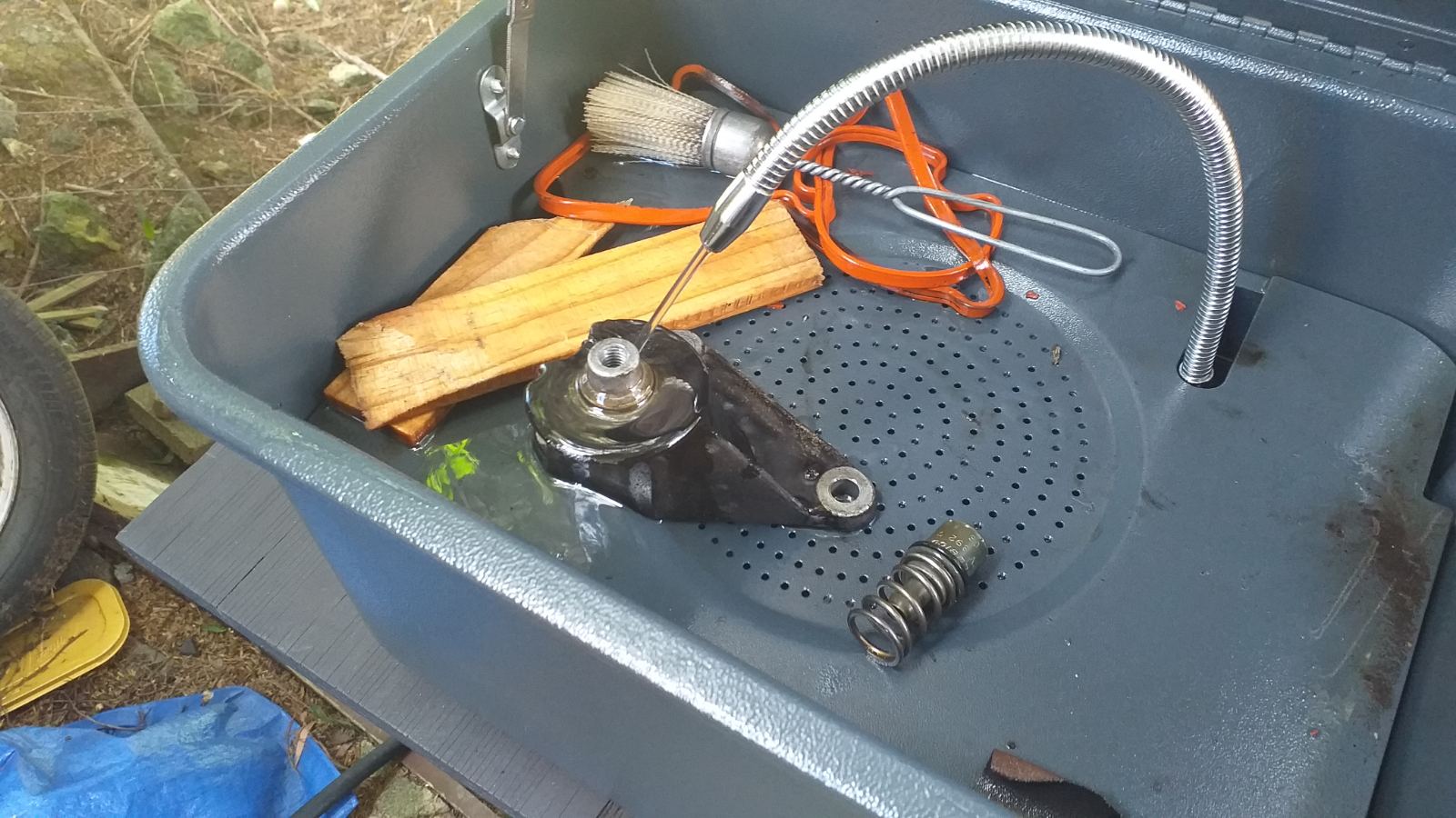

Then started cleaning up a bit. I spilled some ATF taking out the pump, it seemed to clean and wash away some grease/dirt so I used the rest of the ATF in the reservoir to soak the other built up crap whilst I did a quick little job on the Calais.

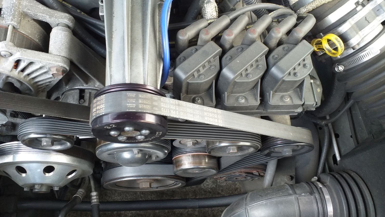

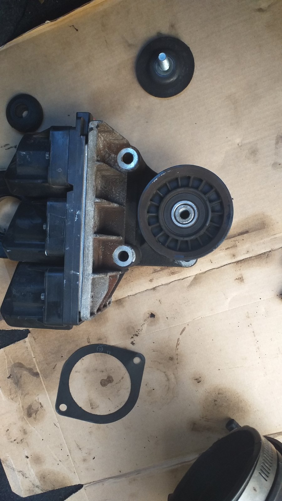

The Calais started making a weird whirring noise on cold start this week, Initially I thought it was the PS pump but when I popped the bonnet to give everything a once over I found this (belt had jumped one rib over).
0-02-07-c40c24225ccb9637c06cc3531563e6d48b41ee0bbd1aee6143cf15c614ffa986_686ab7d1dd836fcd.jpg
I keep spare bearings at home so I pressed in new bearing on the Tensioner and grooved idler pulleys for the SC. Hopefully that gets rid of the noise and keeps the belt in the correct groove on the SC pulley.

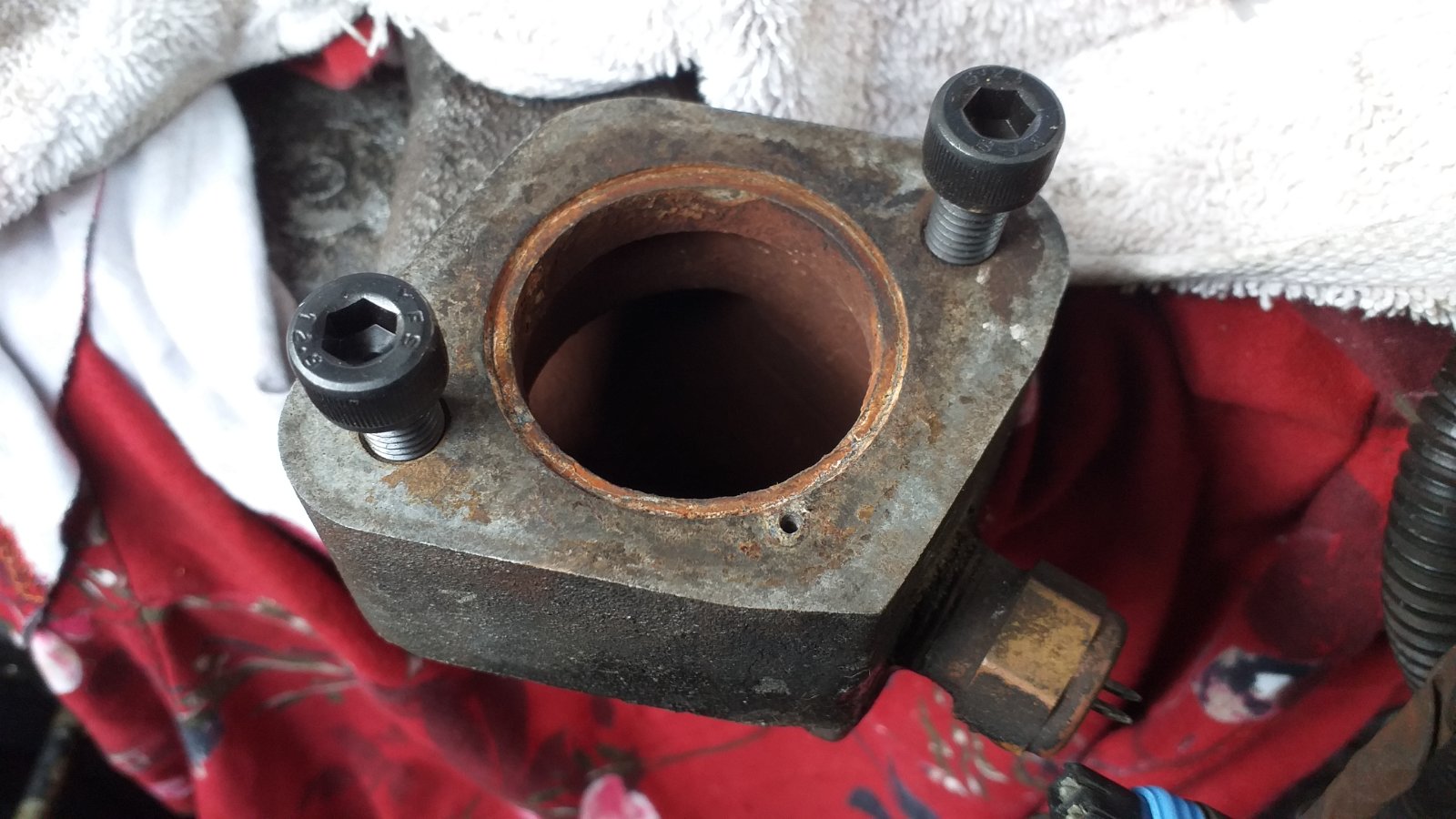

Whilst cleaning I also discovered something I never knew. On the lower thermostat housing there is a small hole to bypass the thermostat. I'm going to assume the factory did this to help with bleeding the cooling system, mine was fully blocked but a minute with a small drill bit sorted that out pronto. Learn something new some days :)

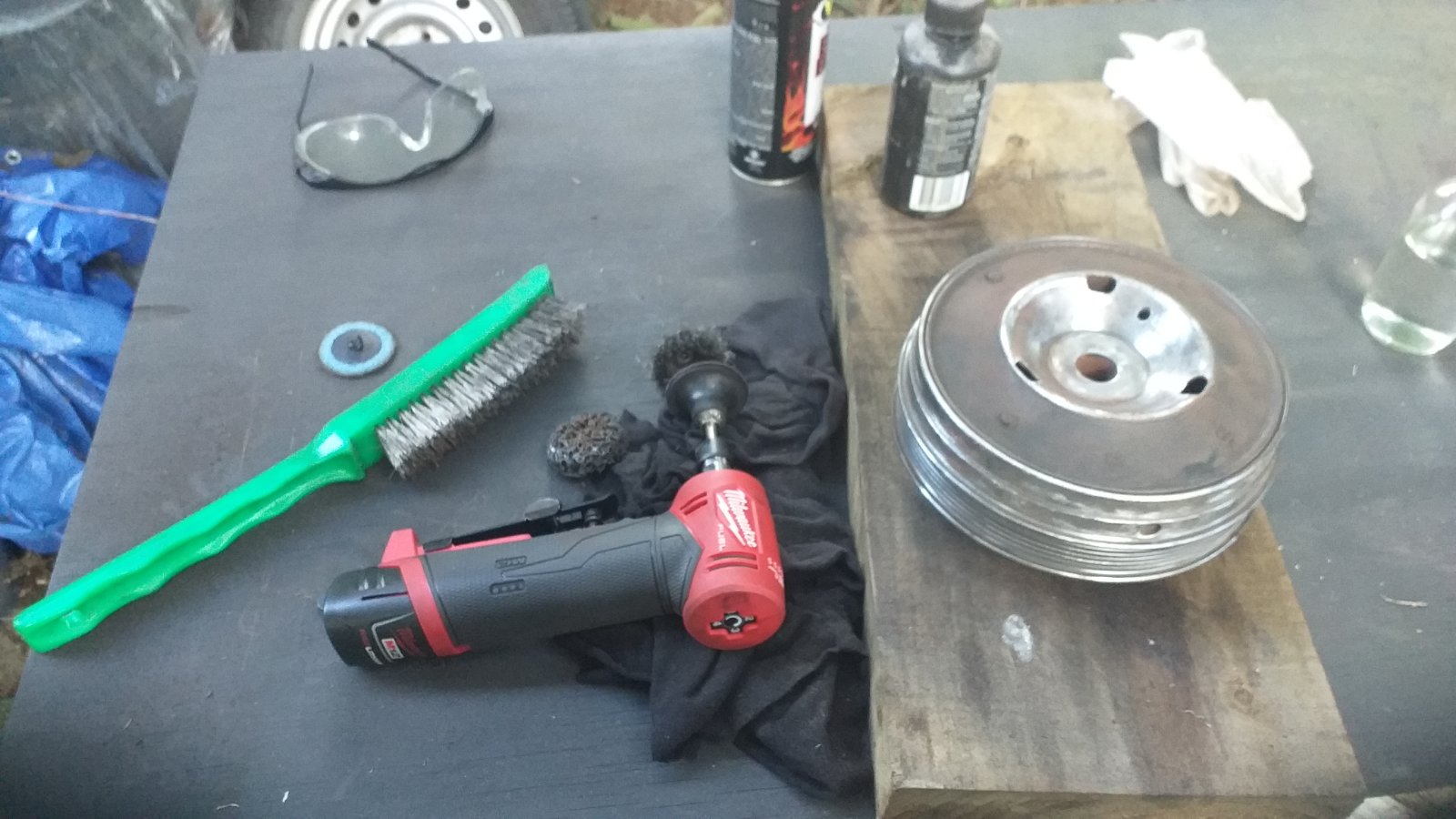

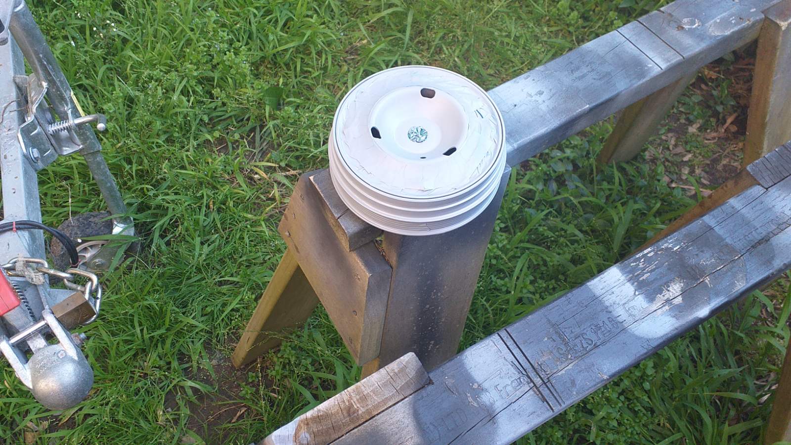

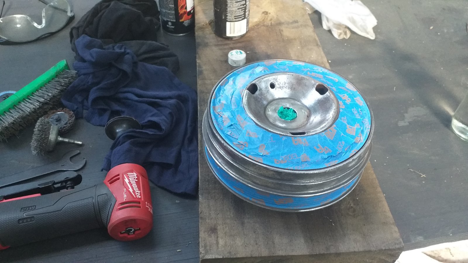

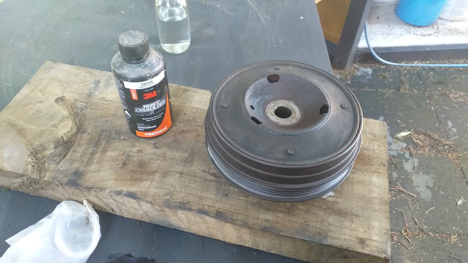

Got a little restless today and decided the balancer needed a birthday. Started off with a steel wire brush and some rust kill/neutralizer but didn't like how that came out.
0-02-07-8f962bf3d02edc701c9757e668333955a861c59d13f8b9965ebc46ecb137727b_1db59e9d98cb6678.jpg
So I got a little more industrious.
0-02-07-d47f4a9b0978dd40cf24f9fcbf13b785bbfb4027bc009fbb48eb7c565ca15e4d_968d71070de1d226.jpg
A quick masking job and we're ready for a splash of paint.
0-02-07-2482bcdc623007091de0a8430ea288dde2eb8ea8d2a63b9a897255e6053375fa_63286fa2fbdf928a.jpg

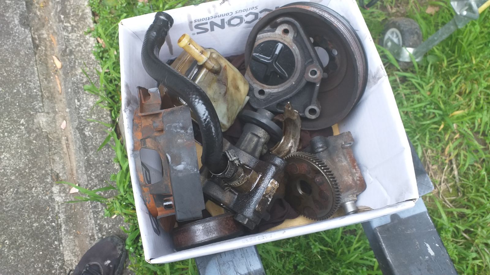

Managed to get all my bits cleaned up at work
0-02-07-995187294200bc360a8d2aef8a3addc407b33d7bad355eac7390e1c82a718f4a_56ca8e174162a9.jpg

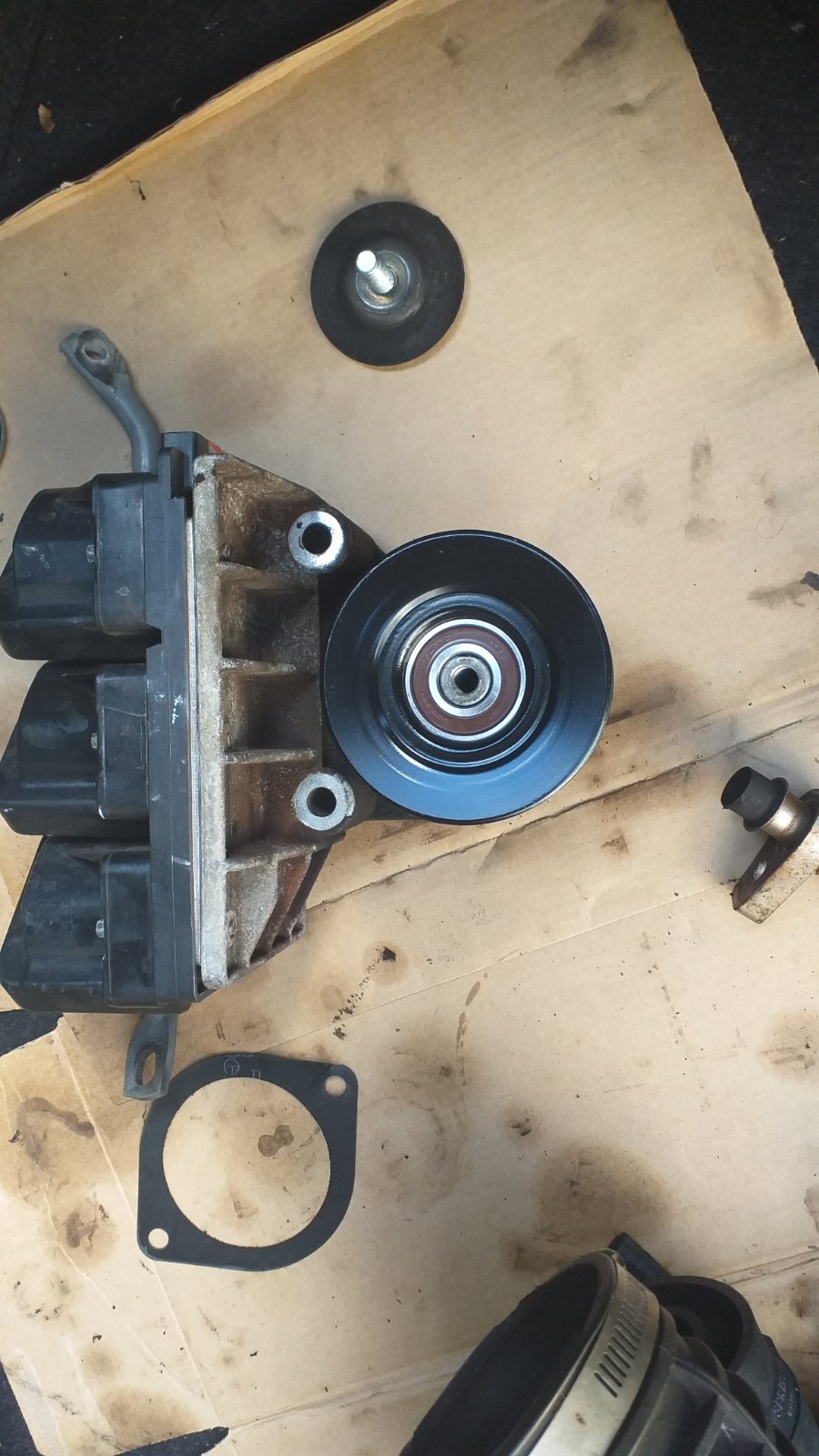

Then I remembered there is another idler pulley so went digging in the boot of the car, found it and it's an OEM plastic pulley with a rattly bearing and a dirty mount that needs cleaning and painting. I did find a spare in the garage, the new steel kind but a slightly larger OD. A quick mock up says it should be fine.

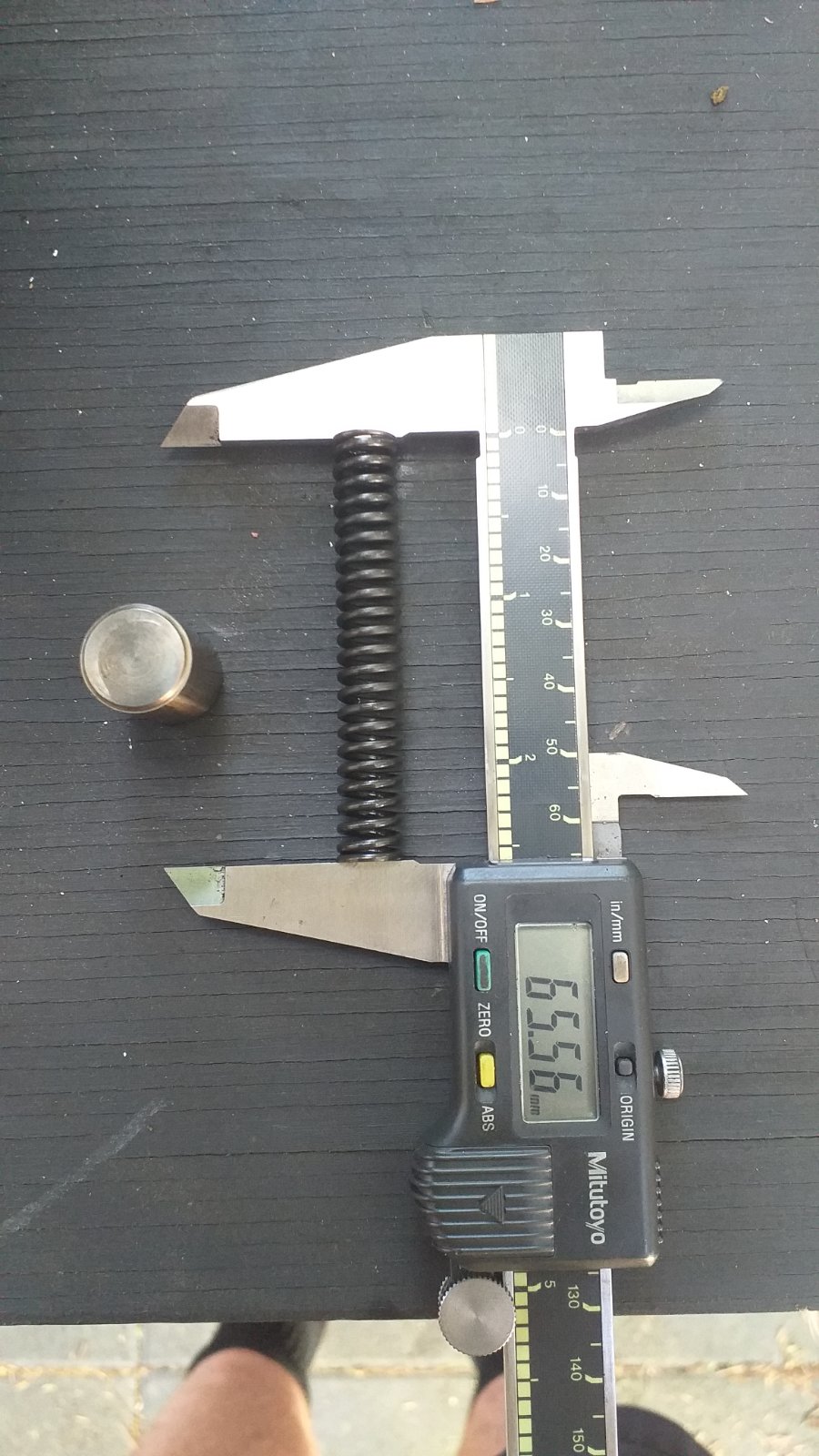

And may as well check the free length of the oil pressure bypass spring.
0-02-07-6e3a02a269e7b204a8a832b28fb938d9d188a2e1901be3b1f626ada975af7775_28bece0e191ac1b8.jpg

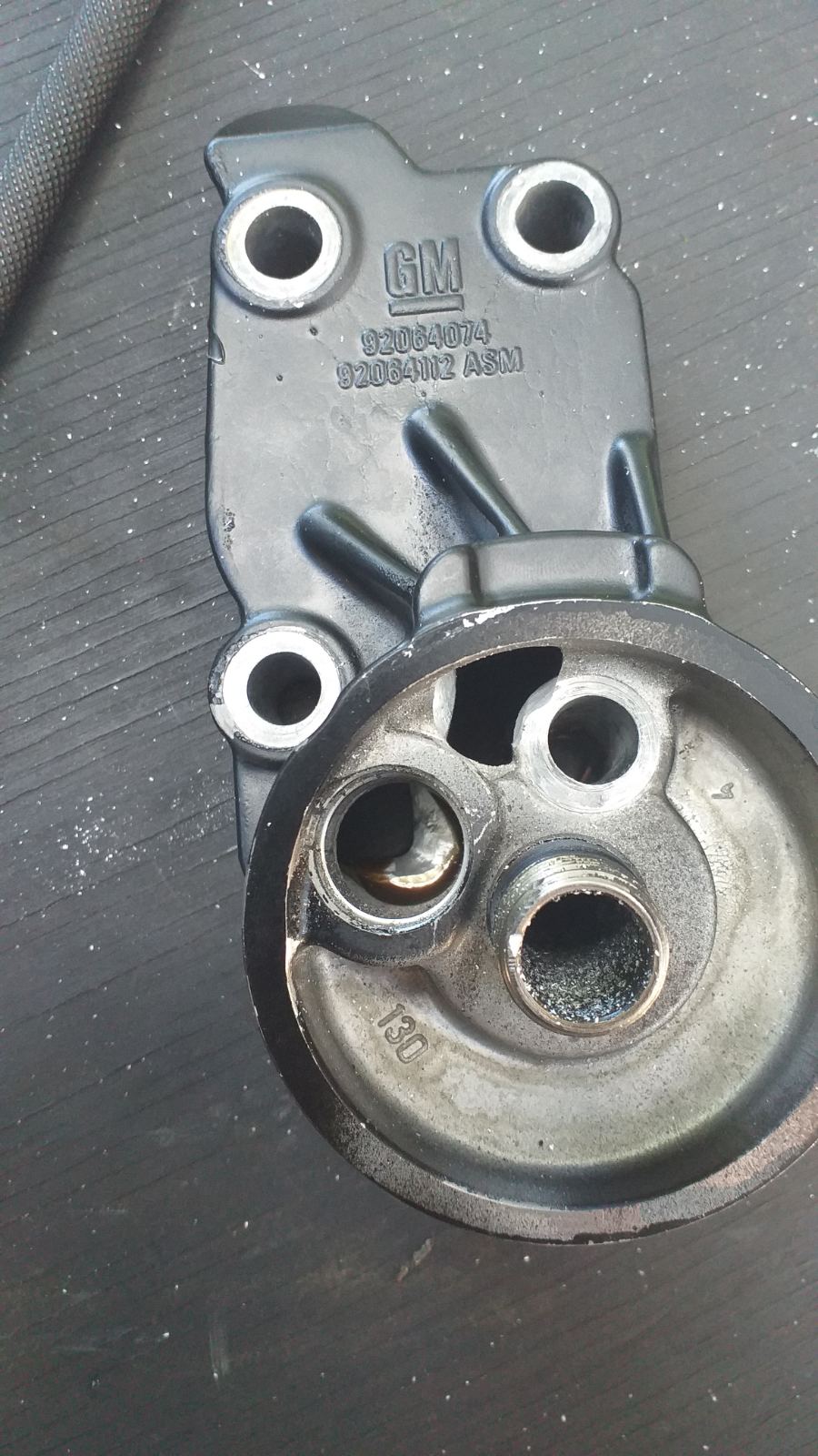

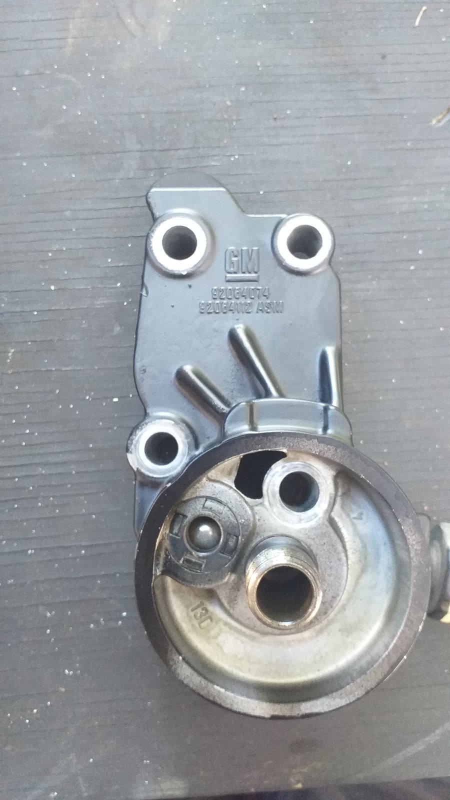

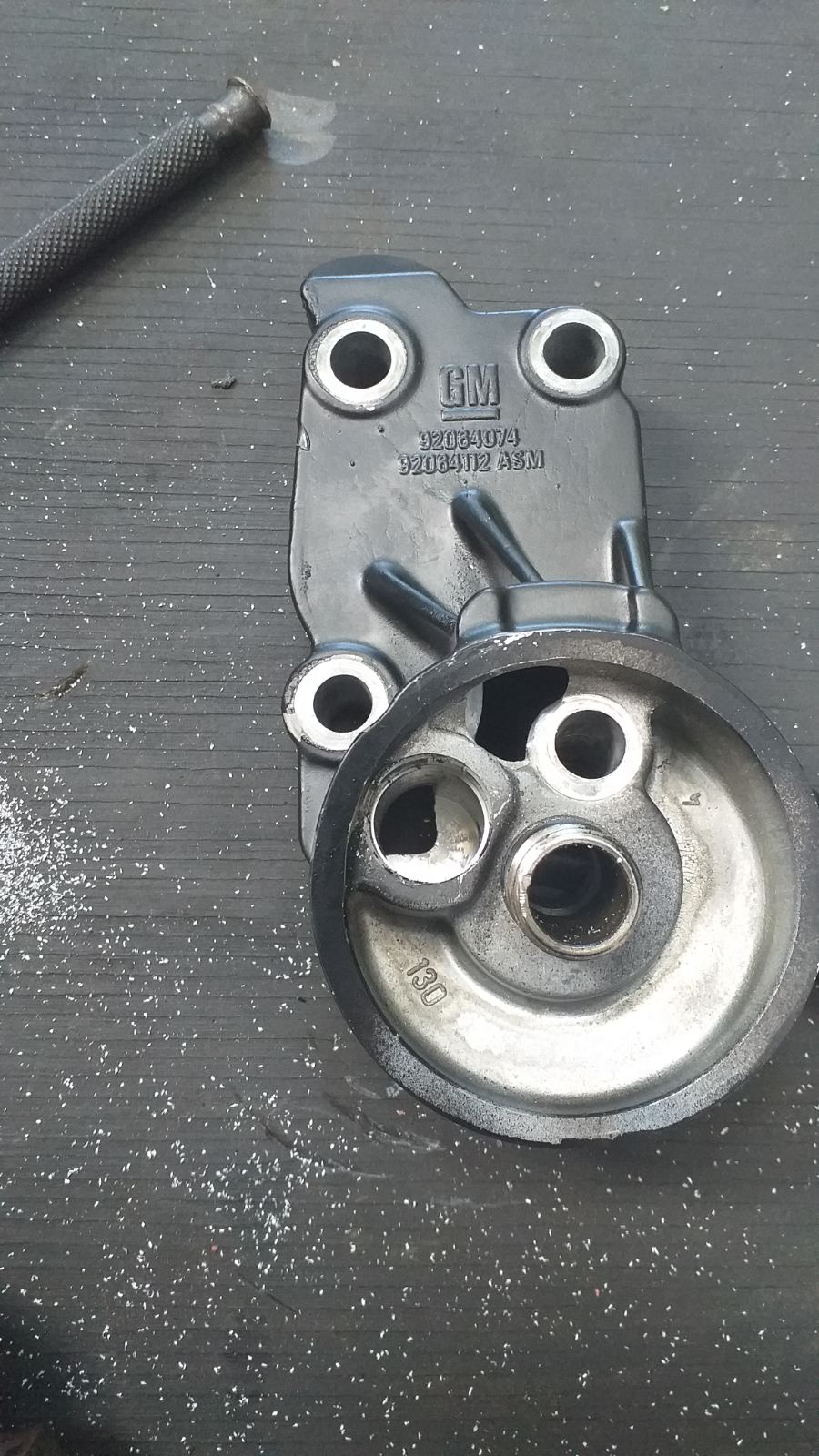

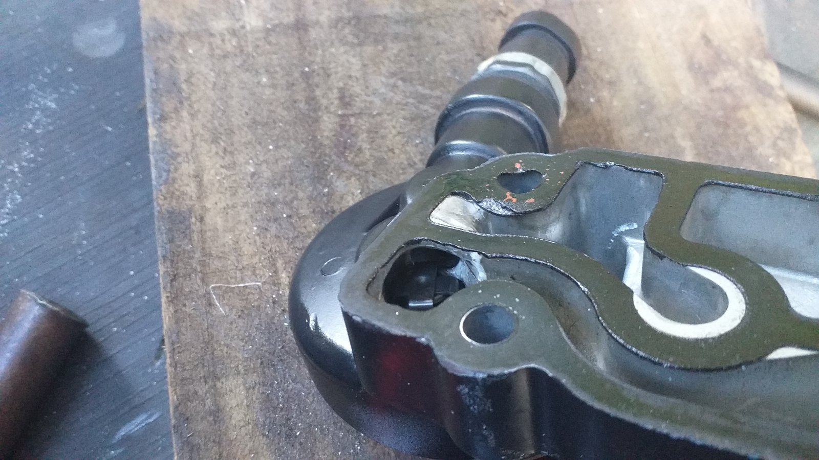

Then it's time to look at the oil filter extension housing. First the inlet side, more sharp edges and quiet narrow passages.
0-02-07-20ac02dcacd246cca70f1d2b80b749d1fae24d5c66d461c3b93af03da1f95549_a121b87f003b5705.jpg
0-02-07-b77c39cb0a9616526eb3b20d4fe7cc12513f74d0ad5393961c1b980f9dd44ae4_4bef01b96fdd59f4.jpg

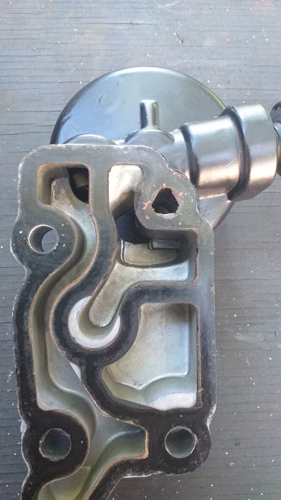

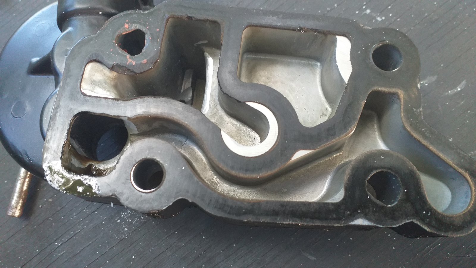

And you can see the restriction on the return side around the oil filter differential pressure bypass valve. Knock out the valve.
0-02-07-2505384f5e7542b7ad62737ce30ceea5d387de7e9d37023c27ac2f8ef714ce13_82458a1fc54bcc72.jpg
And it's time to start grinding.
Posts: 3823
cars: VS,VT,VX,VE
Re: Project Rescue
Opened up nicely on the return side.
0-02-07-971d9ddf7b2bca65a277ddd1644b702d4875ea27b8ff5bd0b50e28c35ea43c71_c4f05bdd3ca74994.jpg
0-02-07-50cf073f163d03805bdd9bc9b6404c5055eb897ddda57945ef9975130e6375a6_47c122f468971a67.jpg
And the inlet side,
0-02-07-5f149a1d96a5f0f77f7ca836352c9e4e0f7fb45d58eab7bab6856c7829678586_d6f3af51daf9d3f3.jpg
Then it was time to blow it out, give it a quick wash and re-assemble.

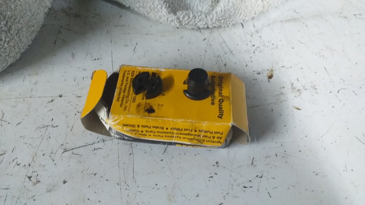

Finally arrived, just as the weather turns to shit an I'm back on shift for my long week.
0-02-07-315380a553b1c63926b5c845ebde21627ec63c33e9bd167d4a61adba927c4301_85db56145e071cde.jpg
It's not quiet the right one. This one has a slightly thinner base but it fits into the cam gear fine and I'll just make up a little packer to go between it and the balance shaft gear. It probably doesn't need it because if you were to run a double row chain then there is nothing in behind it to hold it.
