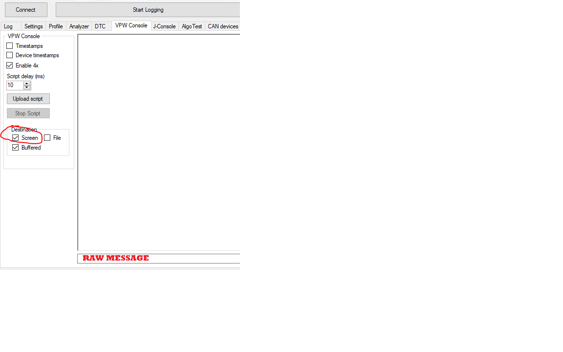

If I understand your question, you should use tab "VPW Console":radrace19 wrote:I was hesitant to post in this thread.
I tried messing around with the logger analyzer section and I couldn't figure out how to inject raw messages back into the bus.
I have an official MDI, but i'm struggling to figure out the universal patcher logger section where I can inject my data to see the response.
Do you happen to have any more information typed up on how to use it?
-Greg
- Enable Destination -> Screen
- Enter raw messages to single row textbox and hit enter
- up-vpw-console.png (17.92 KiB) Viewed 10401 times

So use the VPW console and not the J-Console? Maybe that is where I was struggling. I was thinking the VPW was for the older messages.
Ahhh I see in my post I forgot to mention I have the raw CANbus message I want to inject.

On the settings tab in logger->select device->set protocol to can->set module id if not pcm->connect
Goto vpw console->start sending data
This method uses iso156765 formatting to messages and set some filters, so you can only query the module you set at initial connection.
There is also automated script system that can be used to send multiple messages and wait for predefined response count.
To broadcast raw unformatted messages you need to use the j-console.
You can load custom presets with load button or to connect raw can->protocol to CAN->baud to 500000->connect
Use buffered checkbox to make sending commands usable.
The idle bus messages is extremely fast so don`t expect to see anything on the log, it is also preferred to log to file if using slower PC.
With mdi you can modify the timing setting to optimum.
Settings tab->timeouts -use these
