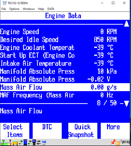

Yep I understand, I think I have managed to get past it.. basically when its asking to do CANbus, Im making it return back an invalid parameter... and it seems to skip and move on back to VPW.
With that said.. we are now reading live data!!

Just a quick video showing tech2win working. It seems to load live data so much faster then the dear old MDI, I use to think it was just tech2win being slow, but it appears to be heavily reliant on the DPDU DLL processing speed.
Only thing left is to test with more VPW modules connected, or in an actual car!
Theres quite a few hours of development to put into this to clean up some coding, and finish off other routines including those used to close/shutdown tech2win.
Ontop of that is making an installer to add the DPDU DLL plus register it into the Windows directory (C:\Program Files (x86)\D-PDU API) so that it can be found by Tech2win.
The D-PDU implementation is also specifically targeting GMs tech2win only. I say this simply because of how tedious this API is, and its been specifically designed only around with tech2win to meet its specific requests and requirements. I know theres a couple other dealership softwares out there which support DPDU api including Chrysler, but those will need to be looked at on another rainy day.
Once the J2534 and D-PDU APIs are released, can finally move back to the OBDX GT to add a few new commands to make J2534/D-PDU implementation easier for ALDL/CANBus, along with finishing off the GT's reference manual documentation.
