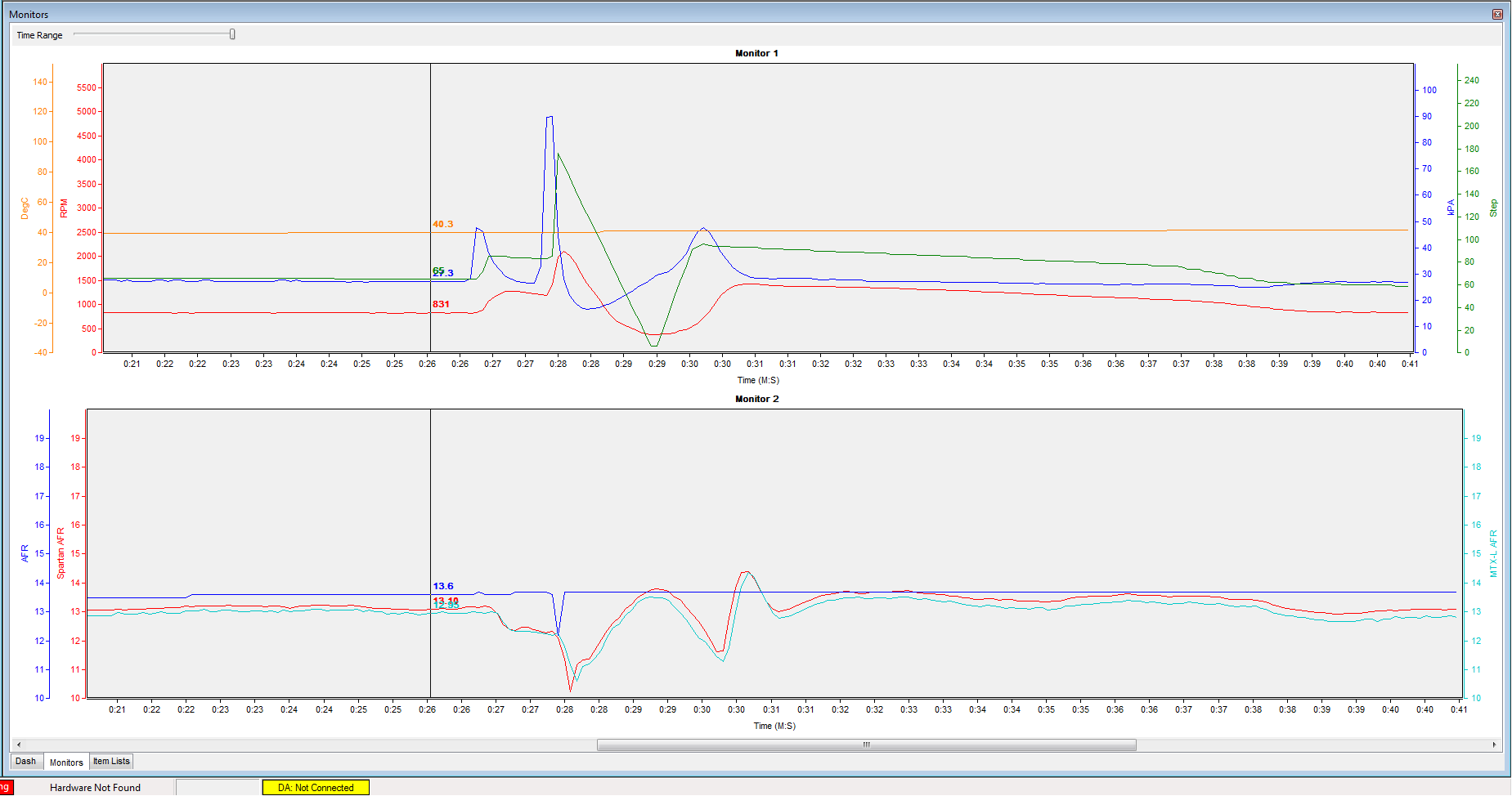

So after a bit of experimenting have come to the conclusion that the MTX-L works .... sort of.
I have two MTX-L units, both had readings all over the place with the sensors supplied by Innovate - one sensor has about 40k kms on it and the other maybe 2k kms. Using either sensor, on either MTX-L and the readings are not usable at all.
So got the 14point7 spartan installed, which came with a new sensor. Ran the new sensor on the MTX-L in my daily and all is ok, perfectly stable AFRs. So would think it was just faulty or old sensors right? Well the two sensors that play up on both MTX-Ls work perfectly fine on the spartan and LM1.
So my only conclusion is some difference in how Innovate are measuring AFR on the early LM1 and later MTX-L. They do control the sensor differently to everyone else, including how Bosch recommend. The 14point7 units use a different method again.
Here is a log and ADX comparing the spartan and MTX-L. Both now have new sensors, with both sensors installed in the same bank about 10cm from each other. Will get a driving log later and also hook up the LM1 for a shootout! I dont have three exhaust bungs in each bank though.

the thread I linked previously has a bit of discussion about how the Innovate and others measure lambda and drive the heater. Also the techedge website has lots of good info about how the sensor is driven, controlled and measured.

I like the idea of a gauge, and one that is not using an analog signal to get an AFR reading is even better (no problems with ground offsets making it read incorrectly, although the 14point7 startup sequence makes for a good check each power on).
I wouldnt go as far as not recommending the MTX-L but would like a longer sensor life, or that it was able to use older sensors that other controllers have no problem with. Starting again and knowing this would try a couple of spartans and gauge unit. Wouldnt mind trying a wideband controller using the bosch CJ125 IC (http://www.bosch-semiconductors.de/medi ... t_Info.pdf), there are heaps using this solution.

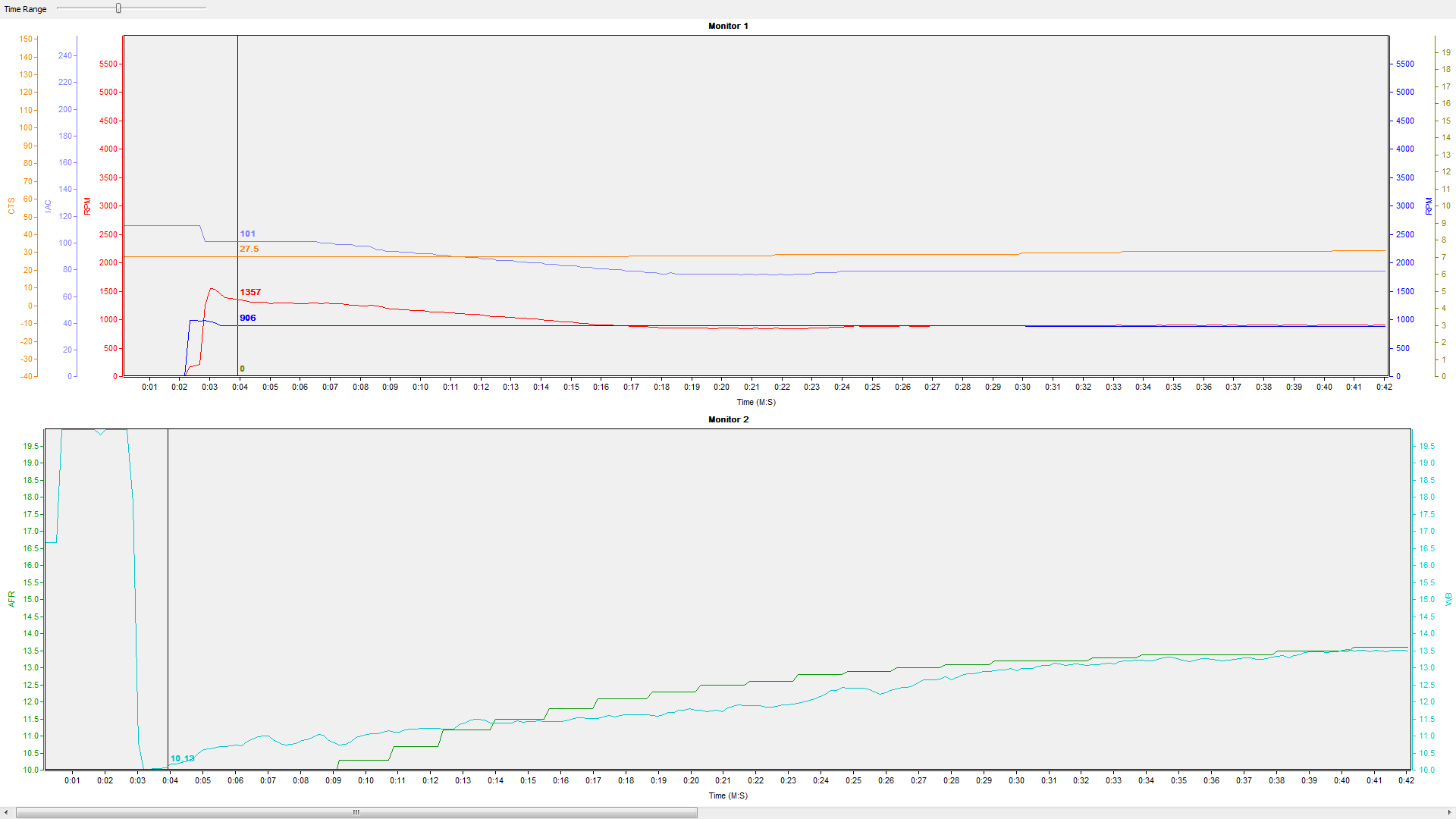

This is the spartan using my ancient and abused sensor. MTX-L still has the new sensor attached. The near stall was my fault, first start after the battery had been connected. As soon as it hit 2k RPM the IAC did its reset and pulled all the steps out! Anyway, an old sensor normally gets slow but this looks perfect still
Re: Toyota Powered VL Calais
Been playing around with the IAC settings to get the start just how I like it. Also due to the larger IAC ports compared to a Commodore all the warmup offsets needed a tweak along with a few other items to keep things happy in and out of gear and when coming to a stop while the engine is cold.
Pretty happy with this now, does not rev too high on the initial catch and has a nice decay to closed loop idle control. There is around a 40RPM increase as closed loop takes over so a couple more steps and should be just about spot on. And a video...
