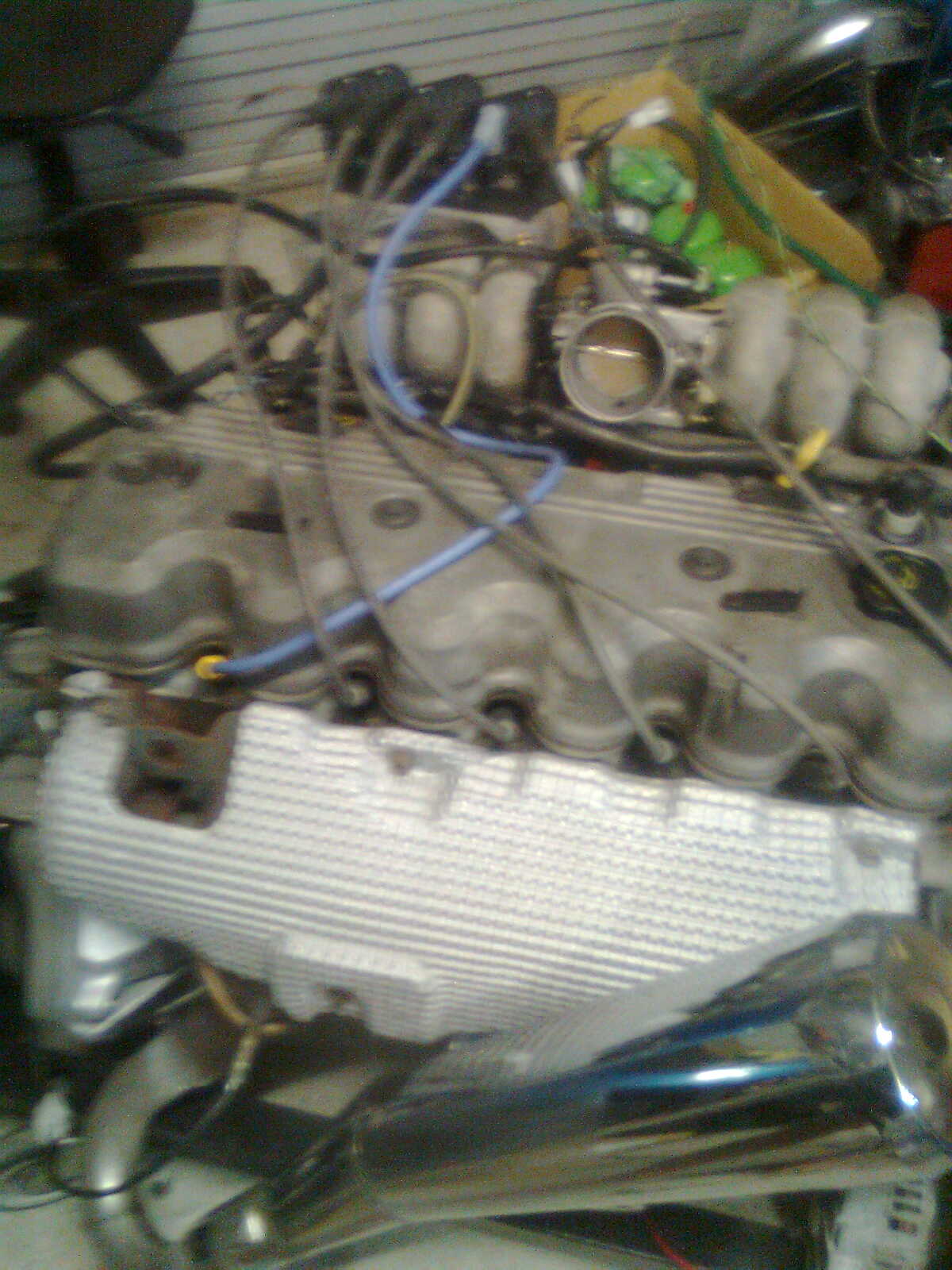

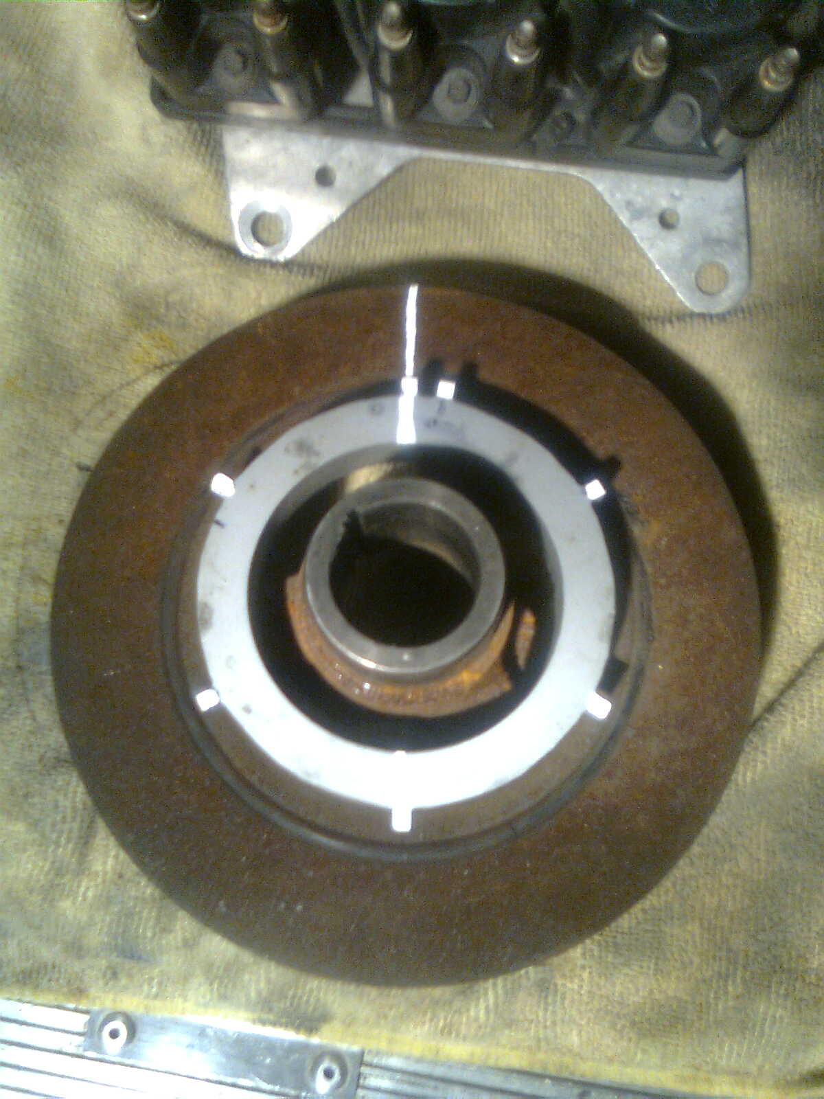

this works on a ford inline 6 with d1998a modded the reluctor ring but standard crank angle sensor running 12p ref angle is 60deg and coil order is 1.6 first coil 3.4 second coil 2.5 third coil

a pic of the test rig or a giggle too

nice, I like the tag approach instead of cutting notches.... you get less noise as the sensor is away from the main face of the ring
good work.
ive had lots of headaches having to have the reluctor mounted rock solid or get misfires, hopefully thats less of a problem with your setup.

the rpm trace is clean and and response is good so far will see how it goes when the engine goes into the car with large turbo hanging from the side
is for a budget drift car engine was $80 from ebay out of an AU2 car is a EA falcon that is having a big diet at the moment it is way to over weight with any luck will cause a stir at the track or explode spectacularly either way will be a laugh.

whats the toothed gear from ? it looks similar to the abs axle gears used on commodores ? although it looks like the teeth are longer .... I assume there is a spot on the back of the balancer you can attach it ?

it is the original 36/1 edis ring off the balancer they just tap off the back
