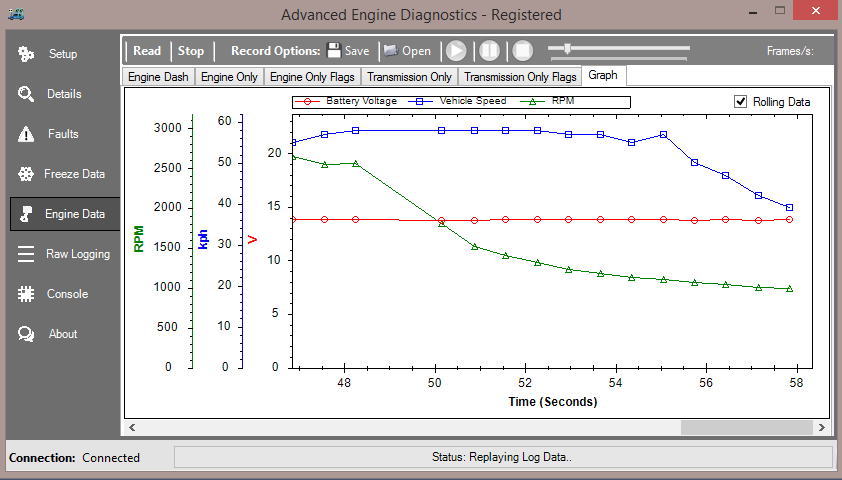

v0.0.0.4 Now available!
Changes include:
- adding 2more parameters to the graph.
- Fixed issue with VS S3 V8 (Engine data read and fault data)
- Error catches
- Reading is on separate thread to processing

Re: ALDL ECU's
The only thing left to do now, is add a little checkbox for "disable chatter" for the engine data reads. Hopefully thatll give a massive boost to the frames/s when needed.
And also an option to only record engine or transmission information
I dont mind it being a bit slower while cruising around, but be good to have the option available.

Not sure Im following on that?
Three new buttons will be add:
1- Disable vehicle comms to enhance frame/s (This is what Tunerpro does).
2- Log only Engine data
3- Log on Transmission data
I just got to add in some checks to the display updates and replay updates to check whether there is any data for trans/engine to process for each gauge.
Also finally. Iv had 1 report that the latest graphing causes a little error to occur after logging for a while and trying to "hover" over the points when "rolling data" has not been ticked. Iv actually recreated this error and I can semi repair this.
From now on, data points cannot be checked by hovering over unless logging has stopped, or the replay data has been paused/stopped.
Oh, and the entire window can now be expanded! I find this good for the graphing as it makes it large to check out!
New version out soon!
